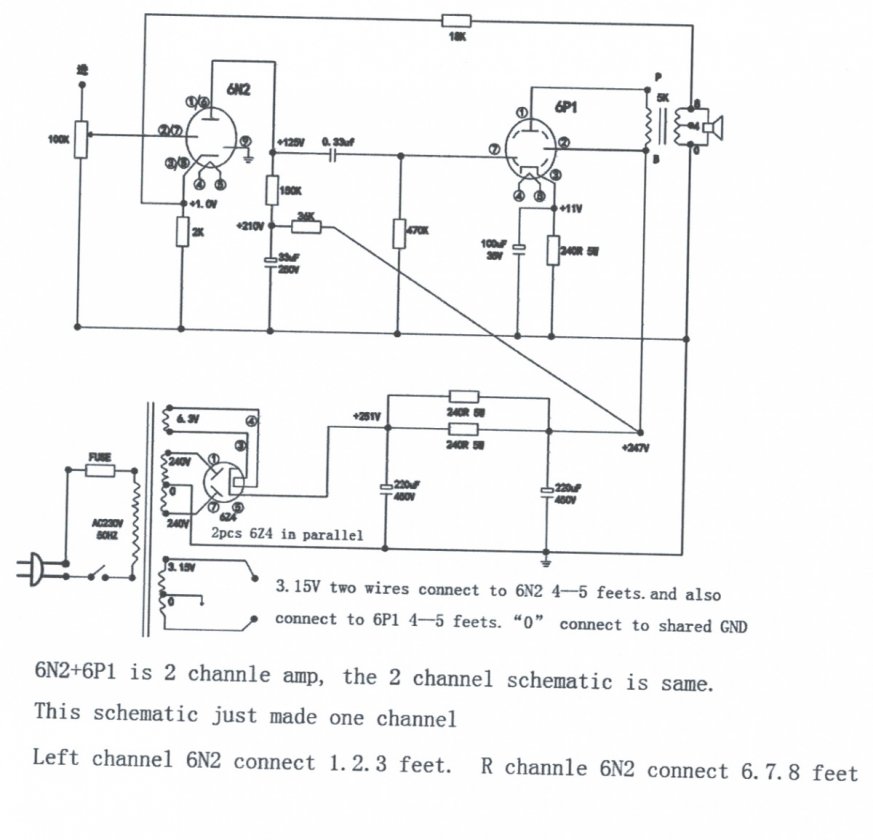

First off, mine are stenciled 6H2pi(pi symbol) not 6N2P. However, from all I can gather, the specs are identical on all these Russian 6N2/6H2 varieties. They were sold to me as 6N2P-EV/EB. Bottom line, both test fine even under operating conditions. Now here's where it gets interesting. My tube tech looked at both the Russian 6H2 and Chinese 6N2 and said "these aren't the same tubes just by looking the two pin bases." .... pin base wiring is completely different. Chinese 6N2 filament wiring at pins 1 and 9. Shield at pin 5. Russian 6H2 filament wiring at pins 4 and 5. Shield at 9." He said the only true equivalent of the Chinese 6N2 he could find is just another Chinese 6N2.

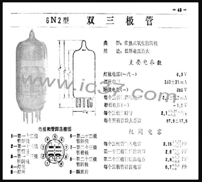

That's very strange.  From diagrams I found on Chinese 6N2 tubes, 4 and 5 are filament and 9 shield  :scratch:

« Reply #95 on: 5 Mar 2025, 01:30 am »
And the photo of inside of our FU19/FM30 amp shows 6N2 pin 4 and 5 (yellow wires) are filaments.  I guess I will find out when my Russian 6N2P tubes show up.  If bored, you might want to look inside your FU29 amp and see if pin 4 and 5 are wired as filaments?

« Reply #96 on: 5 Mar 2025, 02:31 am »
Well, if that's the case I would think the Russian variants would work fine for you in the 19. As that fits my tech's observation of the Russian tube. (pins 4 and 5 filament)
This leads me to believe the 29 is a different animal as my Chinese 6N2 works perfectly with pins 1 and 9 filament, pin 5 shield.
