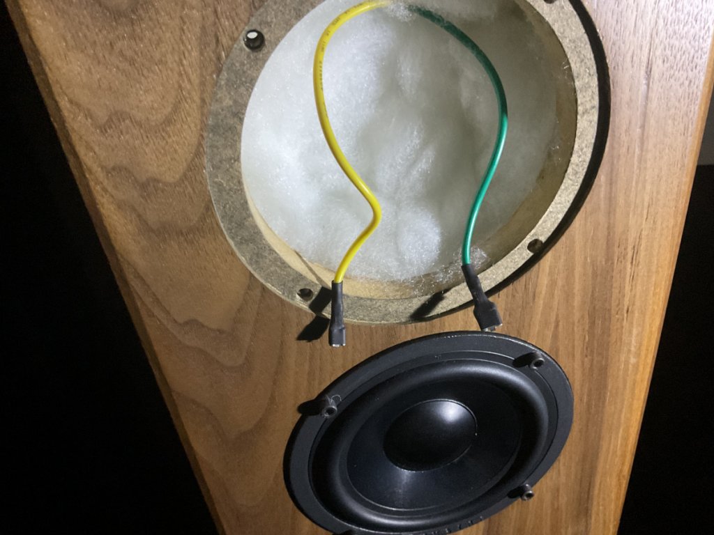

Was listening to some tracks the other day and something sounded off.
Put my ear up to each driver and also my hand to feel any movement.
The one side all drivers and tweets are good and the other side all good except the pair of mids(no sound).
I even swapped the good mid drivers from the other speaker to which I thought were blown-and same thing(no sound).
These speakers were demos from a dealer so have had them maybe 8 months(20yr warranty.
When I swapped one of the mid drivers for one of the ones I thought were blown I noticed some of the clips that secure to the terminals were very loose and some are quite snug.
Loose as in it slid off with no effort and could move it up and down.(very sloppy connection.
I wonder if a loose connection like that could harm or ruin the mid crossover section.
These were a store demo and discontinued.
Here a pict of the clip

Forgot to add say that installing the mids that worked to the other speaker was the same no sound,so figure it might be the crossover.

What speakers are these?  The Revel 50A?
He's posting in the Bryston circle because his system almost entirely Bryston.
You should go through the wiring in those speakers to get rid of those POS push-on connectors and solder every connection.  My .02.

Main Q was basically if such loose connectors could cause the mid crossover section to fail.
Vibrations ect.
I do not know why those connections would be loose unless someone fiddled with them  They are 'gas fit' connectors and are better than soldering.

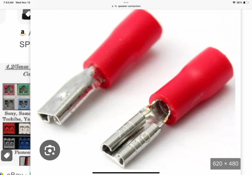

Ohhh I’m sorry they have a rubber coating on the outside,
ITS STILL the Same FKN CLIP.

Seems there is some mystery going on here.  If the connectors were originally gas tight (per James) then you should not have been able to disconnect them nor would they fall off.  But what you found would definitely cause a loss of signal.  However, what you have described does not sound like any component in the crossover has failed.  You may find loose connections there too (re my rec to check wiring).
Still, the mystery is not revealed.  Speculation: The speakers, used as demos, may have been subjected to abuse during their time on the showroom floor.  The dealer may have "refreshed" them for sale.  This would explain the loose connectors.  The OP might  contact Bryston directly and send them his serial numbers as corporate may have record of replacement drivers being sent out.

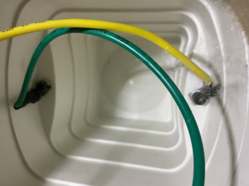

drummermitchell
Re: No midrange/loose connection
« Reply #10 on: 30 Nov 2024, 07:08 pm »
And another of inside cavity
av
drummermitchell
« Reply #11 on: 30 Nov 2024, 07:11 pm »
The FEMALE Connection just slides off with NO RESISTANCE Whatsoever.
