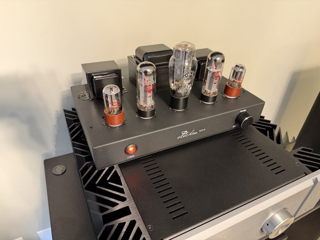

Found one hell of a tube amp deal on Amazon for $300. Oldchen EL34 single ended amp. 10 watts per channel, all point to point wiring with pretty decent parts inside. Sounds really good. Will definitely be upgrading the caps in this thing.

Only have a couple hours through it but right now, stock, it’s the best sub $1000 amp I’ve heard. I’m a little scarred to compare it to my ANK EL34. This one is pretty shocking. Not sure how it will act with other speakers, but it drives the NX-bravo towers perfectly.

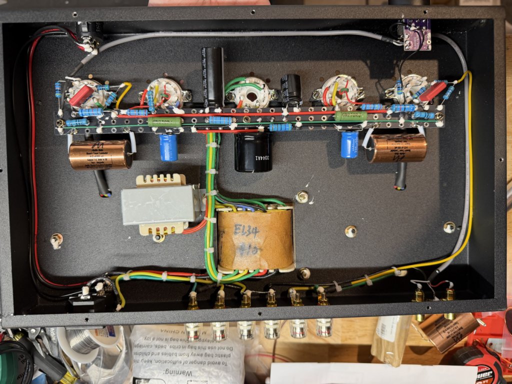

It has a slight hum but I have to put my ear right up to the woofer to hear it. I only have about 15 hours through it as of this post and it’s started opening up a lot. I decided to start swapping some tubes to see. Swapped the stock driver tubes for a pair of PSvane horizon 6sn7 and the clarity improvement was immediate. Just remember that EL34 tubes deliver a very different sound than 300b tubes. That’s the first thing you will notice. I’m going to opening it up today and check out the coupling caps, whatever is in it is not too bad. I happen to have a pair of Audionote copper foils that came out of my ANK Dac that I may put in.

I think the coupling caps are .47uf. I have a pair of .47uf Auricaps in my parts bin. I don’t see much talk about those anymore. Probably better than what’s in there now. Also if I keep the amp, I might change the wiring layout, possibly replace or bypass the cheesy volume pot.

I swapped out the stock .47 caps for .22 Audionote copper foils. This is working out very well. What great sounding little amp. Just need to finish break in, swap the stock EL34s and eventually figure out the slight hum whe the volume pot is all the way up.

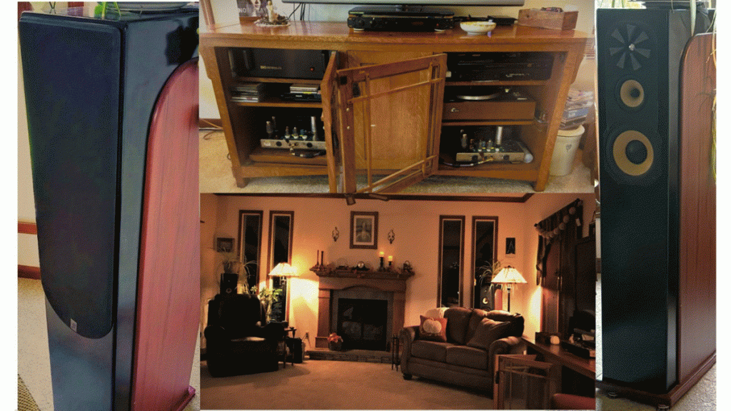

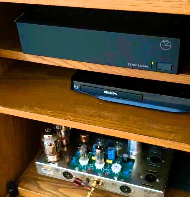

I'm late to the party on an old thread, but since you resurrected it I thought I'd share.  I had been doing vertical bi-amping with a pair of modified Dynaco 70s with the VTA boards for a couple of years and it was very good.  In 2023 I switched to a horizontal bi-amp setup, and added a solid state amp to the woofers....ultimately I ended up bypassing the passive low pass crossover, and adding an active low pass crossover in it's place.  Then later added an inline high pass filter to the tube amps with a silver mica cap to relieve them of bass duty below 60hz.
Things improved on multiple levels with those changes.  The solid state amp (now a Linn LK140) does a much better job on the bottom octaves than the smallish tube amp did, so bass has better extension, and more impact and control.  The switch to a horizontal configuration also presented the tube amps with an easier to drive 8 ohm load vs 4 ohm, which added some unexpected clarity...filtering the low bass bass from the tubes brought even more clarity.  I can tweak the low pass crossover points, and the volume balance between the solid state and tube amps.  Other changes and tweaks have been applied over time, but overall it's been a very positive improvement with a best of both worlds scenario.
