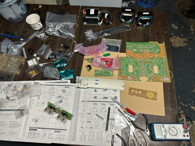

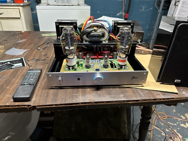

Bunch of parts
Finished, testing and playing music. I purchased Audyn true copper caps to replace the stock ones.

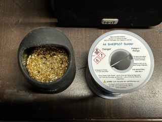

The kit was a piece of cake to assemble.
Used some good Kester solder and keeping the solder gun tip clean made for easy and excellent solder joints.

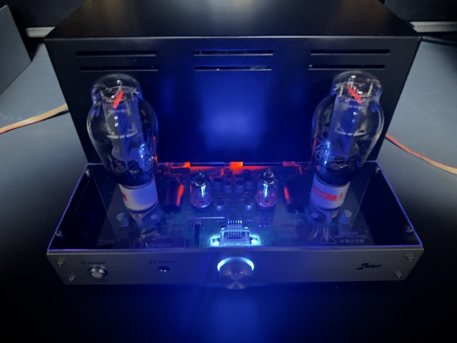

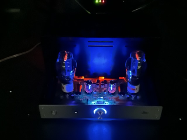

Looks cool in the dark with the cover off.I noticed those 300b tubes don’t glow like others I owned. Only a little at the top.

I made a cover with a cutout so I can easily change the feedback jumper socket.
