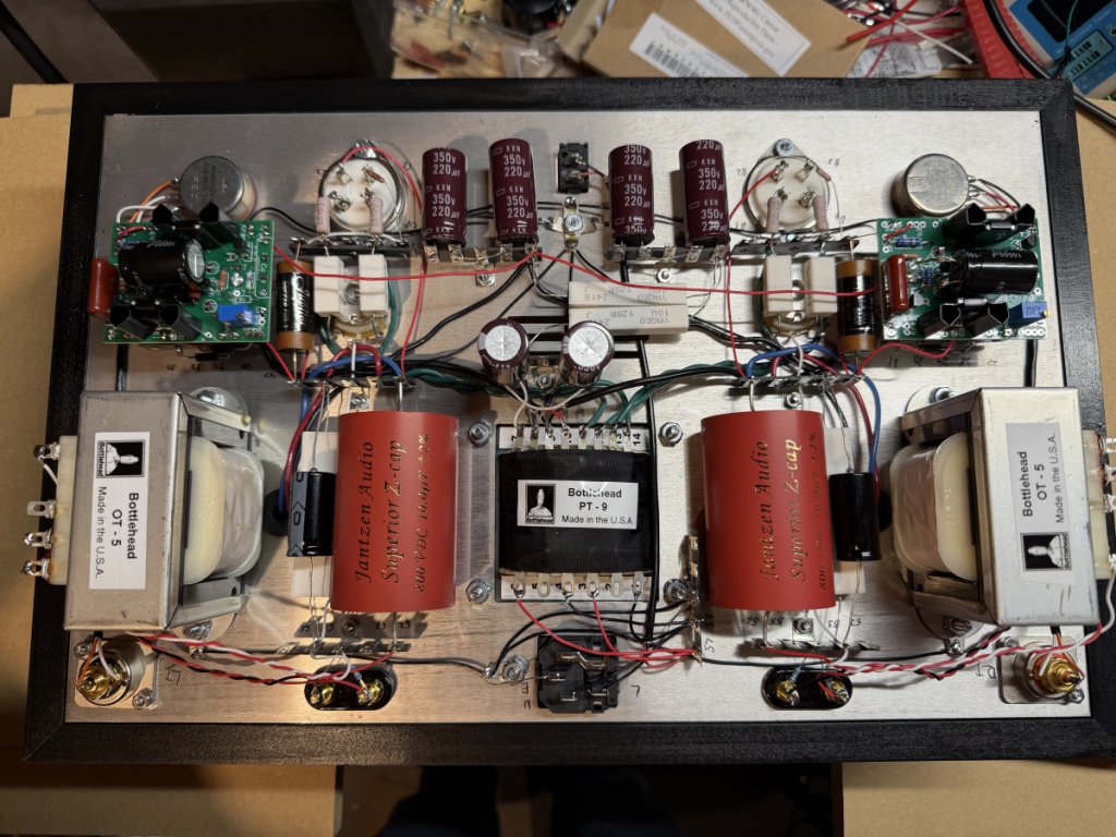

Inside.
Jupiter copper foil for coupling and Jantzen for parallel feed is very nice :thumb:
Bottlehead says speakers <96dB sensitive should be fine with AC heaters, but I guess not?
mkrawcz
  • Posts: 722
Re: Tube amp for mid/high SS for bass
« Reply #102 on: 7 Apr 2026, 06:23 pm »
It’s not bad with 91db speakers. Have to get very close to hear it. I do have a separate issue with a loud mechanical transformer buzz that I will try to remedy with a DC filter. If that doesn’t work, I will need to replace it.

So I added the DC filament heater upgrade to the Kaiju 300b and also added Duelund JDM tinned copper bypass caps to the 10uf Jantzen superior Zcaps. Now that I have over 100 hrs through this amp, it’s the best amp I ever had. It’s perfect.

So the folkfore about how DC heaters sound less "musical" than AC heaters is nah..?
mkrawcz
  • Posts: 722
« Reply #111 on: 16 Apr 2026, 05:46 pm »
Hard to say without listening back to back. One thing for certain is the speaker hum is gone.
