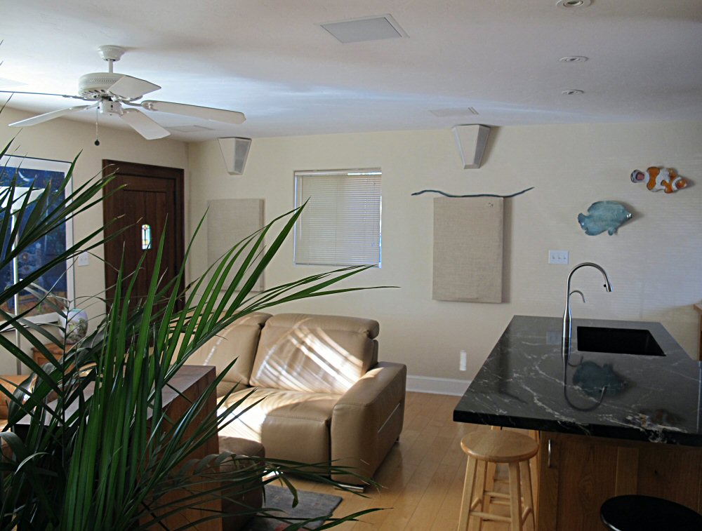

Installing in-wall speakers is easy but dusty. The trick is to have the right tools, drywall mud and matching paint.
The ceiling speakers can be used for Dolby Atmos, most surround receivers will do Atmos but may only have internal amps for the surround and rear channels, the Atmos channels will then require a stand alone amp. The surround speakers should be at the same height as the main L&R speakers and placed on each side of the seating area. There are plenty of surround speaker placement guides on the internet, use what works best for your room, I broke a lot of "rules" with my setup and it sounds fine.
I used 200' of Monoprice 14 AWG CL2 rated speaker wire for my 7.1.4 home theater. Buy a roll, it always takes twice as much wire than you think.
https://www.monoprice.com/product?p_id=2820&srsltid=AfmBOoqekskdPNIMzhKXse2VygUFll8bb3dsMt2ZkJSfml4elm7jZblF
I cut speaker and access holes with a oscillating multi-tool. The circular blade easily cuts drywall splitting the pencil line. I cut access holes in the ceiling with the multi-tool to run wires. When the job is finished, the cut out piece was glued back in with drywall mud, patched and painted. Fishing wires above the ceiling joists was achieved using 5/8" PEX tubing. The tubing is flexible enough to bend through access holes and stiff enough to span 8' or more to the next access hole.
More installation info: https://www.audiocircle.com/index.php?topic=163696.msg1762772#msg1762772
