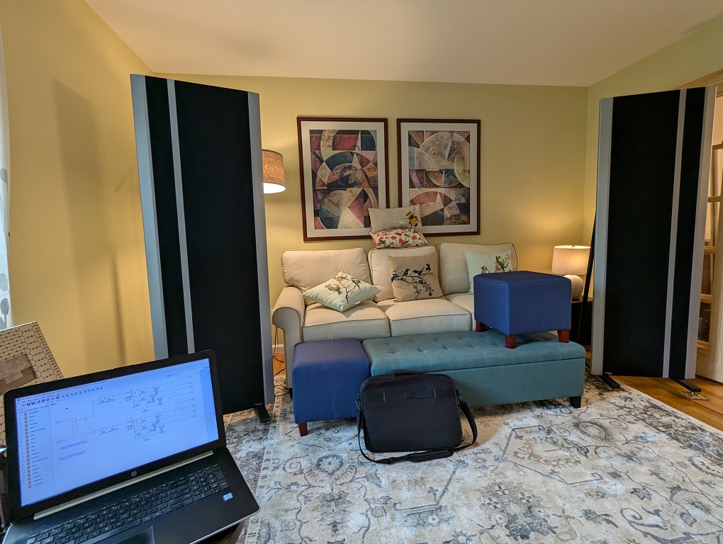

Had a customer request to demo a dspNexus system with his new to him Magnepan 3.7 speakers.  He has ported powered subs behind them to integrate.  This uses the existing passive crossover in the 3.7's and turned the subs crossover point as high as possible to use the new DSP crossover in the dspNexus.
The connections to the amps and subs were RCA, so I brought some adapter cables I built to go from XLR to RCA for the system use.
Setup a crossover between the 3.7's and subs and added time delay to the main speakers to time align them with the subs.  Set the sub levels and the system is playing music.  The system sounds very good, but hear where improvements can be made.
The customer wants to measure his room, so he is getting a measurement mic, stand and XLR cable to run REW to calculate the parametric EQ's needed to flatten the room response.

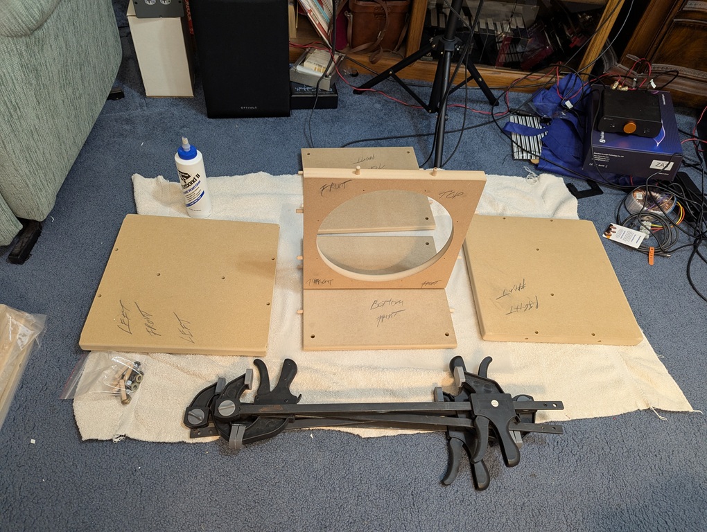

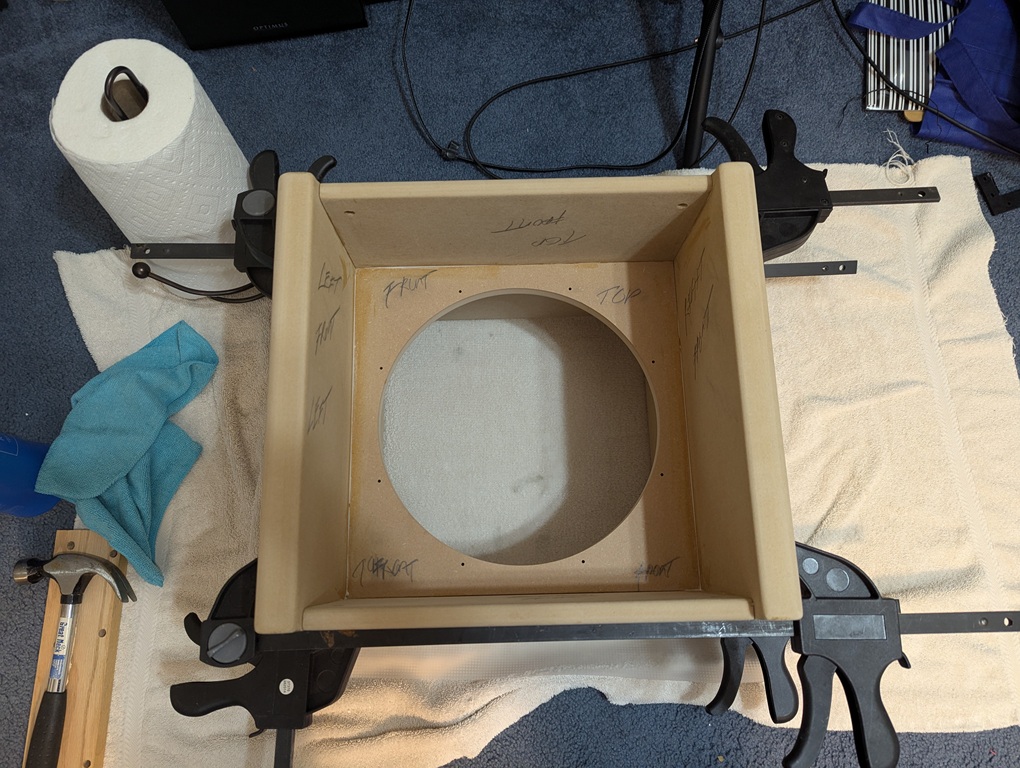

« Reply #3 on: 17 Feb 2025, 10:05 pm »
Got new clamps and glue today and module #1 is assembled, clamped and glue drying.

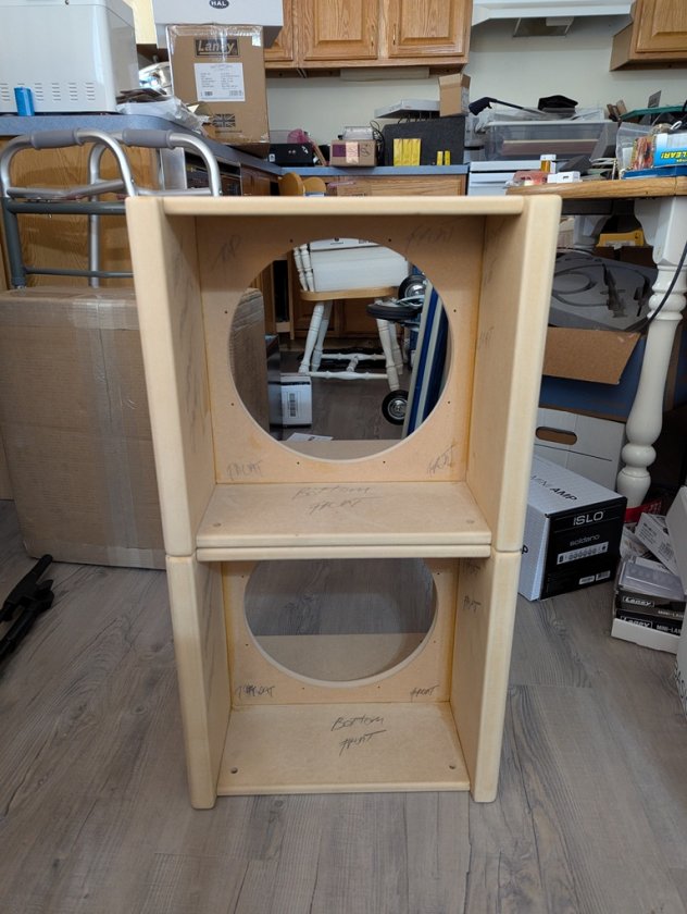

« Reply #4 on: 18 Feb 2025, 05:05 pm »
First pair of modular 1x12 OB cabinets ready for sub drivers.
The third module is glued and clamped once it dries, time to build the last cabinet for the second stack.

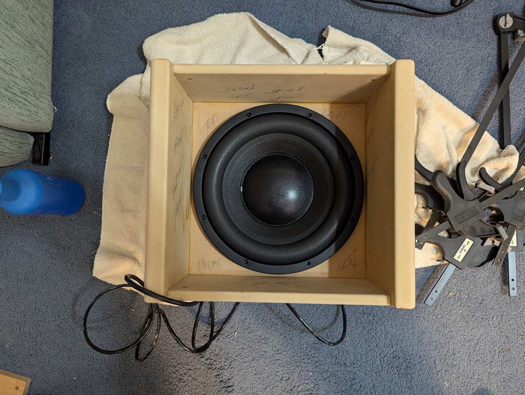

« Reply #5 on: 19 Feb 2025, 03:49 pm »
Started installing and wiring the GR-Research sub drivers in the modular 1x12 OB cabinets.
First module is complete.  Three more to do.

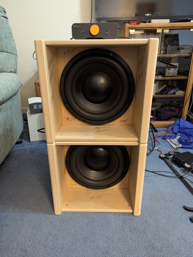

« Reply #6 on: 19 Feb 2025, 08:33 pm »
The first 2x12 OB modular sub stack is complete.
Time for some testing.

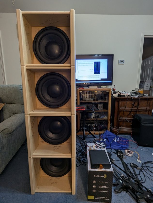

« Reply #7 on: 20 Feb 2025, 01:31 am »
The four stack of OB subs are complete and tested.
Next is box them up for travel to the customers system.

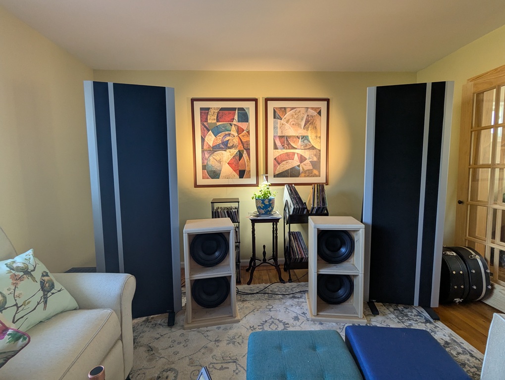

« Reply #9 on: 26 Feb 2025, 12:37 am »
The two modular 2x12 OB subs are now setup with his Magnepan 3.7 speakers.
The dspNexus 2/8 is doing the speaker correction and sub bass management and crossover for the system.
REW measurements are letting me do other correction after some processing.  Now I can send the file to the customer with mods for listening trials.
