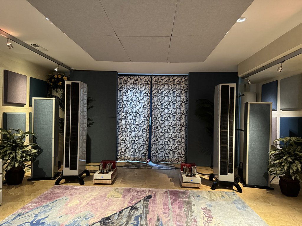

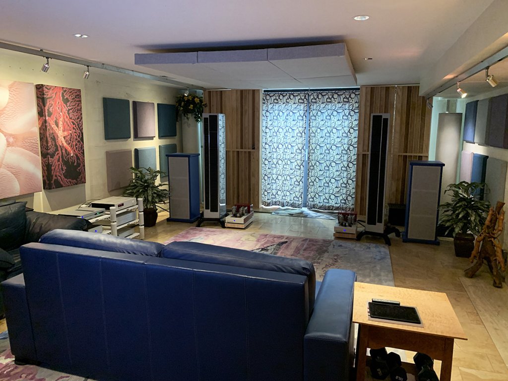

I used the GIK 6” absorber/diffuser panels on my front wall initially and was not happy with the results. I actually preferred the sound with no treatments behind the speakers better.
Then I tried quadratic residue diffusers from ATS and these were a big improvement. Really nice deep soundstage without sucking the life out of the music.
I wrapped the diffusers in Guilford of Maine fabric and they look quite nice. Here are a couple photos before and after wrapping with fabric.

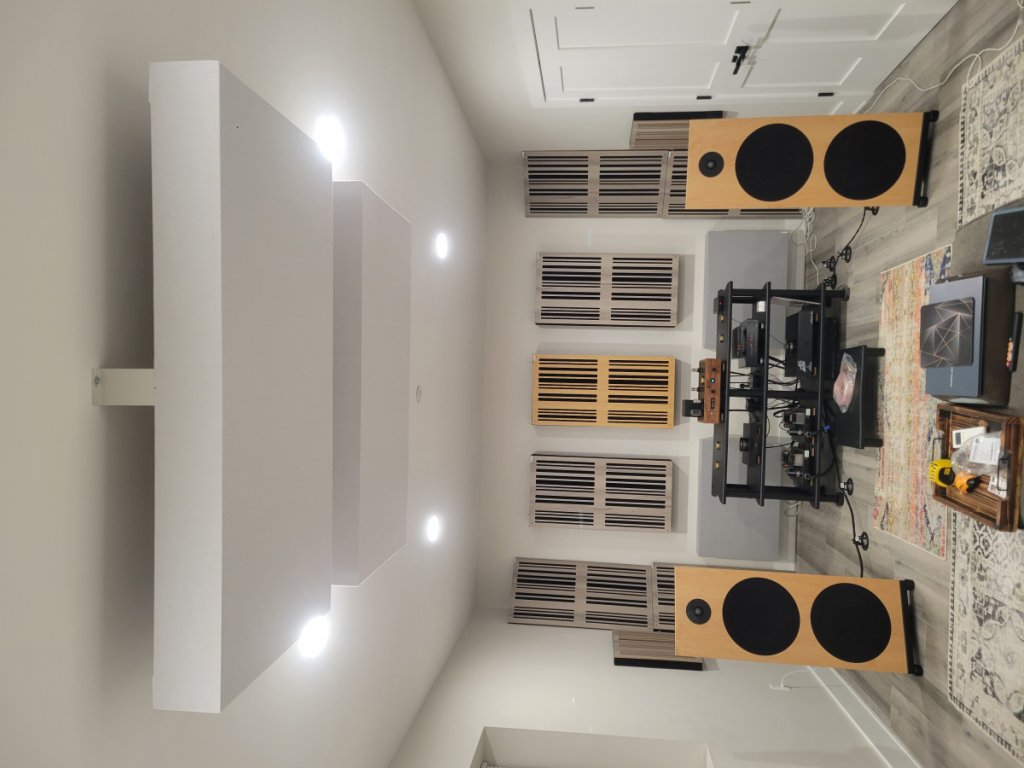

I got stuff all over the place, sometimes I rearrange it and see how I like it. This is my most recent experiment.
 Next I need to paint the floor.  :lol:
 The diffusers do nice things, IMO.
 This is my man cave, ladies think I’m nuts and it’s ugly, I don’t care though.

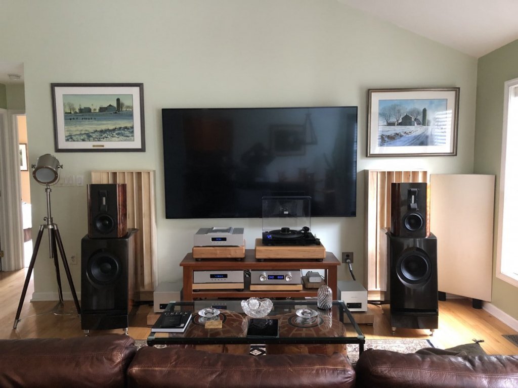

« Reply #5 on: 28 Sep 2024, 01:17 pm »
« Last Edit: 29 Sep 2024, 04:47 pm by Charles Xavier »
Glady86
  • Posts: 280
Re: Front Wall Treatment / GIK Acoustics 244 Bass Traps
« Reply #6 on: 28 Sep 2024, 01:28 pm »
See, it can be done to look nice too. I think the only thing I could do that would be a step up is move the tv out of the middle, but that’s not an option.
