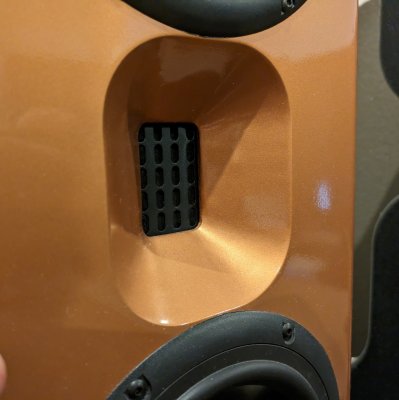

Standard:
Danny's NX-Tremes
Those much larger, puffy waveguides looked really interesting. Did they get discarded as a concept too quickly?
It was just an idea we wanted to try, but we don't really have a place for them

No, they are symmetrical but they are also a little different from the standard OB NX waveguides, the left/right edges were sanded down a bit extra on the edges
Standard:
Danny's NX-Tremes
Sanded down a bit extra on the edges... to try to make them a smoother waveguide that measures better?  I'm still trying to make sense of the geometry differences, and honestly find it hard to imagine that the angular waveguide used for the NX OB series is actually optimal given what the 3D printed version for the closed back version of the exact same tweeter looks like (and most other waveguides I've seen).  But maybe it is for some reason?

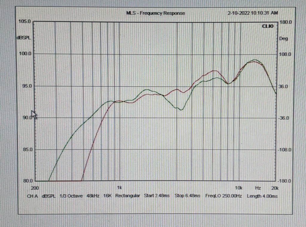

Red = back cup
Green = open backed
The standard NX waveguide doesn't have that ~2KHz dip that the NX-Bravo waveguide does. other waveguide prototypes were even more drastic in variance depending on the use of an open back or deep cup being used.

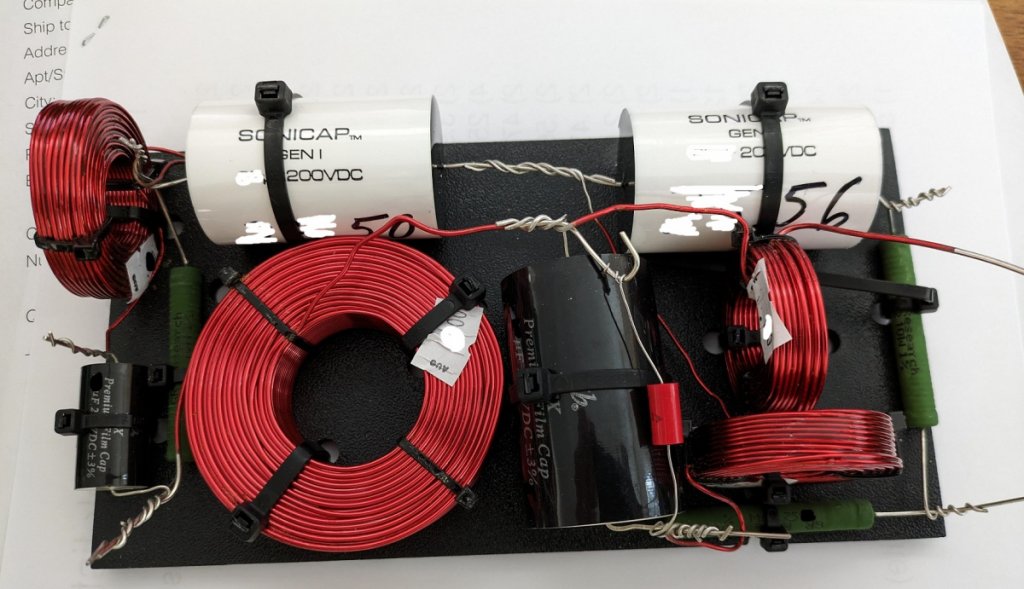

@hobbs I have a few questions on the NX-Bravo kit,  I didn't see any instructions or build guides written up so apologies if I missed them
1. are we supposed to build the crossovers on the small mdf boards included in the cabinet flatpack?
2. what is the overall process for this, do most people just hot-glue all crossover components the board first, then wire them up and solder?
3. what are the corner-brace looking things for? (there are only 4 per speaker) where exactly do they go? can they just be glued in while gluing up the box, or do these need to be screwed in with wood screws during or after the initial box glue/clamp up?

1. I'm not sure if the flatpack comes with a board or not, but you need one that is roughly 4.5" by 9" to really fit the crossover neatly & to get it to fit through the 4.75" woofer hole.
2. First it to lay everything out onto the board, cut your boards to size, mark your board for drilling holes, and drill the hole for you to use zip-ties to secure the parts to the board, then twist and solder everything together, then use hot glue to further secure the crossover to the board. You will also need some holes for mounting screws, or use 3M heavy duty double sided adhesive tape, just don't put any screws through the woofer coil.

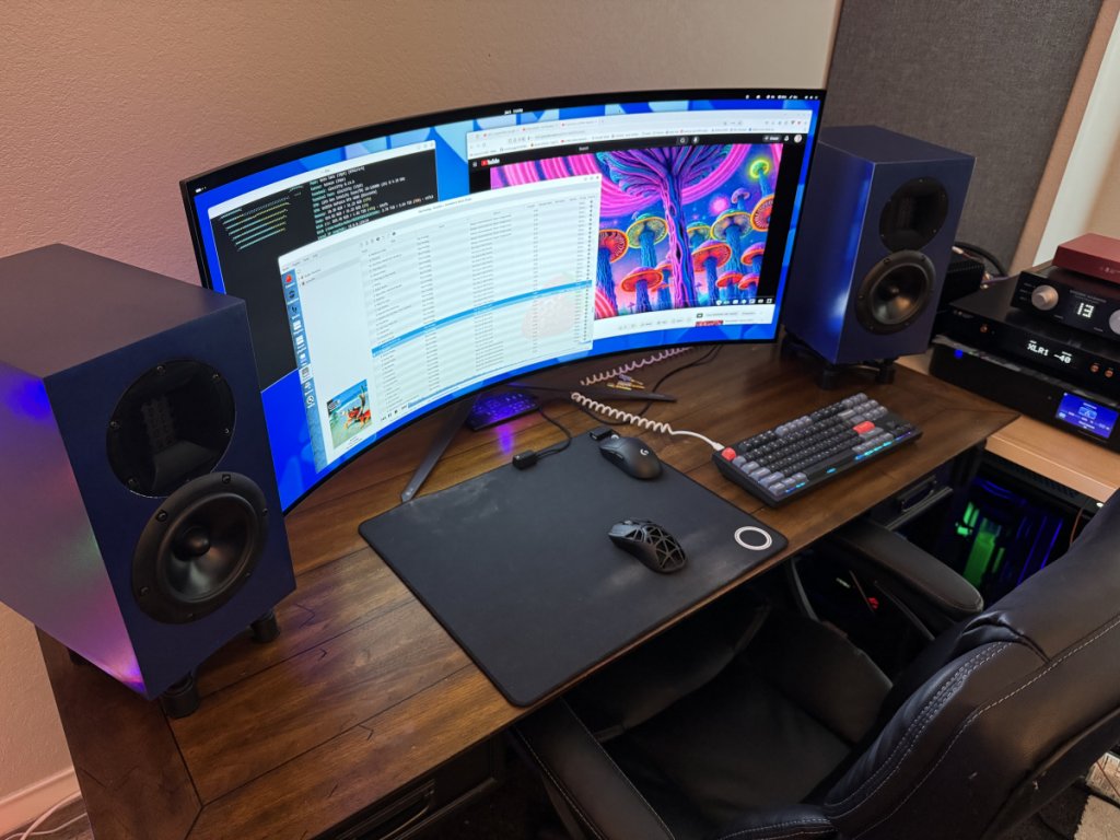

Thanks a ton for posting that crossover pic Hobbs, it would have taken me waaaaay longer to figure out how to lay it out if you hadn't
I finally got them together, currently testing with a Holo Red -> modded PS Audio Directstream -> Holo Serene KTE -> monoblock AHB2's, and it sounds pretty good!

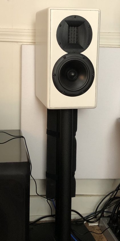

It's taken awhile to complete, but here's what I've got..  Crossovers are external, mounted to the back of my Sanus stands.  Went a different route with the internal bracing.  Side panels damped similar to what they do on the PS Audio FR5, and includes a support from the rear panel to the M130 back plate.  Sorbothane at all contact points.  You can see my Rythmik servo sub hiding there, so these stand mount speakers only play 80 and up.
Peter J
