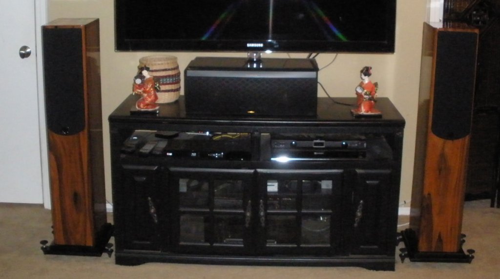

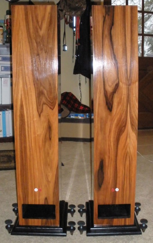

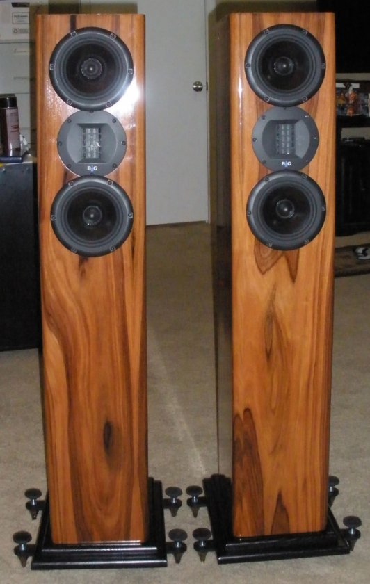

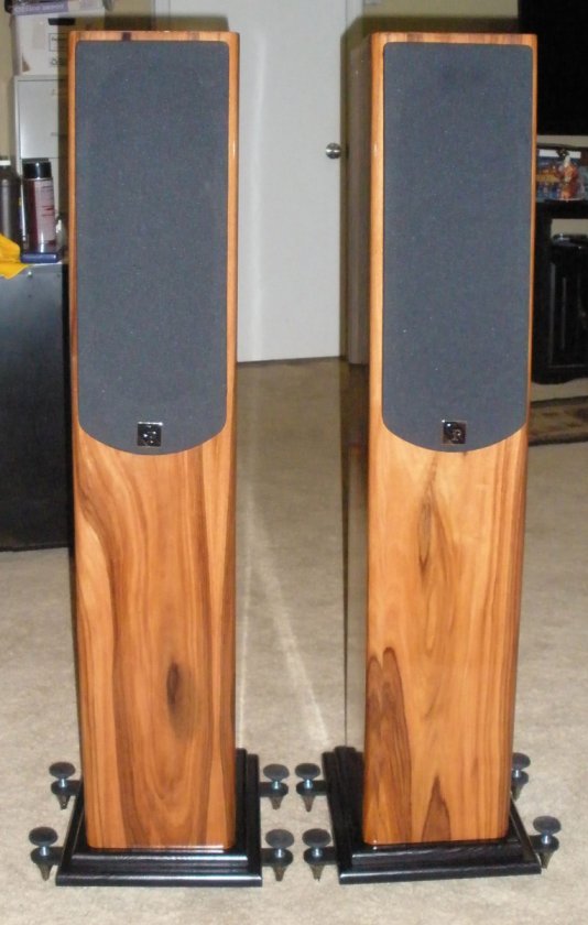

Hobbs said the idea was to revive the N3 line to which I wholeheartedly agree. The N1-X was the second speaker I built back in 2012 and the N3 the third in 2013. The N1-Xs are fabulous little speakers, still have them and they are currently playing in my second system. However, the N3s are in my living room system, get played every day, and are still my favorite box speakers.

Mike, those are some nice lookin' speakers.  Well done.

Thanks. Going on 12 years old and they still look and sound as good as new, after break in of course. Shellac has turned out to be a lot more resilient of a finish than I thought it would be. Which is great considering how much time that French Polish finish took.
