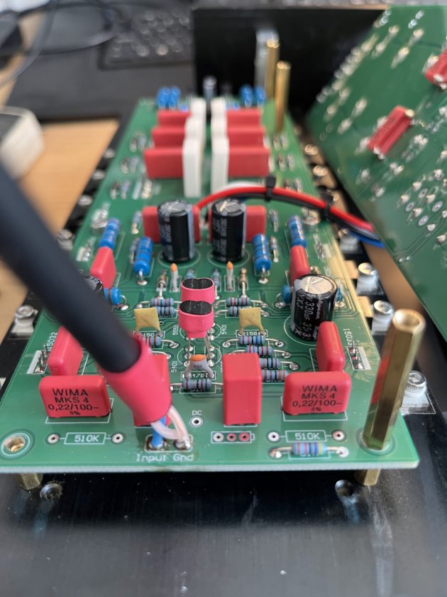

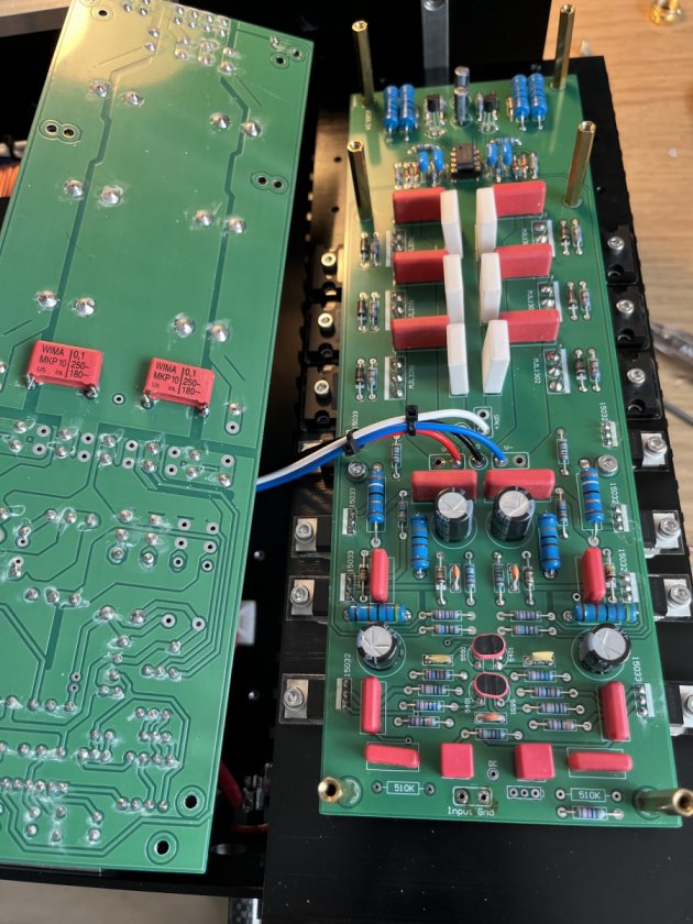

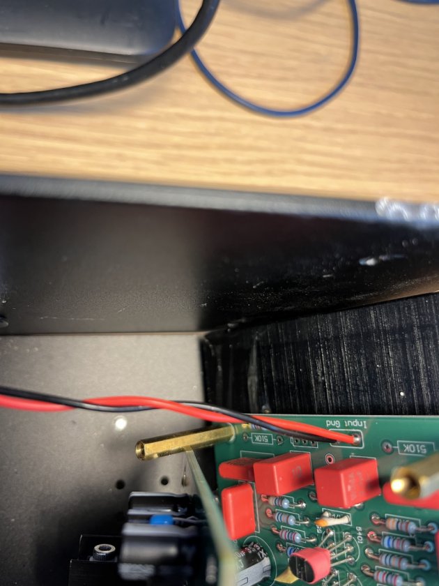

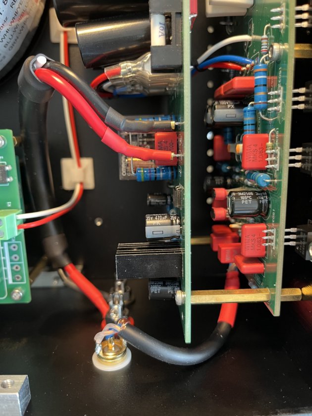

I replaced the speakerposts as well on my Dartzeel (transaudio) NHB108 clone, and added some bypass caps. Also took a look at how to replace the RCA cabling, but was not sure how to proceed. How did you do this? Did you remove the top board and desoldered the RCA from the top? Or did you remove the bottom board as well  and disconnect it from the cooling ribs? My board and RCA cable is shown in the picture.

To answer my own question: it was not that hard to do. I removed the cooling fins and disconnected the top board from the stack. This gives room to the input cables from above. I was able to remove these cables, since there is also a solder pad on the top. I removed the solder and resoldered some mogami cable (with shielding). I have the shielding floating at the board side. See pictures for some detail photos for those that might be interested.

Nice job! Sorry I missed your post until now.
