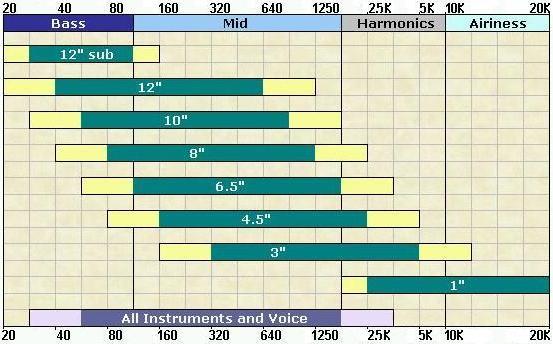

This empirical table may give you some idea on the cone voices.
Thanks for sharing this
