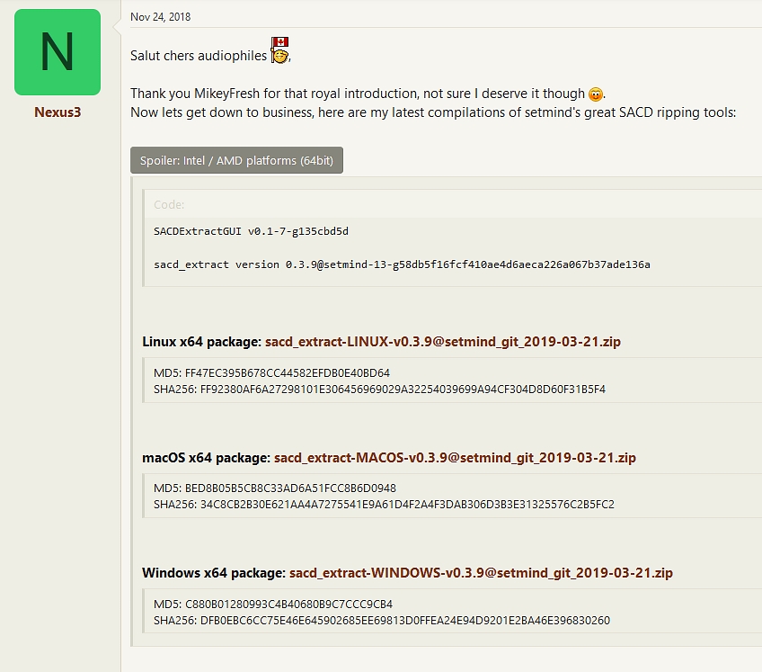

Have you followed the directions at Hi Fi Haven?
https://hifihaven.org/index.php?threads/rip-sacd-with-a-blu-ray-player.3652/page-2
You need 5 things:
1) A thumbdrive formatted to FAT32
2) AutoScript for the Sony BPS5100
3) The latest Java Runtime (JRE)
4) SACDExtractGUI  https://hifihaven.org/index.php?threads/rip-sacd-with-a-blu-ray-player.3652/page-15#post-81498
5) The IP address of the Sony

Thank you for replying.  I have all of the components.  I am struggling with the IP side and I have a friend who is going to assist today.  The Blu Ray seems to be operating correctly.  If I insert the USB, the try opens and then I turn off the machine.  I’ll tackle the IP side and report back -

Got things working.  I needed to adjust the Blu Ray to a wired connection.  Had the wrong program location trying to run as well.  Fixed!!!
