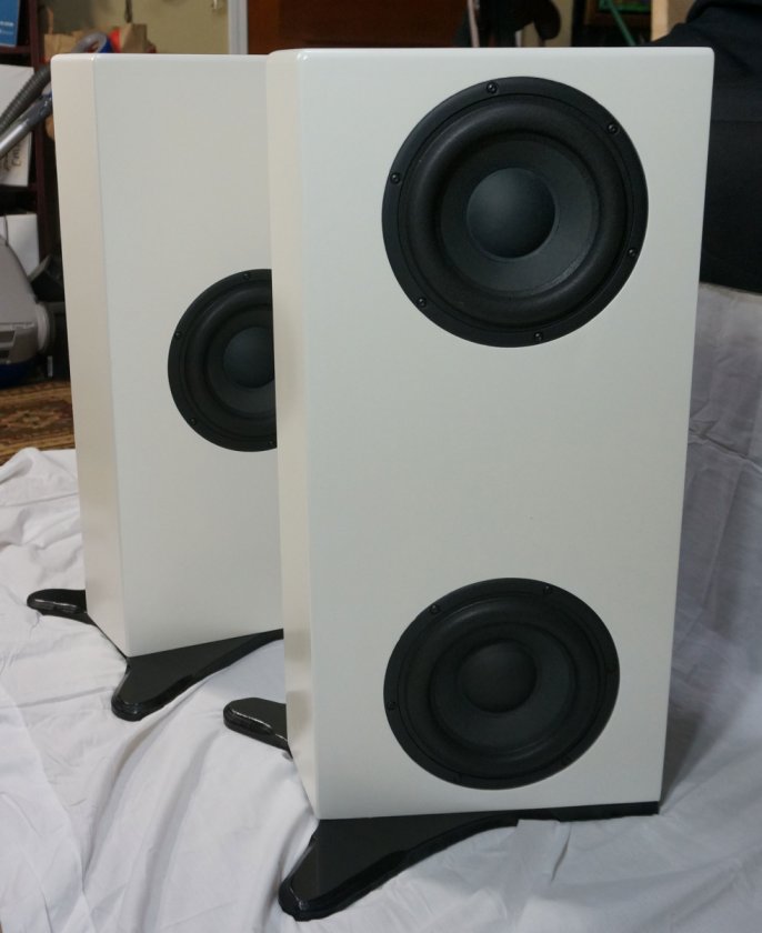

Build a pair of double troubles and disregard what your wife thinks. The moment she hears the music, she'll understand.

Build two sealed servo subs and put the studios on top. Set them on a small stand. Now you have some DIY NX Old Schools.

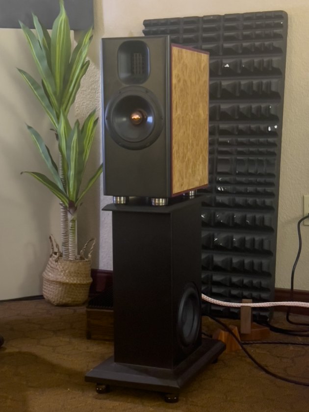

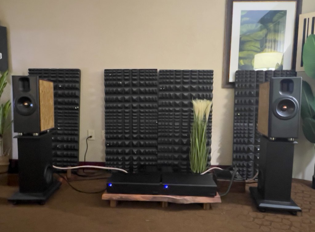

I am using these Rythmik F8 subs with my Wilson Duette, but much of the idea for buying them is this picture.  The room these are in is bigger than yours and open to a dining room, foyer, and large kitchen.  It's a very large space with tall ceilings.  For me, with the Wilsons, they fill the space very, very well.  I was running them hard today and noticed just a slight bit of strain.  I have them set to the middle setting so they can play higher output, but not below 20Hz (I think).  I have plenty of bass.  To help with that ease at higher volumes, which is rare that I play fairly loud, I bought 4 of these - 2 pair... 8x 8" servo drivers. Those are sitting in the corner.  I think that was a good idea as, when I get around to hooking them up, the setup will be capable of even more ease and clarity at that same "aggressive" volume I notice a bit of strain.
I may end up with OB subs one day, but I am playing with many different things.  The setup I have with these is already so, so good...
What you can't see is that the F8 sub is on top of 2-2x8 boards to raise the NX-Studio tweeter level.  So, if I want these sitting on top of the sub, I will make a base for the F8 sub to sit on. A triple set of these 8" drivers in a sealed cabinet would be ideal, if someone wants a sealed setup - which I have been very happy with so far.  And given the vertical spacing needed, it looks like a pair of triple 8" would be great for height.  These are far superior to the SVS SB16-Ultra subs I just sold.  They are faster / more musical, and play plenty low enough to add that presence needed from true low end bass.
People don't "need" 7' tall speakers and sub towers to have great sound, world class sound even... but that stuff sure sounds good too!

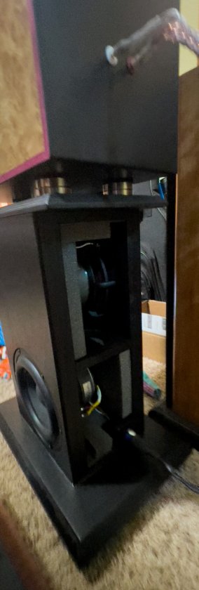

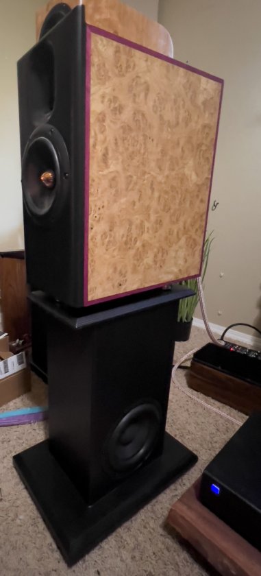

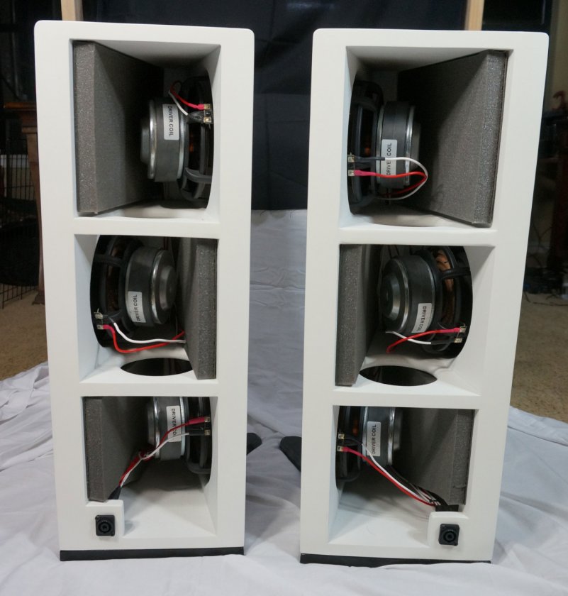

Another option for solid output flat to 30Hz is to put the studio monitors on Danny's "Best Speaker Stands Ever". These are speaker stands with servo subwoofers built in. Similar to what I had at LSAF this year:
I built this pair a little different that the original plans. They were built 5" shorter so that when GAIA isolation footers were used under the stands and Orea footers between the stands and the Studio Monitors, the tweeter would be at 39". This required removing the amp from the stands and using it outboard like with the 12" OB subs. I also used the A370XLR3 amps instead of the HX300s the stands were designed for. There were three reasons for the amp switch; the HX300 is no longer available and at least at the time of the show it's replacement was not yet available, my electronics use balanced connections and the A370XLR amps are the only ones with balanced inputs, and I prefer the A370 series amps for their increased connectivity and adjustment options.
Other build options are:
1) make it to the original plans and don't use tall isolation devices unless your seating position puts your ear height high enough and build the amp into the stands when they become available, or
2)  make the stands taller, leave the amp separate, and add a third driver. This is how the triple 8" base for the Wedgies was designed, just for the studio monitors, make the stands rectangular instead of wedge shaped.
I plan on making a pair of the triple driver version speaker stands. I liked the performance of the three driver version better than the two driver version and I don't mind having the amps separate. The trade off will be not using such tall isolation devices.

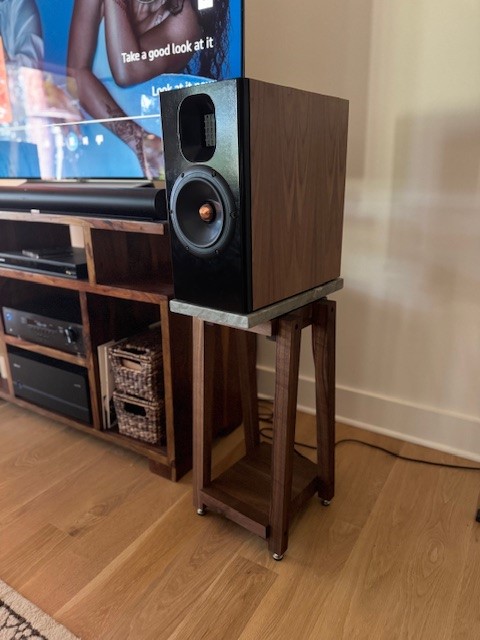

Appreciate all the commentary everyone.  Seeing those "Best Speak Stands Ever"  or  those by Mlundy57,  seem like provide somewhat of a compromise.  Another thing I can't square is the tweeter height if I place the NX Studio on top of the Double Trouble.  Aren't those 32" tall?  My stands are 26.5" and work with my listening position which is around 40" high.  With the Double Trouble wouldn't that grow by about 6"  How are you addressing tweeter height using the double trouble as a stand?   :?
without an additional base or top, they are ~27.5 incher tall. If you add 3/4" to each the top and bottom for a decorative look, like our flatpacks, then you're looking no taller than 29-30" at most. That said the dual-forward units will be a little taller than the opposed design.
If you don't mind building them yourself, then you can also go with a W-frame which will be ~4 shorter than the standard H-Frame.
