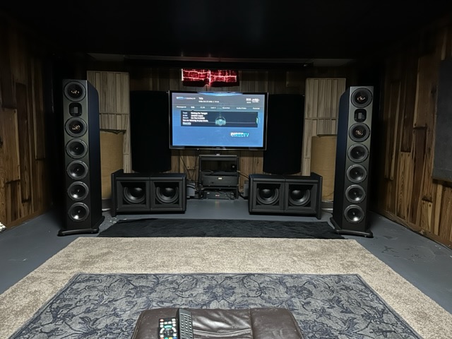

 Here’s an update on my sub placement experience. After plenty of listening with the subs on the side wall and a little behind the speakers, I decided to try them back in between the speakers. Laying them on the sides, but this time a little farther back from the plane of the speakers, close to where I had the sealed subs I used prior. This seems to be the optimal location for my room.
Since I have a projector screen, using the subs in the center would block the view, and is the reason I set them horizontal instead of upright. Just throwing that out there in case anyone has a similar situation, don’t be reluctant to try the subs this way.

Try using your subs as speaker stands like Tyson did. It may seem a bit crazy, but it will probably sound more seamless that way.

I think it would place the tweeters too high.  With an MTM like the Otica, you really want the tweeter to be as close to ear level as possible.

 A design with two woofers on top and two on the bottom of the MTM would align the tweeter close to the height of the normal design. But not sure how it would perform, maybe not as good.

Subs slightly behind the speakers is fine.  It will just emphasize the leading edge of the bass slightly.  Which is not a bad thing.  As long as you are getting a smooth frequency response between the mains and subs, you're good.
