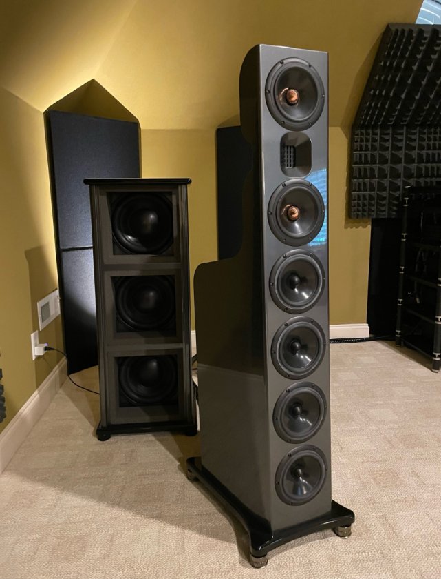

It has been a little over 7 years since I completed my NX-Oticas and companion triple 12-inch servo subs.  Over those years, all of my equipment has been recycled at least 2 or 3 times, with the exception of the Oticas.  They definitely have stood the test of time and remain the foundation of my system.  Digital room correction (DRC) has evolved to the point where I have fully embraced it and have made it part of my system architecture.  So I decided to take the next logical step and integrate digital crossovers and DRC into a full digitally-based software solution. To accomplish this, I utilized Audiolense XO https://juicehifi.net/ to define crossovers for a 4-way stereo configuration and provide correction filters based upon the crossovers and room target curve.  The program provides a high degree of flexibility in regards to controlling all aspects of the correction filters, including driver time alignment, target type (minimum/linear phase), crossover points and slopes. Based upon my experience with other DRC software, the learning curve for Audiolense was reasonably short.

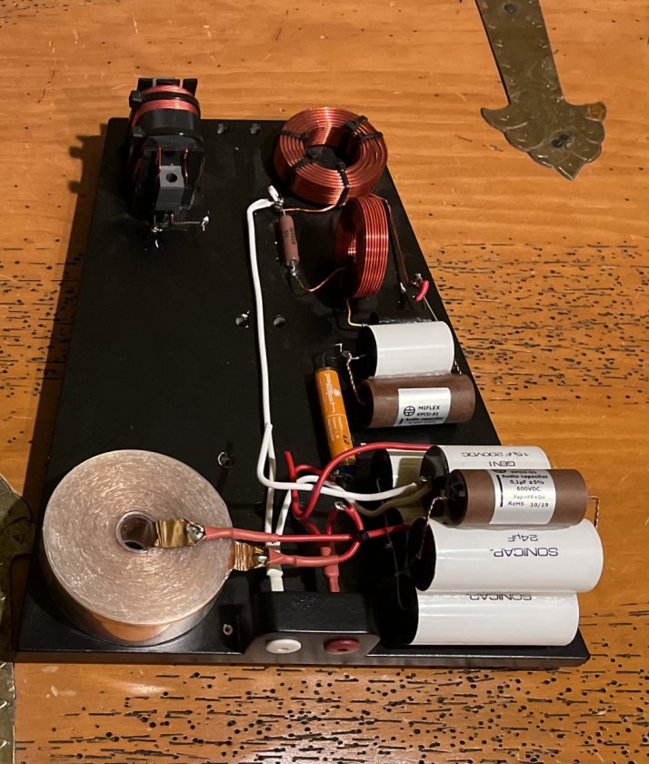

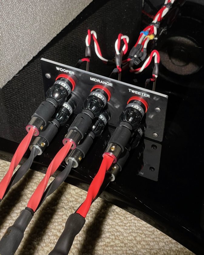

The first step was relatively easy; remove the passive crossovers and route each driver(s) to individual binding posts. I used Danny’s stranded speaker hookup wire to extend the current wiring to WBT low-mass binding posts mounted to a custom small panel.  For speakers wires, I used custom-built cables fabricated using Neotech NEMOS-3080 cable terminated with Furutech locking banana plugs.  Again, by keeping all three speaker cables the same, I eliminate variability between what the drivers will see.

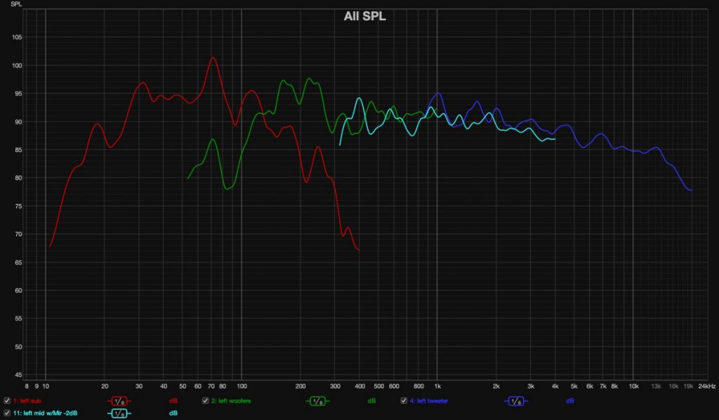

Initial measurements were made using Room EQ Wizard (REW) and are shown below (left channel shown). The role of these first measurements was to set the subwoofer levels and to ensure there were no glaring disparities between the driver responses.  Levels were consistent to using a single amplifier since all three amplifiers had the same gain of 26 dB.  The measurement equipment was an Earthworks M23 microphone connected to a MOTU UltraLite Mk5 USB I/O interface. The microphone was positioned at the main listening position pointed forwards.

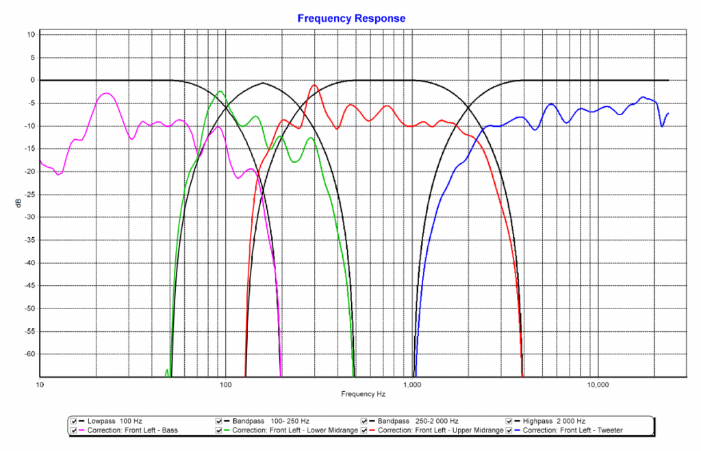

The following graph shows the correction filters plotted along with a set of selected crossover curves.  Here I chose crossover points at 100, 250 and 2000Hz for demonstration (left channel shown for clarity) and you can see how the filters follow the crossover roll-offs.

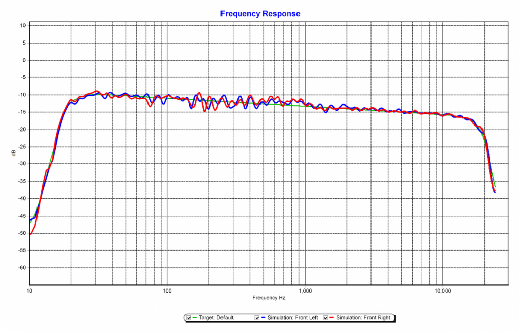

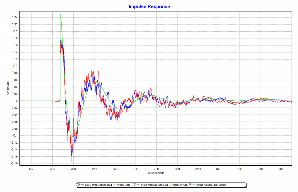

Two of the primary parameters used to evaluate the effectivity of the correction filters are the predicted frequency and step response functions as shown below. Here I have generated a 6dB downward sloping target curve extending from 20 to 20kHz for a frequency response target. This of course is something the user defines and tailors to work with the acoustic characteristics of the room and personal preference.  The results show that the predicted frequency and step response functions match their respective target curve shapes very well.

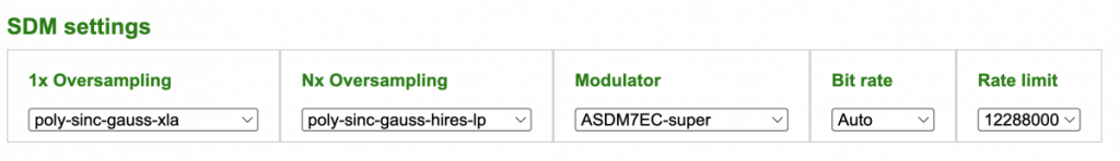

What are your HQPlayer Noise Shaping/Dither and Filter settings? Are you upsampling all PCM to DSD256?

« Reply #2 on: 1 Aug 2024, 12:13 am »

Brilliant work. I'm sure it sounds terrific. The response shown is labeled as the simulation. Do you have a measured plot?
Thanks Tom. At this time I do not have the post correction measured plots. However, I have performed them in past configurations and have found the Audiolense predicted responses to be spot on.

Thanks, my settings are similar. All PCM and ripped SACD's are upsampled to DSD256 but I have to be careful with the modulator or all cpu cores get maxed out and Tj Max reaches 100°C. My music server is fanless without a Nvidia graphics card.
I have a few 2L downloads in native DSD256 that can use DirectSDM.
Once in a while I check into the HQPlayer forum at AudiophileStyle to see what filter combinations most people are using. I'm currently using v5.2.0, probably time to check out the latest version.
1x oversampling: poly-sinc-gauss-long
Nx oversampling: poly-sinc-gauss-hires-lp
ASDM7ECv3
I have found that HQPlayer goes a long way to not adding any edginess or harshness to the presentation along with the upsampling to DSD256.

What type of crossover parts were in your speakers? Upgraded or standard?

It looks like you did a nice job in the conversion. It is not easy or simple solution for sure. In my experience the quality of the crossover parts are so high that they have little effect on the signal (sound quality wise). However, there is a lot of variance in the sound of D/A converters. I usually recommend that our customers put their money in a good DAC and keep the passive filter, as a good DAC for each channel, plus the additional amplificant can get pretty pricey.
