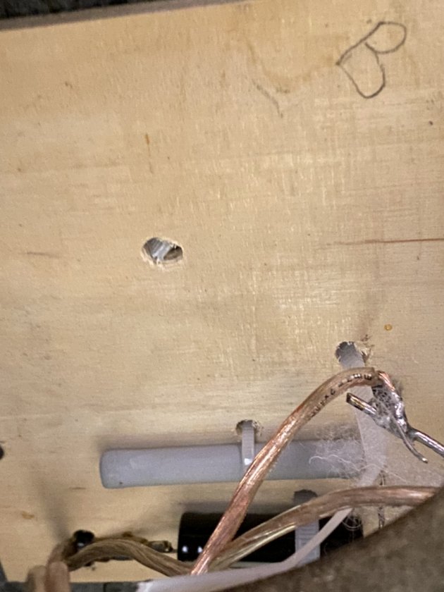

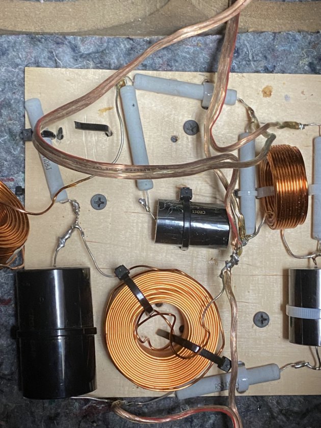

All three copper coil inductors snapped free of their zip tie anchors. I suspect that had they also been hot glued to the crossover boards, I would not have this issue. The inductors appear to have unrolled a half-turn, and I'll zip tie them back to their <presumably> original windings before gluing and zip tying them onto the boards. I think I can repair the damage on my own. I can understand why the largest/heaviest inductor snapped free of the zip ties, but the smallest one is quite light. The clever 'three-lettered' shipping company ending in the letter 'S' employee must have gotten creative with his exeriment to maximize the sheer force required to cause all three inductors to snap free of their restraints. I hope he lost his job.

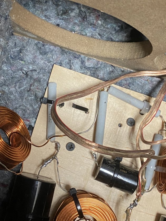

On to the crossovers...three photos for your enjoyment. Three inductors escaped their zip tie anchors. I'll use an super duper adhesive to bond each inductor onto the crossover board below. There are two damaged resistors - one lead pulled out/snapped off on each. I'll need to replace them.
I still need to open up the other speaker to inspect it for damage.
If I can't find the exact same brand of resistors to replace the two damaged resistors, does it matter if I use a different brand so long as the values are the same?
  • Posts: 11626
Mundorf is good quality for not too much money.  As long as it's the same value, you are fine:
