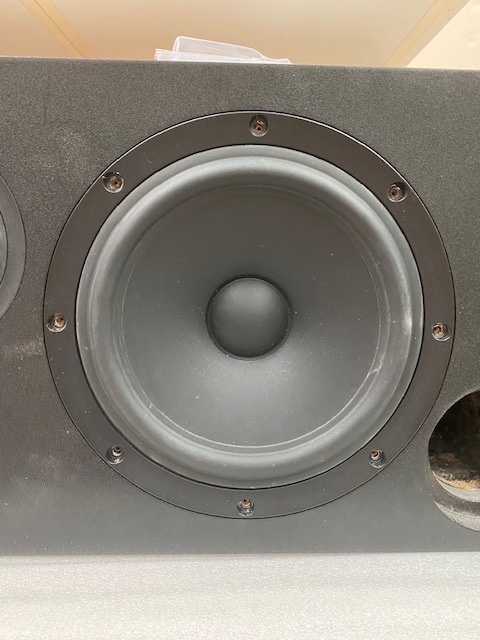

Sitrep:
I recently bought a pair of speakers from a guy in Canada. While in transport, some klutz dropped one of the 60-pound speakers resulting in very minor damage to the cabinet, but managed to dislodge the crossover from where it had been anchored. This is a 3-way speaker with an 8" woofer. I managed to remove the tweeter, but it's too small and too far away from the woofer to allow access to the crossover. The midwoofer is in its own enclosure inside the speaker cabinet, so removing it is of no help. I really need to get the 8" woofer out in order to access the back of the cabinet. The port is front facing, but it's small enough that I can't get my hand in far enough to mount the crossover. [Someone with slightly smaller hands might be able to help.] I can see a large inductor in the back of the cabinet. It's loose/not anchored.
I removed all 8 screws holding the woofer in place. I flipped the speaker front facing down and tapped/slapped the back of the cabinet. Nothing. I placed the head of a thin screwdriver inside different screw holes at an angle and pulled on the backet to no avail. The woofer seems to be very snugly seated.
Anyone got suggestions on how to encourage the 8" driver to slip out of its housing?
Thanks for any help.
Michael

The picks proved inadequate for the job, I'm afraid. I tried several different sizes and angles, but I didn't manage to move the woofer even one millimeter. The only thing I accomplished was to scrape a two-inch long gash along my forearm when one of the picks snapped out of the screw hole and scratched my arm. [Note to self: Be more careful.]

I suggest that you move the enclosure forward, if its not glued in the position as is common in these cases, the speaker will move forward. Its a two-person task so you will need someone to grab the driver when it comes out, so it doesnot hit the floor.
mresseguie
  • Posts: 4945
 :scratch:
I've already turned it face down and whacked the rear panel with the palm of my hand.
The driver housing is tight against the cutout, so I cannot get a knife blade in between to pry the driver out without damaging the front baffle.
Photo on the way:
  • Posts: 21429
Move the driver sideways, clockwise and back, this will loosen the boy.

Normally, builders would only use adhesive on a sealed box design. Being a diy build, if the fellow you purchased from built them he would know. Sometimes the frame just sticks to the baffle paint. Use a heat gun on a low setting to warm up the metal frame. Take your time and be patient. Then simultaneously use either the curved pick in a hole to start getting the edge up or the oversized self tapping screw method. Either way, if it is glued in you don't want it to 'pop' out as it can tear the baffle if it's MDF. The combination of gentle heat and gentle lifting of the frame by the screw holes will break it loose, hopefully without damaging the baffle.

I've also had success at least five or six times with the oversize-screw-in-the-mounting-hole approach. Are the original screws tapping screws that bite directly into the wood or machine screws that go into a threaded insert? if they're tapping screws, I find a bolt (not sheet metal or wood screw) that is very close to the diameter of the hole in the driver flange, then use a wrench to "persuade" it to screw its way in. As it gradually makes its way through the flange, the flat tip of the bolt pushes against the wood of the cabinet and forces the driver out. You may need to do this with several different driver mounting holes to push the driver out evenly,

You're providing ideas that I hadn't considered on my own. Today's first try will be to use up to eight flat machine screws (and/or bolts) to <first> gently apply gentle pressure to the MDF underneath, and <second if the first method is unsuccessful> to pull on the screws with a claw hammer. My last resort method would be to drill a hole in the rear baffle. I had previously considered cutting a large enough hole in the rear panel to allow my hand(s) entry into the cabinet.
