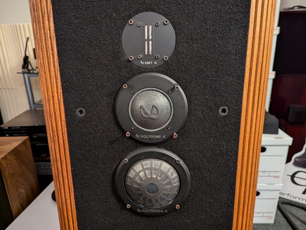

A friend found a pair of Infinity Kappa 8 speakers that need the Polydome K's and 12in woofers rebuilt.  Picked them up awhile ago. Not going to complain for $80/pair. :)
These are the original version 4-way speaker with the bipole EMIT planar tweeters, Polydome K, Polygraph K dome and 12in woofer.

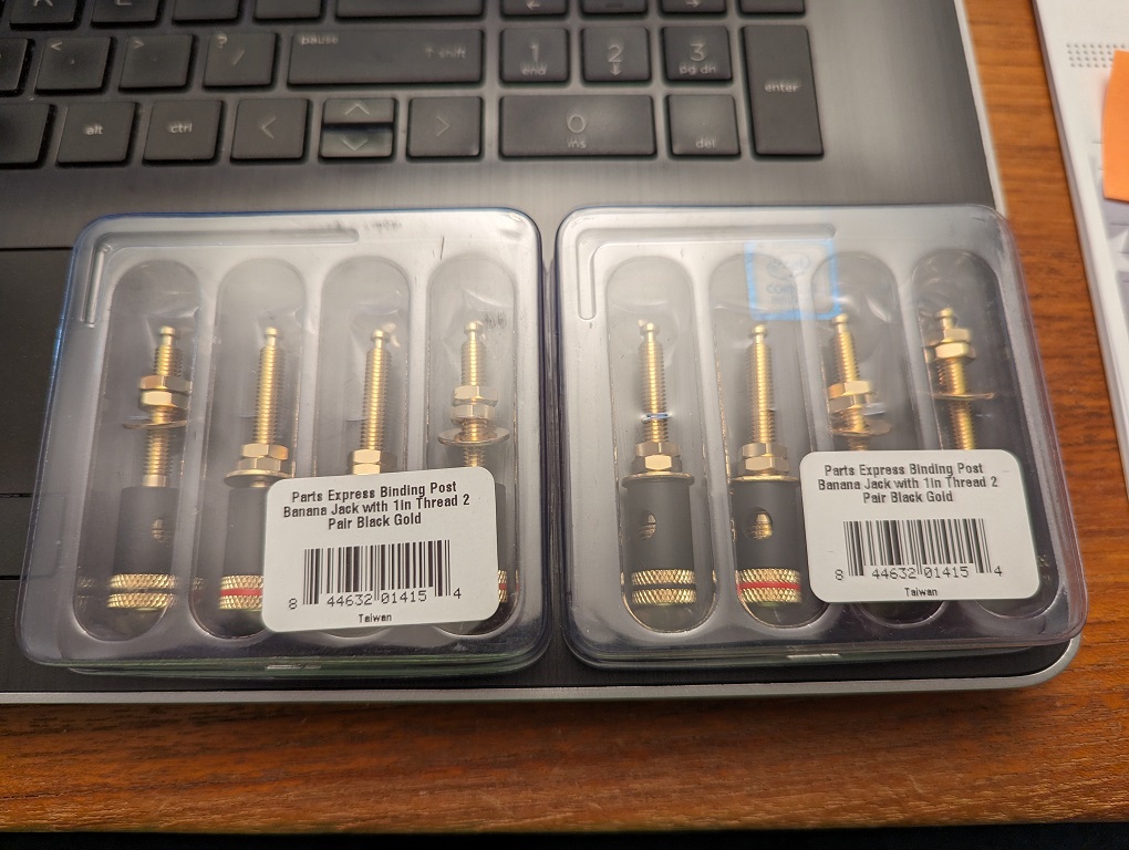

Some Parts-Express binding posts to add enough pairs for each driver in the speakers.

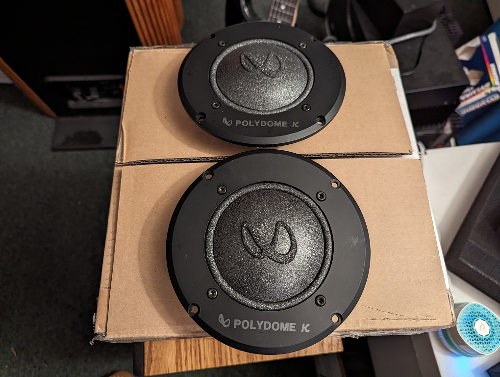

The Infinity Kappa 8 Polydomes and 12in woofers are back from repair at Millersound.
Now to see if the passive crossovers are still working with the drivers connected.
Will be rewiring the speaker drivers to binding posts to use with the DSP crossover and the passive crossover exterior to the original box.

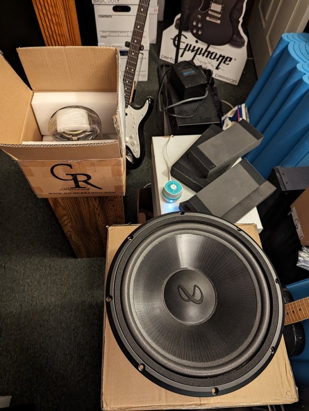

Unpacked the repaired drivers for the Kappa 8 repair.
Wiring the drivers directly to a new terminal plate.

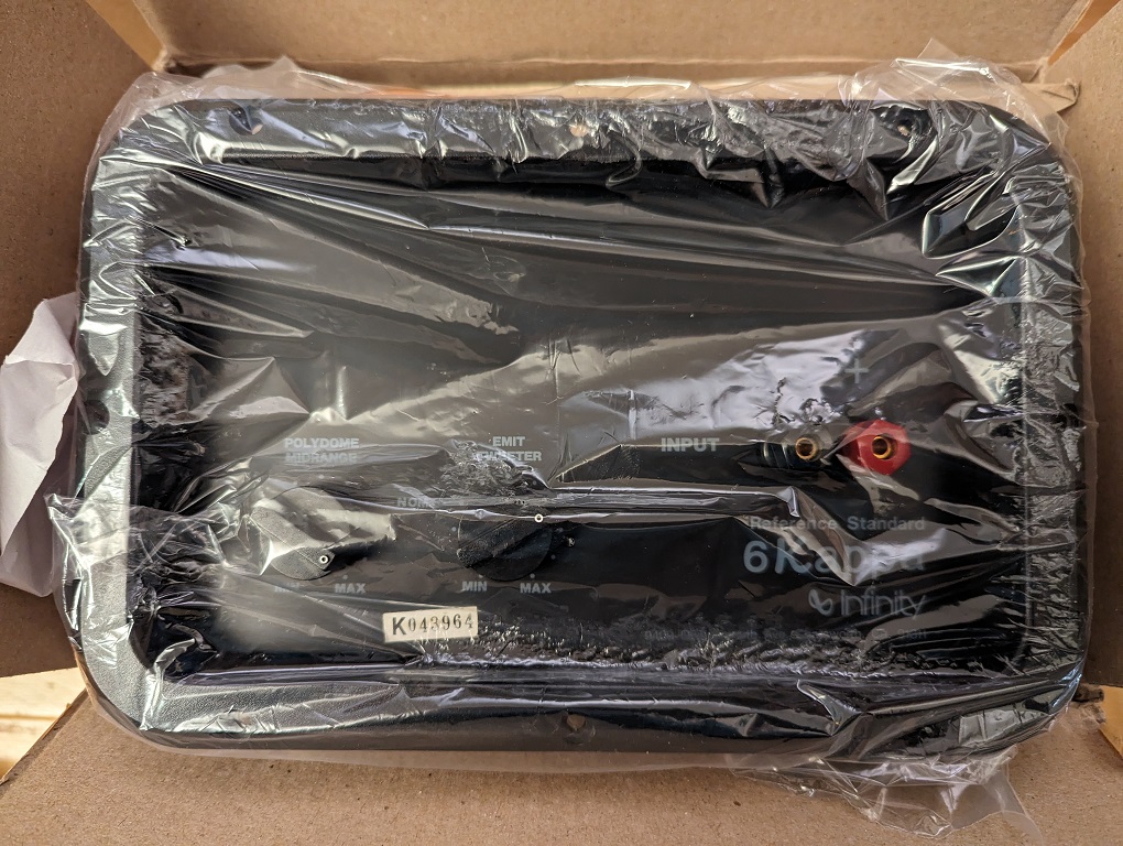

To make it an easy way to add connections to the Kappa 8's to connect to the external crossover, bought 2 Kappa 6 crossovers to use the plate for modification.
Will remove the original K6 parts and install the extra 5-way binding posts and reuse the original 5-way binding posts for direct connection to the individual drivers.

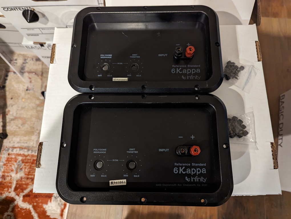

The Kappa 6 connector plates have the original crossover pc boards removed and ready to have the new 5-way connectors installed.
