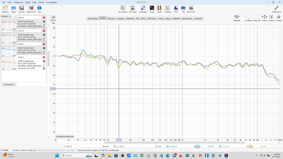

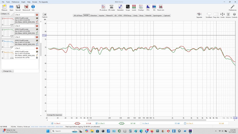

« Reply #56 on: 8 Dec 2025, 04:00 pm »
Here are the frequency response plots on axis for the AGN2 at my listening seat after corrections.
One is flat response, and the other is with the Harman EQ filtering set to my taste.
This is what the dspNexus 2/8 and Audio Weaver can do for speaker systems in a room.  I am not a speaker designer, but the tools are very versatile for either DIY or production speaker correction in your room at your seat with REW for measurements.
