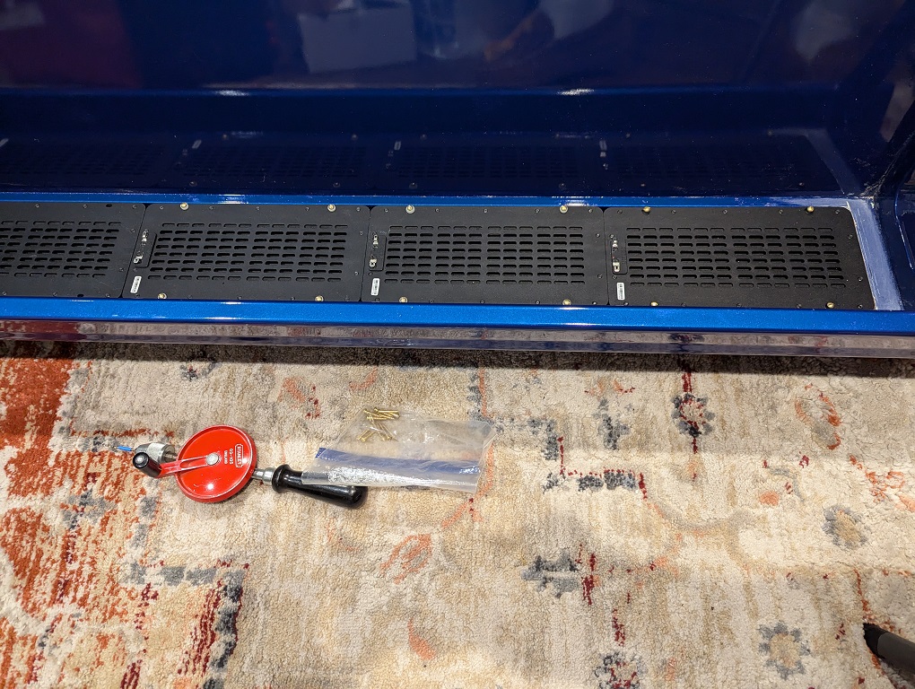

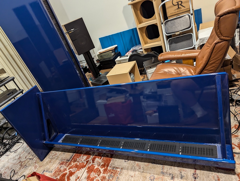

The planars fit perfectly in the reworked slot.
Now time for some pilot hole drilling.

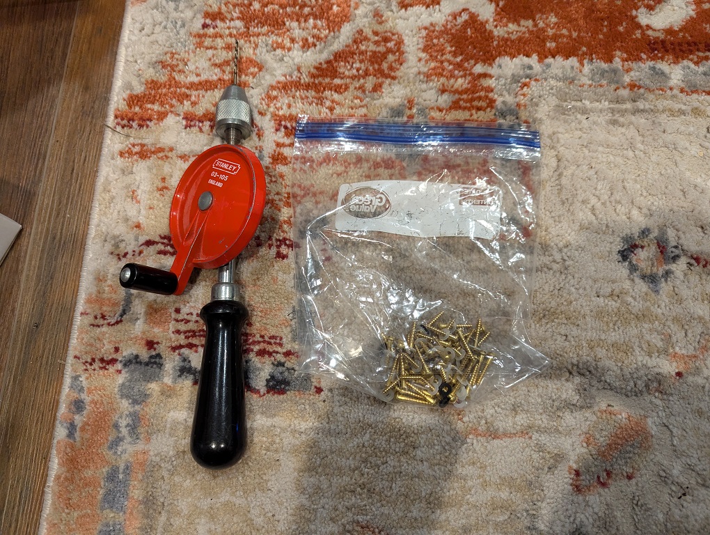

HAL
Re: The AGN II Line Array speaker project
« Reply #25 on: 14 Aug 2024, 11:56 am »

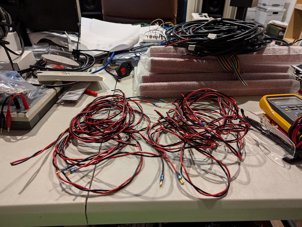

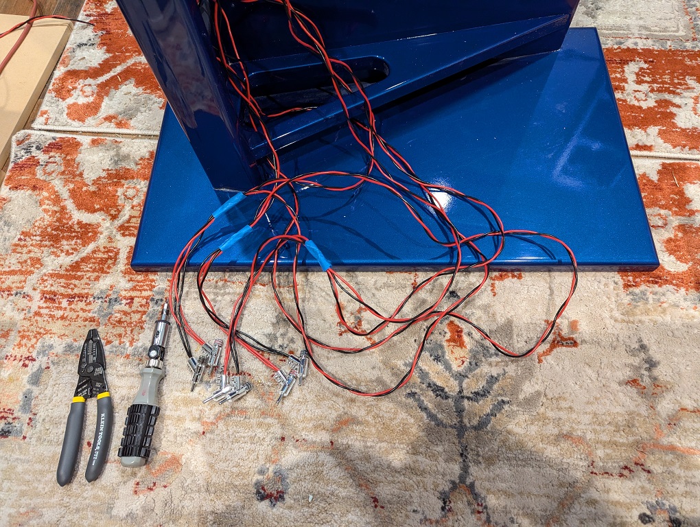

Now time to drill 24 pilot holes for the planar mounting screws.
Also rebuilt 6 cables to connect the planars to the amps.  Will do 6 more cables soon.

HAL
« Reply #27 on: 14 Aug 2024, 04:33 pm »
Yes, easier for me to hand drill shallow holes than my portable drill.  Old tech works fine.

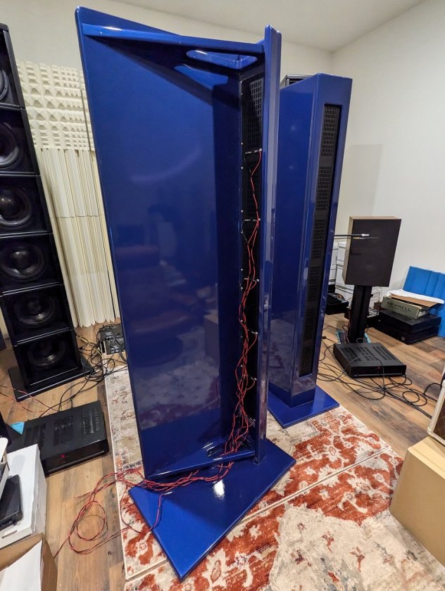

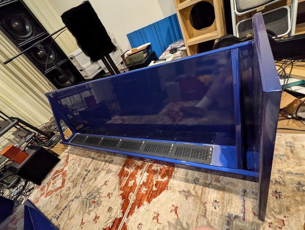

« Reply #28 on: 28 Aug 2024, 02:01 am »
The right AGN II Line Array has the LM10n planars installed.
Next is install the left channel planars.  Then connect the wiring for the monoblock amps.

The AGN II Left line array planar install started.
The local hardware supplier ran out of my preferred nylon washers, so waiting on restock.  Had enough to install 3 planars for today.  Will check on another source to see what is available.

« Reply #30 on: 30 Aug 2024, 04:41 pm »

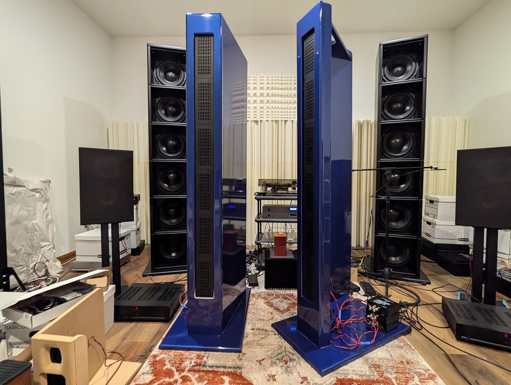

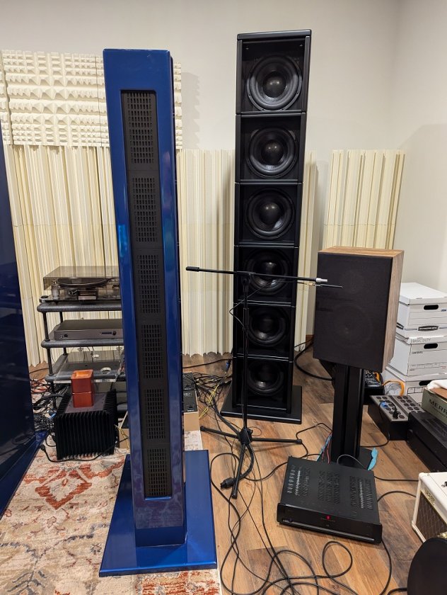

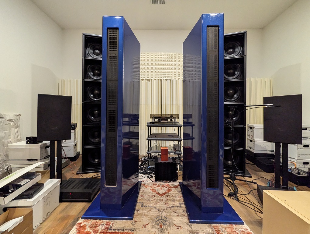

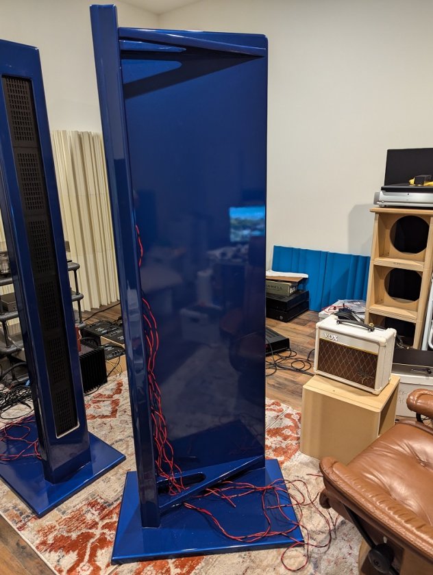

The prototype pair of AGN II Open Baffle Planar Line Arrays are assembled and ready for wiring.
Will be using Belden 1309A 14awg stranded wiring to all the planars directly to the monoblock amps.

« Reply #31 on: 31 Aug 2024, 04:36 pm »
Just finished wiring the left AGN II planars with 14awg stranded wiring.

The LM10n uses the PDR style technology for improved horizontal dispersion from what is visible.
It works quite well for the Magnetar II single planar driver version of the design.  The LSAF2023 show used the single driver setup for the in room demos.

« Reply #34 on: 31 Aug 2024, 06:57 pm »

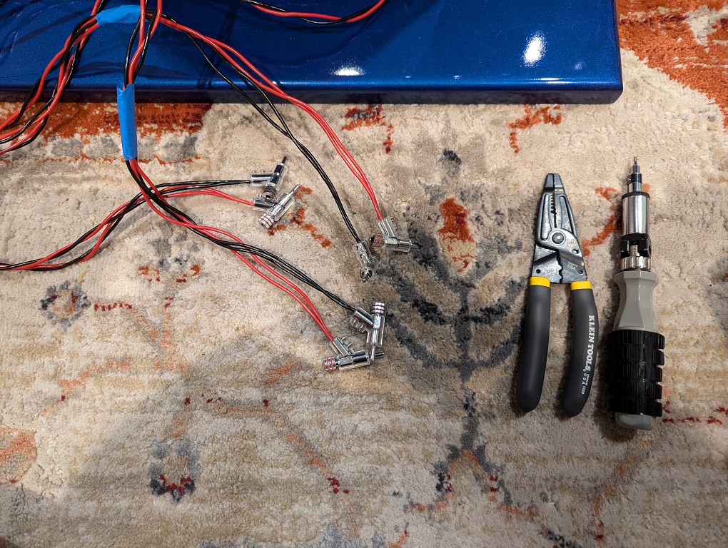

The right AGN II Planar array is now wired and ready for locking connectors to be added.
The planars will be wired directly to the amps with the attached 14awg cables.

« Reply #36 on: 3 Sep 2024, 11:05 pm »
The pair of AGN II Planar Line Arrays have locking connectors installed.  Using Rhodium plated locking banana plugs for each pair of planar drivers in the array.
Next is connection to the 3 pairs of Orchard Audio Starkrimson monoblocks with the GaN SMPS to the dspNexus 2x8. Then time for measurements and listening trials.

Have the pair of AGN II Line Arrays wired to the Orchard Audio Starkrimson Monoblocks.
Next connect the XLR balanced cables to the dspNexus 2x8 with the AK4499EX DACs for measurements and listening.  I like balanced as when I measured SNR, it was 30dB lower noise floor with balanced than unbalanced.
