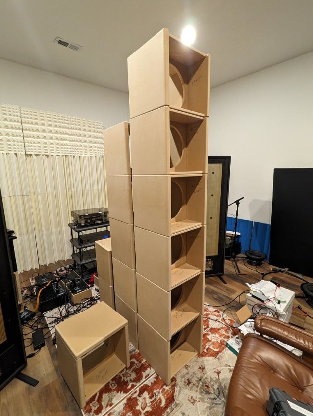

I am thinking bigger.
Time to get the 12 1x12 modular OB servo sub H-Frames to painting next week.  :)

HAL
  • Industry Contributor
  • Posts: 5588
Re: Let's talk about Subs
« Reply #51 on: 26 Apr 2024, 07:55 pm »
They go with my new AGN II Line Array speaker project.
Pics on my circle in that thread.

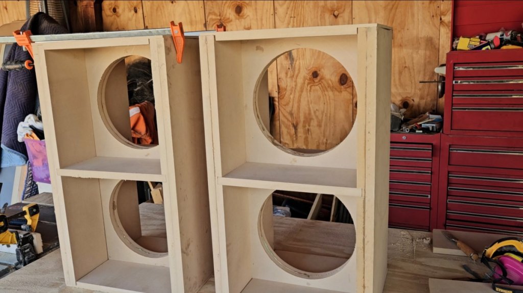

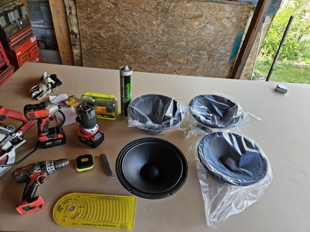

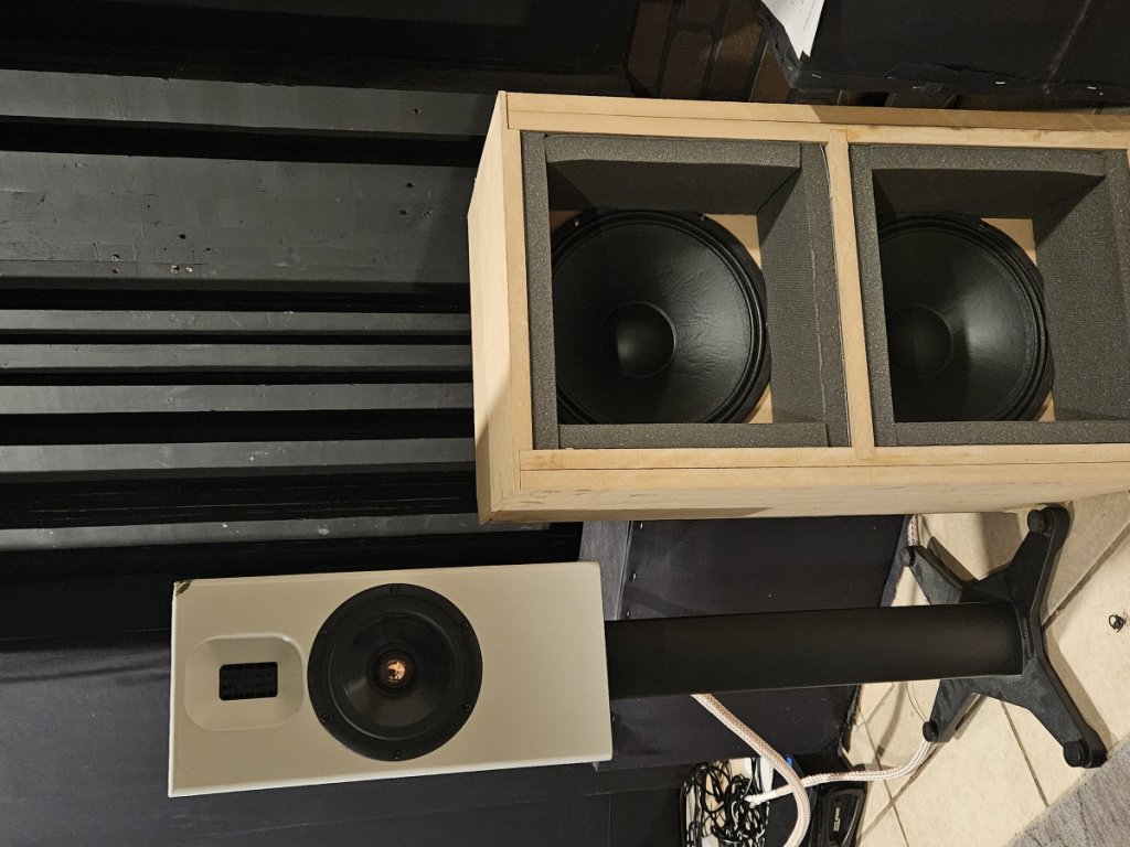

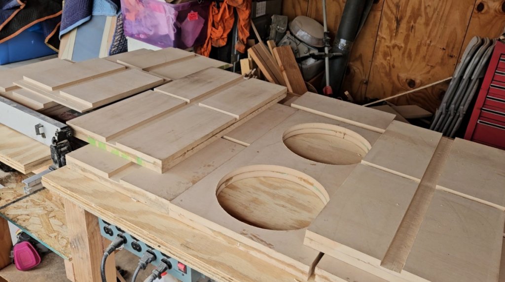

I decided that I wanted to build a set of double troubles but since I had recently blown my cash on a meitner ma3 dac, I decided to build a set for the cheapest amount of money.
I substituted the 600 or so for the the flat pack and built my own for around 100.
And I substituted the 2400 I drivers and amps from gr with 4 sb audience bianco 12ob150 for 400 and a crown xls1002(built in crosover) that I had laying around.
I also bought 4 sheets of no rez, good stuff!
Total cost for me was around 750$. A steal compared to 3k+.  :lol:
Drivers and my tools.
Cut mdf
Glue up
Setup
I am extremely satisfied with this project. Although the woofers only rated for around 40hz, thanks to the hfame design and room gain I get usable output down to 25 hz.
The amp does have have a crossover built in but not a phase adjustment. Thankfully I was able to get by, by just inverting the phase in the speaker wiring.
I am very happy with the sound of these subs. They replaced a single rythmic f12se and 2 rythic f8 subs. I get Much cleaner bass from these 2 subs Than the rythmiks.

Theese are the woofers I used. Fs is at 44 but it seems that the hframe pushed it down some.
These have a high sensativity, high qts and a fair bit of xmax.
The only other drivers like these are much more expensive offerings from acustic elegance and lii audio.
I might decide to upgrade to the ae dipole 12s in the future.
