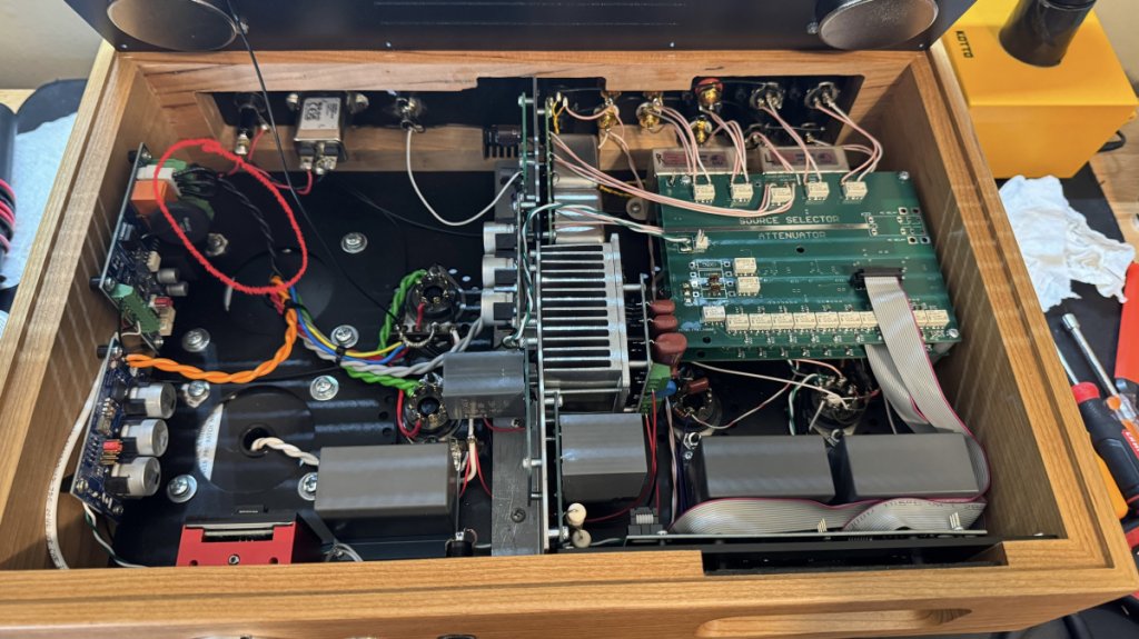

I’ll add a little to this, if you look at one of my older builds you notice were now using split 120v windings going to the soft start (circled red). Tom’s soft start allows us to easily change from 120 to 240v. So going forward we’ll be able to accommodate for international customers.
I will add that you can see the build is neat and clean.  Signal path wire is VH audio copper and the power supply and filament wiring is mil spec teflon insulated.  The preamps should be very reliable, and there are no electrolytic caps except in the regulated filament supplies.  They are very expensive to build, and they sound that way.  Depending on the tariff situation, they may get more expensive since there are single source parts, chosen from many years of experience, that come from Canada, Belgium, and Poland.  We shall see what happens.
