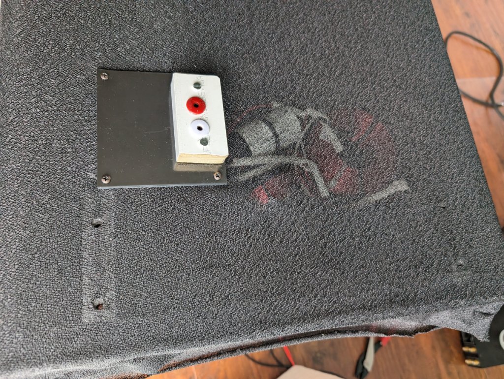

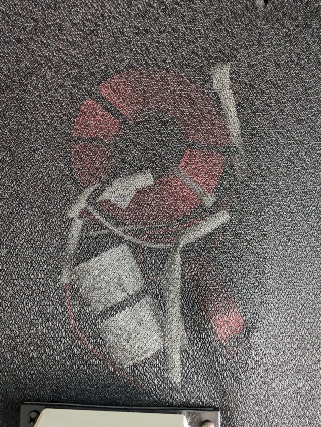

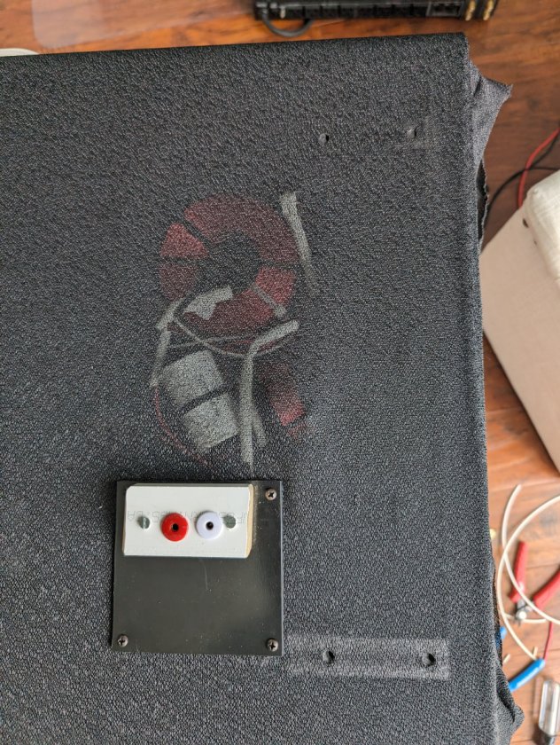

Posting here some photos from beginning to end for those interested in such a project.
Some interesting points:
  • Initially, it sounded bright but called GR-Research and they explained the capacitors need at least 200h of break in, and after that time if I still feel it bright, they will help me bring it down a notch.
  • The original magnepan crossover have a 1.2 ohm resistor in the signal path, GR-R don't. This may explain why the magies sound brighter on the top-end, but I most say there is no sibling just more present. GR-R told I can add it back if I want to, they will help.
  • I need to rise the volume 1 level up to get the same SPL I had before with the original Magnepan crossover.
  • This crossover design really makes very noticeable difference, wider soundstage, more stereo, off axis response got wider and balanced, instrument separation and more detail.
Really great support by GR-R team.

    Wow this is the first time I've seen someone manage to fit the 1.7 kit inside of the speaker, and a rather clever way to do it too!
    Very cool! :thumb:

    Very nice! I was thinking about upgrading a pair of 1.7i crossovers with Danny's kit but there seemed to be a lack of instructions or information. This really makes it clear. As I understand it Magnepan "supports" these crossover upgrades.

    i just finished upgrading maggie 1.7 and also feel its borderline too bright so i am greatly relieved to hear break in will likely fix it and if not gr will help...whew!
    (i went outboard but likely could have fit it inside after all...i decided on outboard because i wanted to access the crossover without having to disassemble the speaker...) went with heavy duty velcro to secure the sock...works well...don't like staples...
