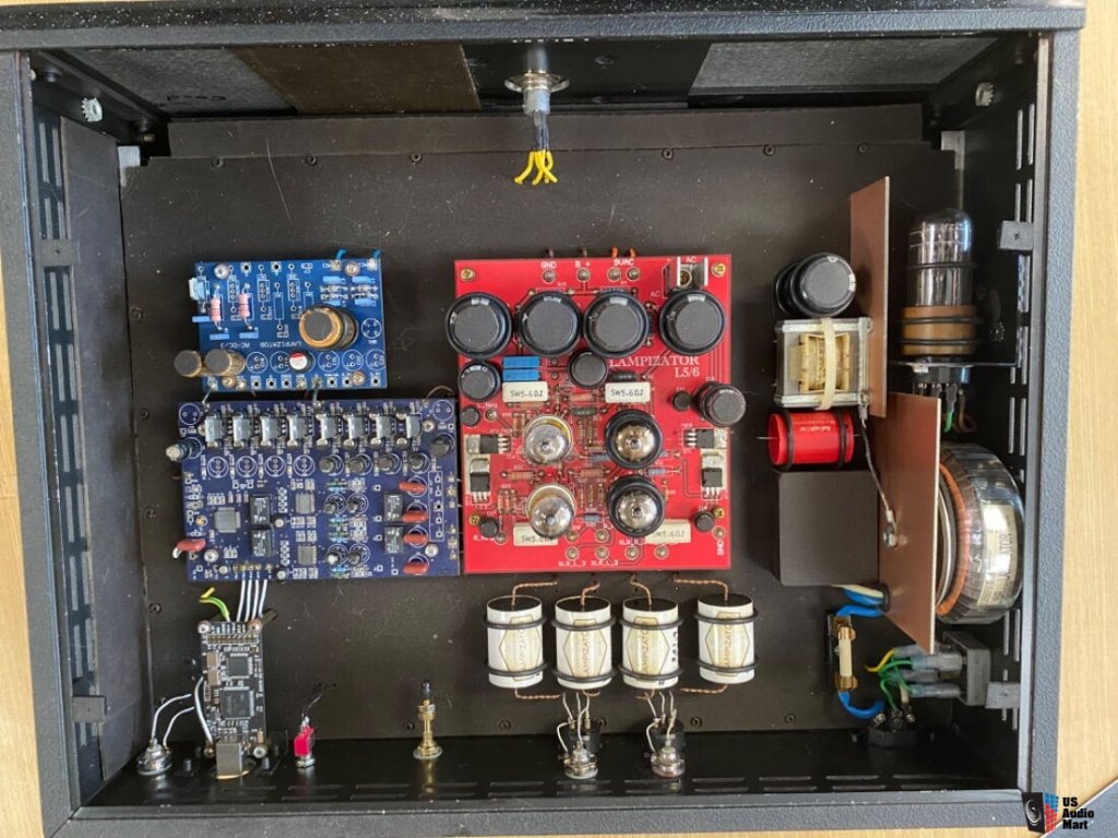

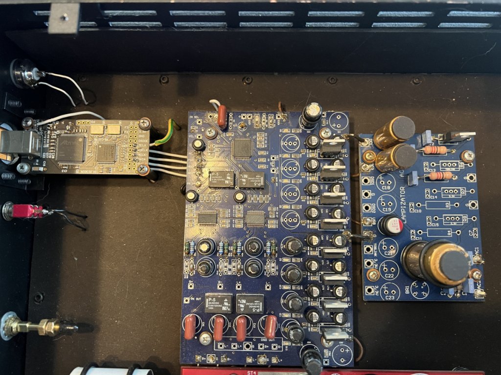

I bought a Lampizator L5/6 kit DAC with WE and Telefunken tubes.  The treble is far higher output than other frequencies.  Any suggestions on how to balance this out without an equalizer?  Feeding it into a First Watt F5 amp and Elekit TU-8600S amp with same results.

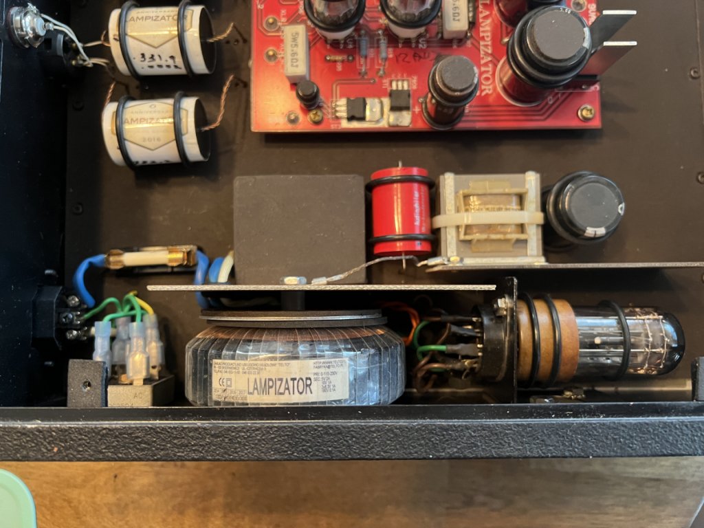

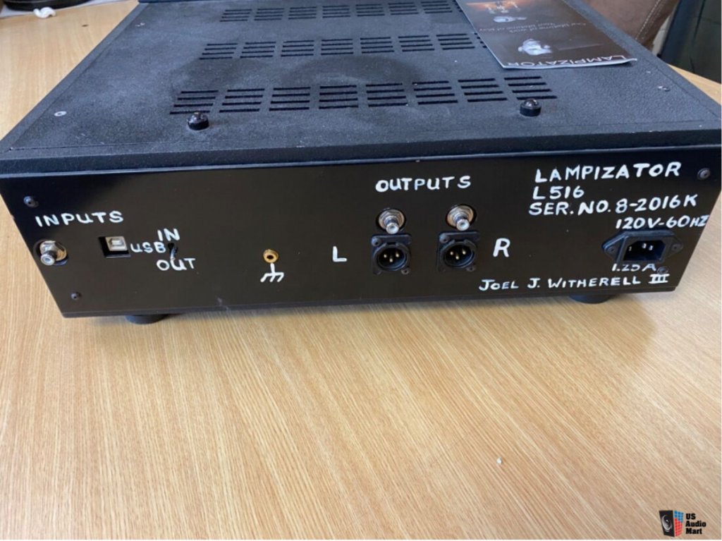

What's an 'L5/6 kit dac'?  I'm only familiar with L5 or L6 dacs (quite different) and didn't think there were any kit dacs? Exactly what type and brand of tubes are in the output stage, and what type/brand of rectifier is in the power supply? And is there a plate on the back you can post a picture of?

Sure thing, let me figure out how to post pics.

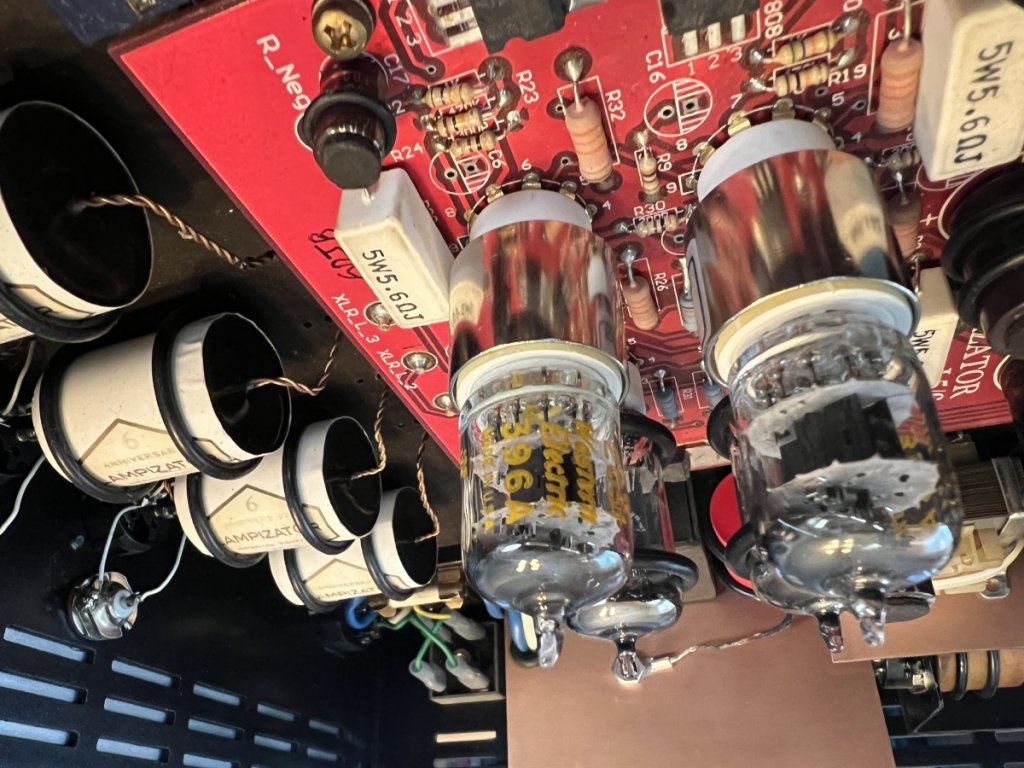

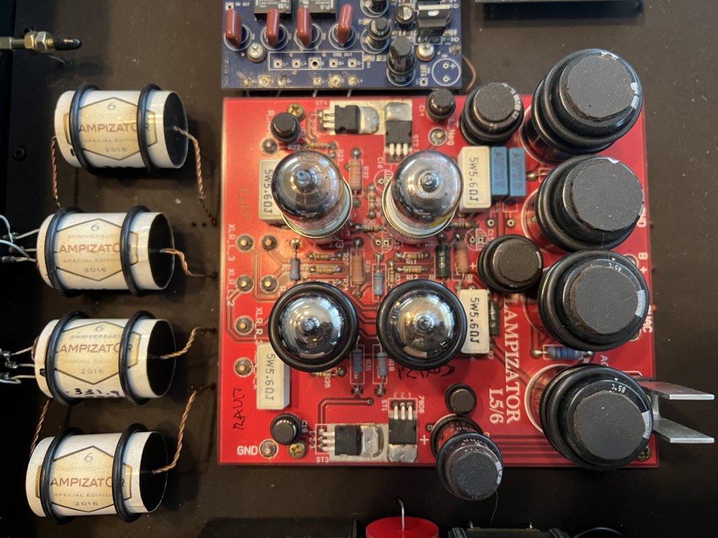

Telefunken AU7 x2
6DJ8 but using WE 396A
Bendix 5852

I can tell you the WE 396A is not a drop in replacement for 6DJ8 though I've heard of people doing that with an adapter, but they still aren't that similar. You might want want to try some standard 6DJ8/6922 to start, maybe Mullard, but anything you have to get going . Assuming the Telefunken are in the 12AU7 slot, those are going to be more clear and open on top compared to say a Mullard or Amperex 12AU7. Can't tell what rectifier is in there (GZ-34?), but there's probably a Mullard for that too!

That’s the Bendix 5852 rectifier. The WE tubes have an adapter base.

I have no idea what this is, but LampizatOr hasn't sold kit anything in many years.   My guess is this is some knock off from an eBay seller in China.

Change the tubes and/or the output caps.  I built a Pass Labs B1 preamp/buffer and played around with different caps and resistors.  It was eye opening in the least to hear the differences.  I found that Clarity Caps had less treble energy.

I would also replace those sand cast resistors with Mills or something similar.
