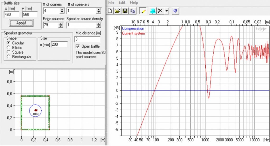

How important is the use of Tolvan's Edge Software?
Take Decware Betsy OB speakers as an example. When Edge is given the dimensions for the Betsy you get an enormous off the chart peak @ 500 Hz (approx. +15dB),
and @ 60 Hz the output is -4dB which is a difference of 11dB.
The Betsy speakers are supposed to sound quite good despite the rather horrible response indicated by the Edge software, so what is going on here?
- Either I'm missing something (which of course is quite possible), or the Edge's response curves aren't really that important.
Hi, your numbers don't add up. Could you post a screenshot maybe (both the graph and the dimension/setup would be helpful.)

« Reply #8 on: 22 Mar 2024, 01:58 pm »
Increase the number of sources used for the driver, that will smooth out the EDGE's baffle response. Upgrade the analysis to use BASTA (same Tolvan site) to include the driver properties and get a more realistic look at the OB design and the SPL response. It won't look very good, you really need at least a  two way for an OB speaker to produce any bass output.
