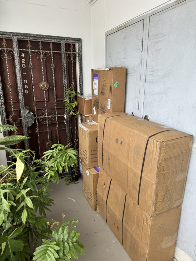

On Monday, I reached home and was greeted by the sight of this:
An NX-Studio kit, a pair of Double Trouble kits and some speaker cable. Seeing the mountain of boxes, I'm suddenly scared I've bitten off more than I can chew but am trying to put that fear aside. "Fear is the mindkiller" - Lady Jessica

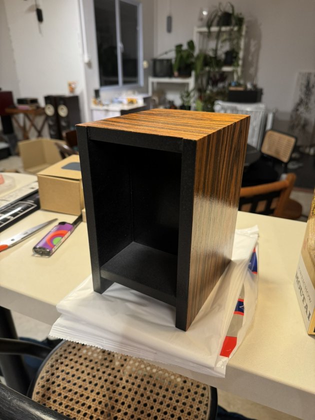

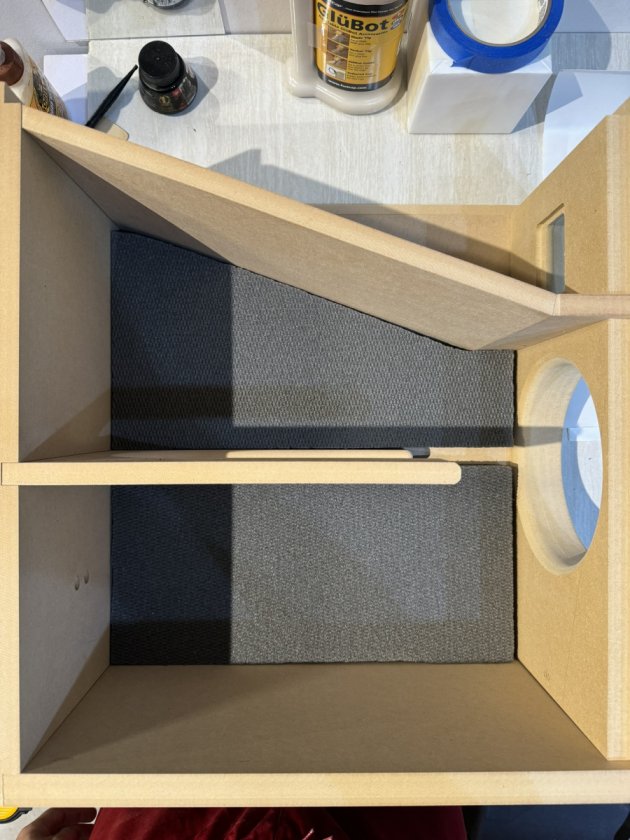

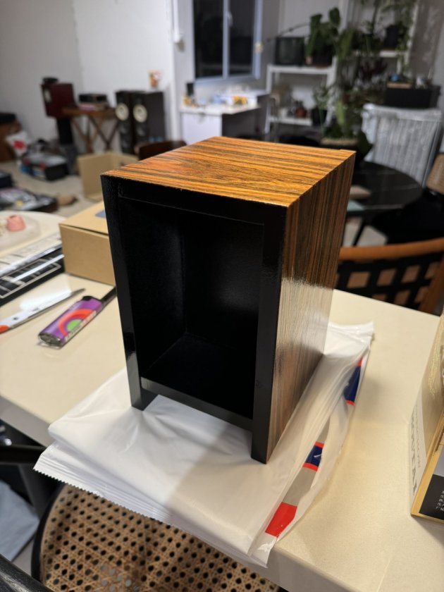

To get a preview of what it might be like building the Double Troubles, I made this thing which is kind of like a mini-H frame.
I realised it's quite challenging to spray the inner faces so I might paint those faces prior to assembly and gluing.
I've also found that superglue is very good for sealing MDF edges so they can be sanded smooth to allow an almost-piano gloss black finish to be achieved. Note: Only the first photo of the mini-H frame has edges sealed by superglue. In the second photo I used Minwax sanding sealer on the edges but it didn't seem that effective.
Polyurethane spray https://www.krylon.com/en/products/specialty/clear-polyurethane-coating?bvstate=pg:4/ct:q will be used to seal the faces of the MDF panels prior to applying the primer+paint spray https://www.selffix.com/rust-oleum-2x-ultra-cover-spray/. Top coat will be a lacquer spray https://www.selffix.com/rust-oleum-lacquer-spray-gloss-clear/ which I will then sand to 1500/2000, polish and finally glaze.
Unfortunately living in an apartment in Singapore, I do not have a garage with air compressor and spray guns so it's all spray cans for me  :cry:

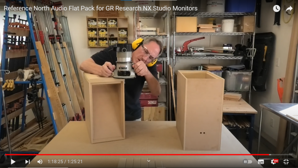

If you haven't built the NX-Studio's yet, I highly suggest you consider utilizing PeterJ's Video link here below.
Titebond link:  http://titebond.com/
As much as I appreciated the adheasives Peter suggested, which is a excellent product by the way.  I went in another direction, I felt personally it would make it less stressful, using a longer cure time adheasive. In my case as a beginner, I wanted more set up time to work with the cabinet getting it aligned and squared up properly with clamps.  Here is what I used and had excellent results. I'll emphasis, both are excellent options for any speaker build.
https://www.systemthree.com/
Titebond gives you a 15 minute working time, while the Systemthree T-88 gives you a 45 minute working time. In my case felt more beneficial for me personally. I had excellent results.
« Last Edit: 25 Mar 2024, 09:24 pm by NXSTUDIO-DRUMMER »

Thank you @NXSTUDIO-DRUMMER for the link to Peter’s video! Somehow it did not come up when I’ve searched “GR Research build”.
Great point regarding longer cure times. Unfortunately it seems the Systemthree is not readily available in Singapore. I used Titebond for a cheap Parts Express C-Note speaker build recently and I think as long as I don’t try to glue together too many panels at once, the 15 minute cure time is sufficient.

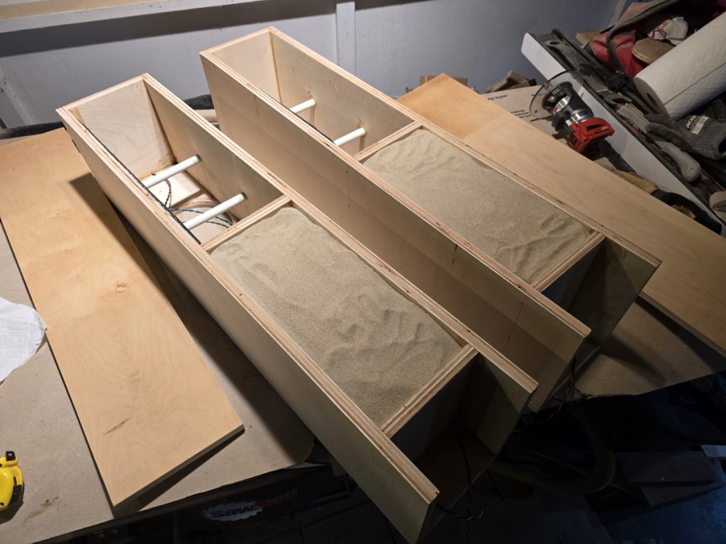

If your flat packs are like mine with inner and outer panels, here's what I did with my Double Troubles, which looks similar to your mock-up:   https://www.audiocircle.com/index.php?topic=176852.0

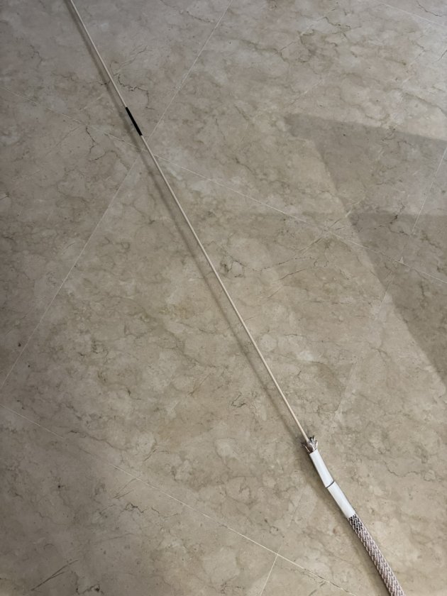

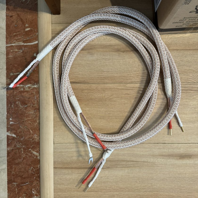

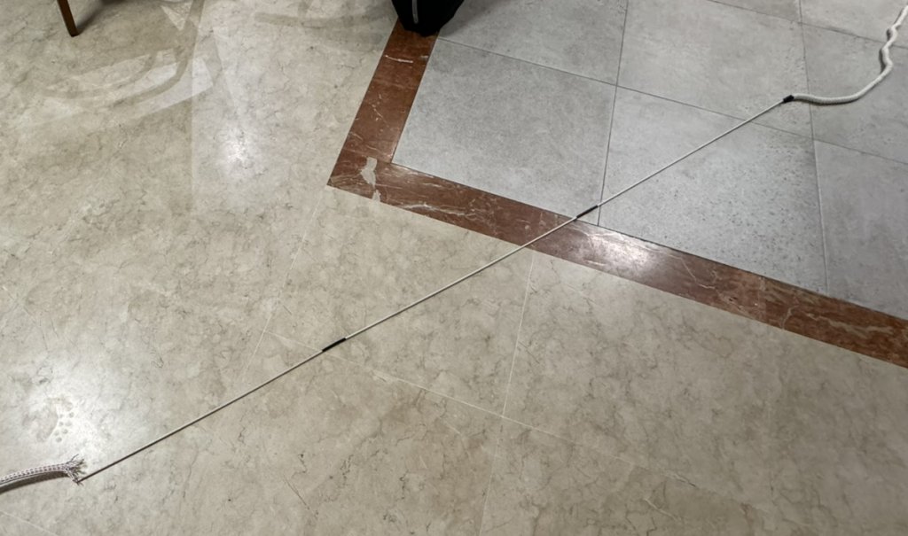

I've finally started my build... with speaker cables!
I referred to Danny's youtube video https://youtu.be/DfjQJxeTANE?si=D7aoCG2DkrLmVqHo but used RockBall's method of twisting together the thickest two strands from each wire to insert into the tube connector https://www.audiocircle.com/index.php?topic=172291.0.
Because it's such a tight fit though, I am not sure if the wire goes all the way to the tip of the tube. I can only hope the fact that I could not push the wire any further into the tube, despite using all my strength, means the wire is right up against the tip.
To aid in pulling the rope through the centre of the cable, I taped some long wood rods together so that its combined length is longer than my cable. To the last wood rod I taped one end of the rope.
I then put the wood rod through one end of the cable, grabbed on to the rod that comes out the other side, and slowly pulled the rope through, making sure to loosen the braid around the rope when it really resisted getting pulled.
The final product:

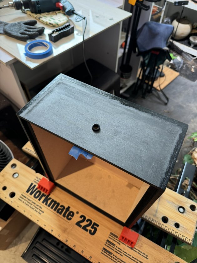

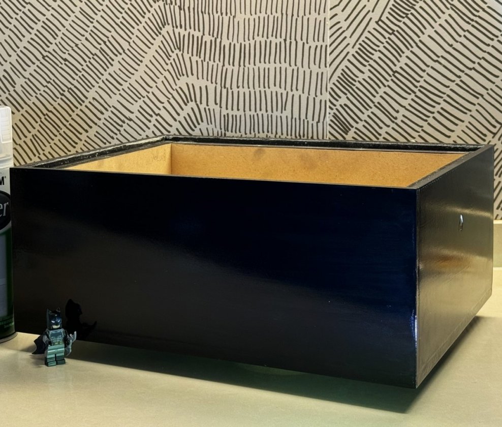

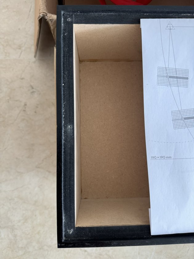

I decided the amp box was a good place to start and get more practice because if I really screw up, it won't be too visible, or I could build another box with relative ease.

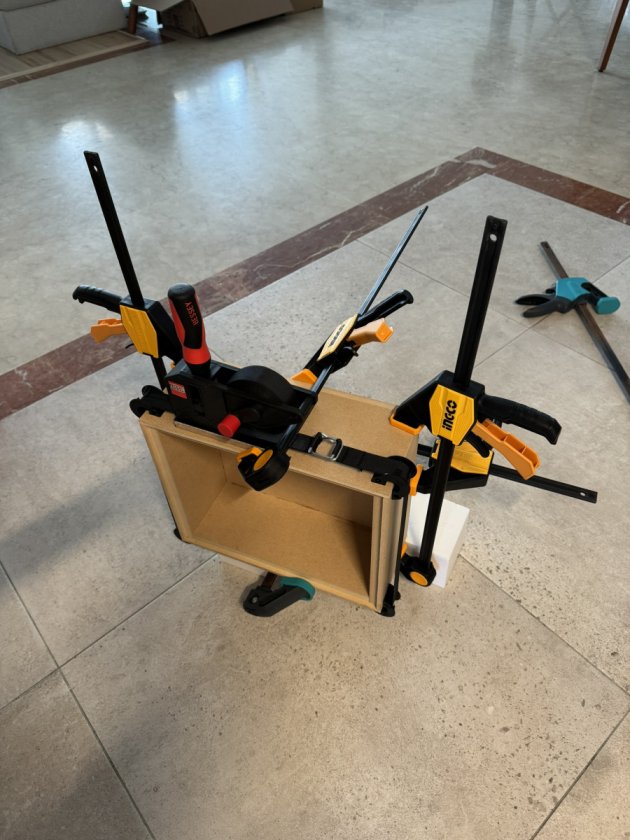

Gluing up the box
In Peter's video of the NX-Studios, he mentions he assembles such that the edge of a panel sticks out past the face of the panel perpendicular to it just a little bit so that he can trim it off afterward with a router bit (screenshot below from https://www.youtube.com/watch?v=CYrdScf9eyM&t=2412s )
However for some reason no matter how hard I tried to tighten my clamps, I wasn't able to get a tiny "lip".

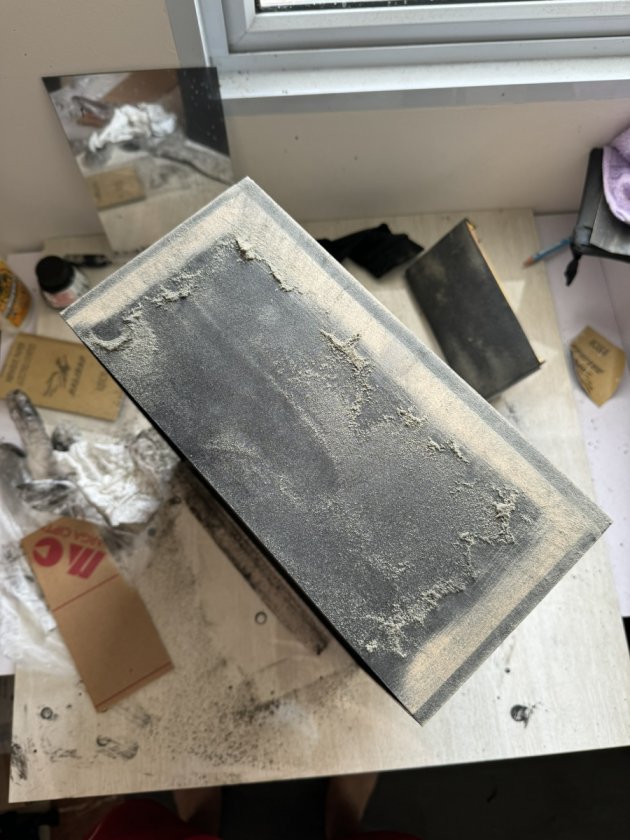

So I sanded the face of the panels to get them flush with the edge of the panel perpendicular to it.

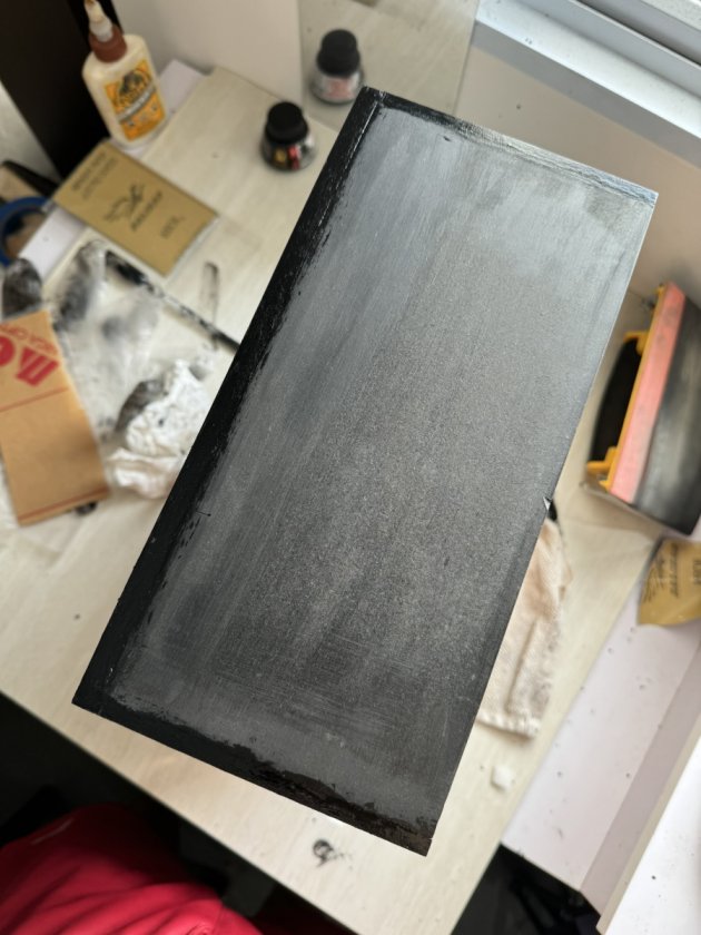

I tried to use the dust from sanding to fill any gaps between panels, reapplied Speedball Super Black India Ink then applied superglue to the gaps (to solidify the gap-fill dust) and panel edges (to seal the thirsty MDF edges).

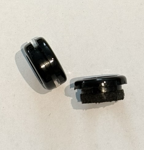

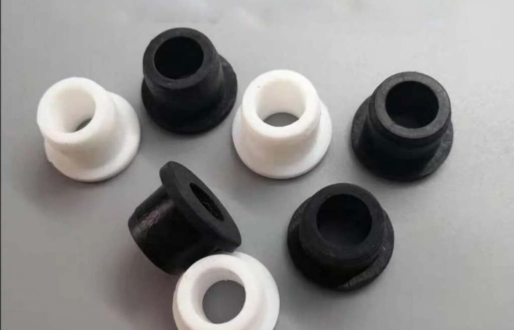

Vince in TX used cable glands in his amp box build: https://www.audiocircle.com/index.php?topic=176852.0
I'd like to use a rubber grommet instead.
It was impossible to find a store selling ones like in the photo above, so I modified the ones that I could find. The inner diameter of the grommet is 9.8mm and the wires from the Rythmik amp, wrapped in heat shrink, juuust fit through. Hopefully in future, Danny and team can consider including a right-sized grommet with the kit  :)
Drilled a hole for the grommet where the wires will exit the box.
Next step, applying lacquer from spray cans!

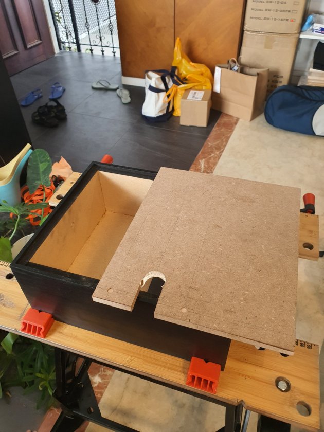

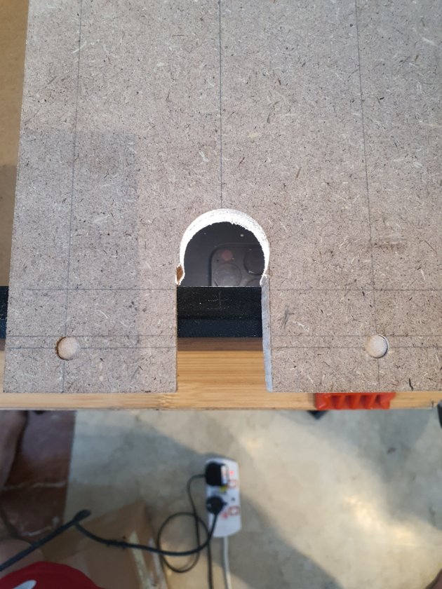

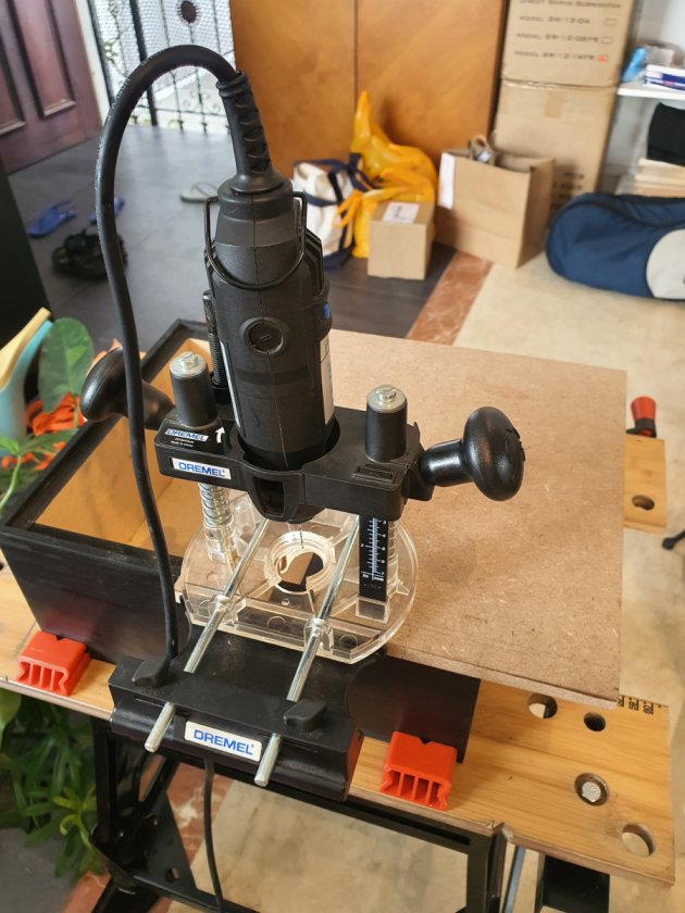

I decided it'd be best to drill pilot holes for the screws securing the amp plate first before applying lacquer.
I was really worried I'd drill the holes slanted so I made a jig. It consists of an MDF board long enough to stradle the box, and a couple of dowel pins as supports to keep it from sliding away.
I cut a slot in the MDF board so I can see the location to be drilled and view where the screw is meeting the wood to ensure I'm drilling in the right place.
Thankfully I have this vertical plunger thing for my knock-off Dremel tool.
Holes done and now on to the lacquer!
timc90
  • Posts: 43
Re: Timothy C's OB Build
« Reply #14 on: 7 Jun 2024, 02:38 am »

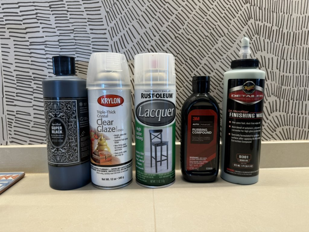

Two coats of Krylon Clear Glaze, wet sand, two coats of Rustoleum lacquer, rubbing compound then finishing wax.
Not quite piano gloss black but close enough for me considering all I have are rattle cans.
Now that I've verified my system of color and finishes works, instead of completing this amp box, I think I'll start on the NX-Studios so I can get to hear some music sooner rather than later.

That looks much nicer than I was expecting. Nice job! Just a heads up on your process, you'll want to let the finish set up and gas off for a week or two before applying the D301 finishing wax. Rubbing compound can be soon after a day or two, just no wax. That will seal in all the solvent trying to escape and cause a blushing (cloudyness) to the finish. Looking forward to seeing how the full project turns out.  :thumb:
timc90
  • Posts: 43
« Reply #16 on: 7 Jun 2024, 05:25 am »
Thanks @nlitworld for the encouraging words and guidance.
Unfortunately I already applied the D301 finishing wax. Let’s see how cloudy it gets. For the subsequent cabinets I’ll be sure to wait a couple of weeks before using the wax.

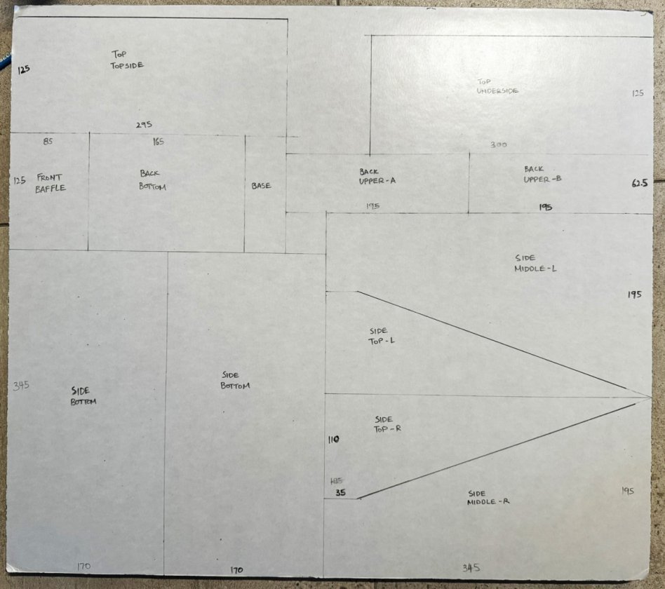

Cutting no-rez really blunts utility knives quick!

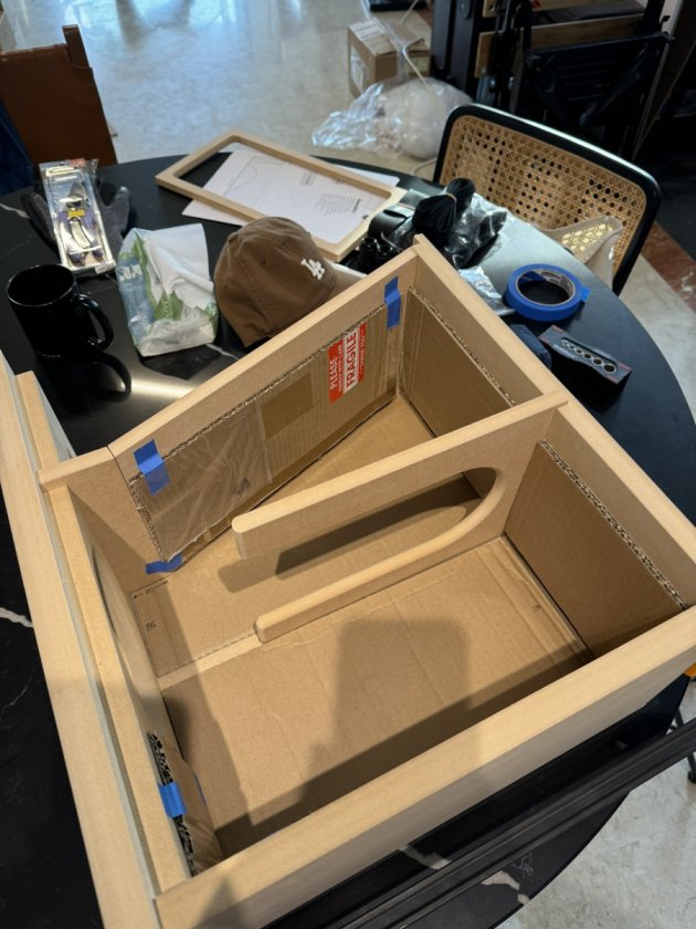

I first used cardboard to do a mock up of the pieces needed to determine the right size of each piece and plan the layout of the pieces on the no-rez sheet to avoid wasting material or worse, running out of material halfway through.
All dimensions are in millimeters:
The side bottom and side middle pieces don't fit through the woofer hole so I decided to paste them on prior to glue up though I know most recommend to paste no-rez only after glue up. Hopefully I don't regret it later.
I also decided to paste on the piece which goes on the inside of the front baffle though that should be easy to paste after assembly.
Next up, reviewing Peter's assembly video https://www.youtube.com/watch?v=CYrdScf9eyM&t=2277s, then glue up!
