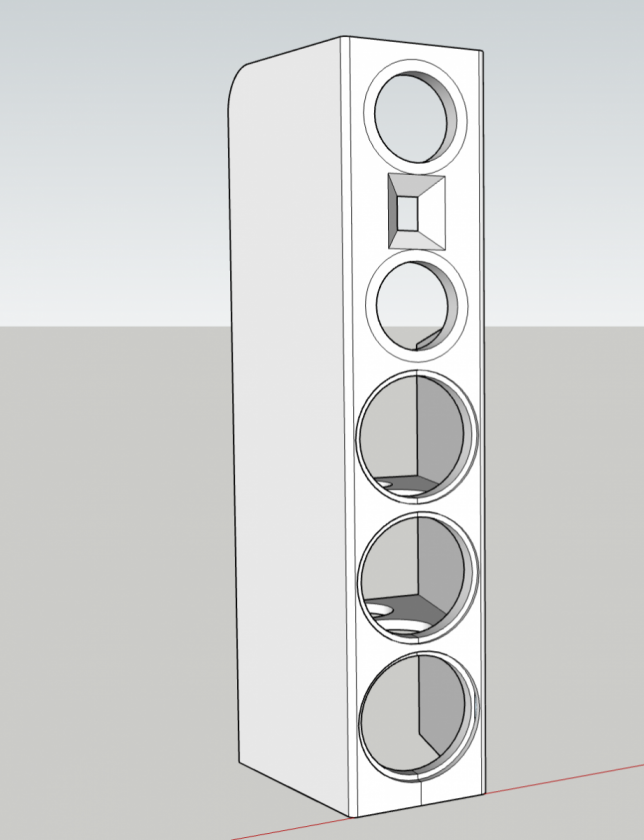

We're working on developing a version of this using 3x 8" subs below the MTM section
here's an older version I've shared in the past:

The 3-8" sub bottom half of that would make a great stand for my NX-MTM kit... and likely more aesthetically pleasing.
One of the cool things about this setup is that, with the 8" subs that can be tuned, you'll be able to give the mid-bass a little "juice", if it needs it.
Out of curiosity, would this be a 2024, 2025, or later release? I’m eagerly paying attention to this project or perhaps the next iteration of the old school lineup.

« Reply #14 on: 22 Mar 2024, 12:24 am »
We're hoping to have them ready by the end of this year, but there are some technical things our CNC guy is working to figure out first.
