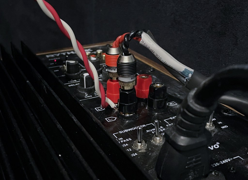

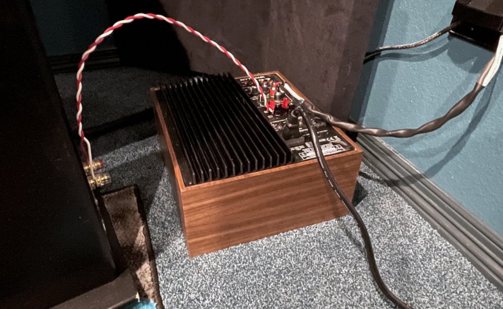

Or you could just run the speaker output direct to the servo subs and then jumper from there to the speakers. I've been running my Double Troubles with my X-Statics like that for almost two years now without issue. Is it ideal? Probably not, but it works.
