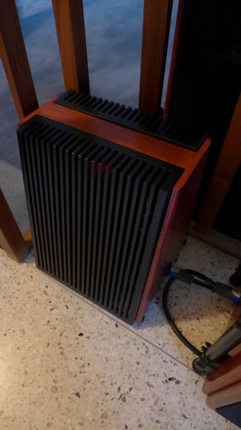

Hi Sameguy,
I agree with doing this. It's cleaner and shortens the wiring.
I also make them completely modular with a spacer/reveal plate that has pass-through spring clips.
Here are a few pictures of what I have behind the Enlighter 4K AT screen.
I can share more info if needed. The design is quite overwhelming.
It took me 3 years to design and build the B&G di-pole line arrays.
I just finished the prototypes a couple of weeks ago.

ebag4
Re: OB H frames Subs with built in amp
« Reply #2 on: 14 Feb 2024, 06:13 pm »
We first saw the use of this bass solution in Danny’s V1 then shortly after the SuperV.  A gentleman by the name of Dave (Tasar on AC) built his amps into the bottom of his SuperVs in a drawer of sorts as I recall.  This link should take you to his gallery showing the SuperVs:
https://www.audiocircle.com/index.php?action=gallery;area=browse;album=5192
I built the amps into the ends of my stereo rack, this worked out well and is still in use today:
Best,
Ed

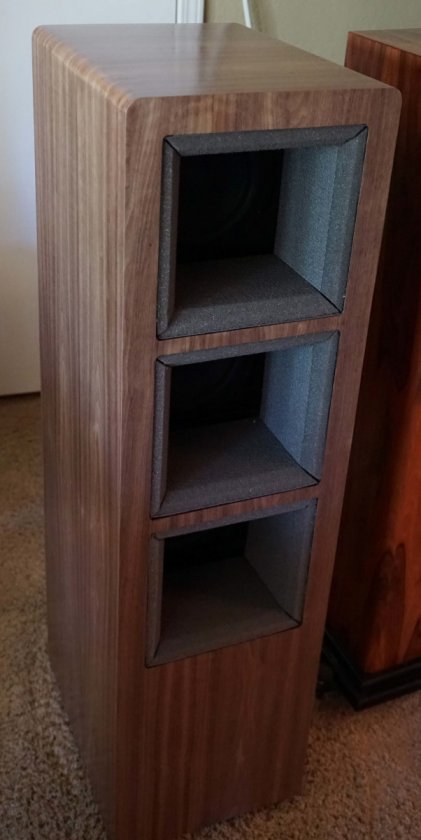

Here it is:
https://www.audiocircle.com/index.php?topic=178148.msg1874195#msg1874195
  • Posts: 11630
« Reply #7 on: 15 Feb 2024, 04:07 pm »
That is super clean.

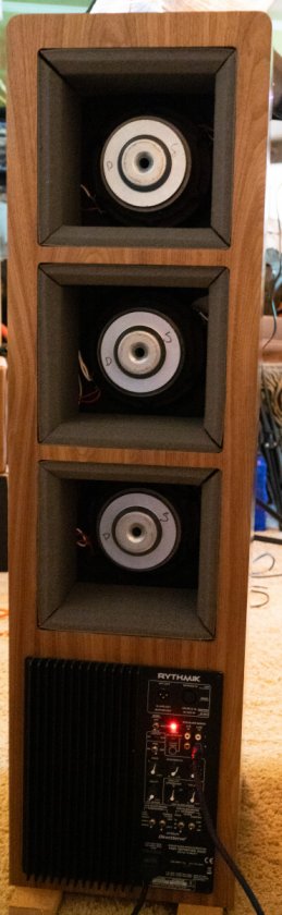

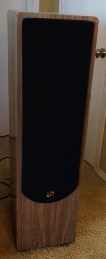

mlundy57
  • Posts: 3643
« Reply #8 on: 15 Feb 2024, 04:31 pm »
Here it is:
That's one of my builds. I'll post more pictures of those, including the back were the amps are this evening.
Mike

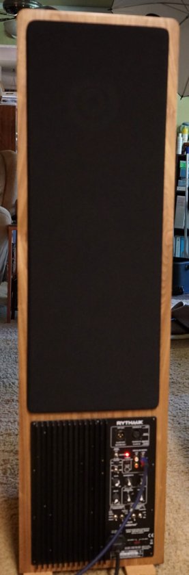

mlundy57
  • Posts: 3643
« Reply #9 on: 15 Feb 2024, 08:14 pm »
It turns out I didn't take any pictures of the back of that pair. Here are front and back pics of another pair.
Be aware that building the amp into the H-Frames like this results in sides that are 60" long. This proved to be a real problem getting 4 identical length sides since my tablesaw only has a 52" rip fence and my miter saw couldn't cut wide enough.  This can result in extra work if everything doesn't line up right. Oh, and cut any dados a little loose. Once you put glue on and the parts swell, maneuvering these heavy pieces into position can be a real pain if things get too tight.
