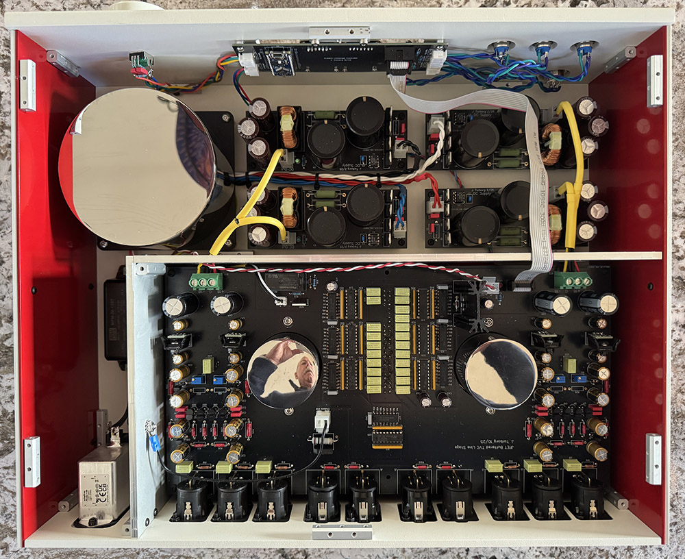

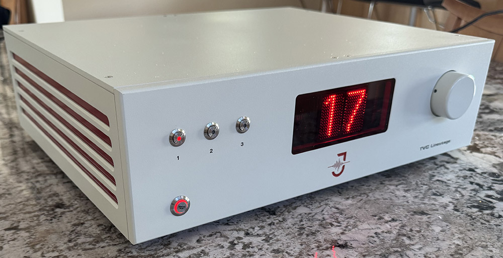

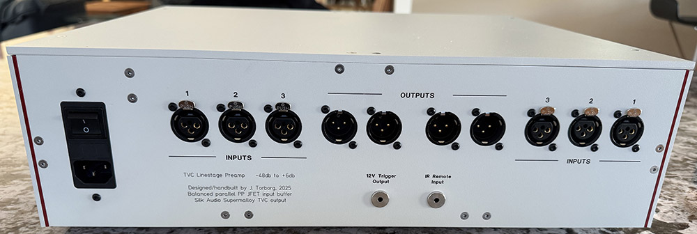

I finally got around to building my TVC linestage. This uses a similar concept as the Iron Pre, but substitutes a transformer volume control for the autoformer in the Iron Pre. I'm using an Arduino to control latching relays connected to all the TVC secondary taps so I can implement IR remote control.

Wow. Super clean build. And nice chassis. It's crazy the amount of hour you must have put in this build. It looks like you design some PCBs (main board, arduino, ...)? Impressive.
Thanks. Yes, I designed all three PCBs (the main board, display board which includes the Ardunio, and the 4 copies of the power supply board). I designed these using EasyEDA and had them fabricated by JLCPCB. This company does excellent work (at least for these relatively simple boards) and is very fast and cost effective (even with the tariffs). It generally takes about 10 days from order placed until they are on my doorstep.
