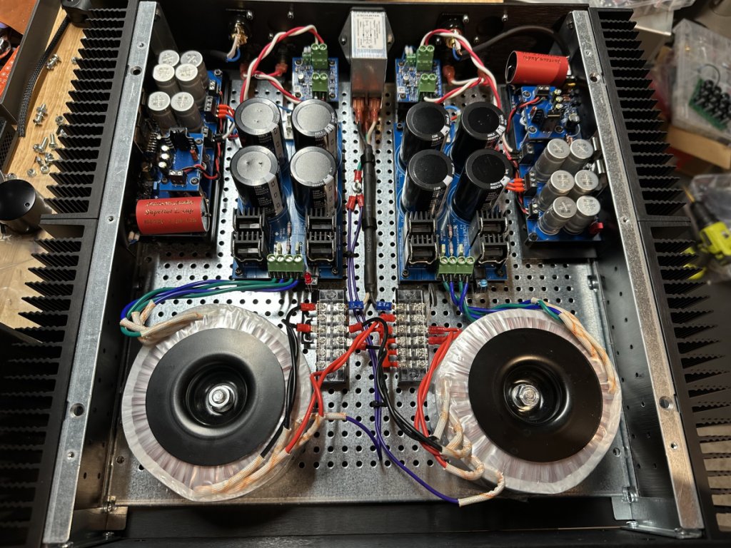

The F5M is great. I have a couple of them, including the F5M Redux monoblocks that run on SMPS supplies.  The quality of the power supply and the wiring makes a huge difference with that amp. Currently using a Neurochrome Power 686 supply with mine and the results are great.

Nice build. Yes, I agree.

These look simple but elegant!

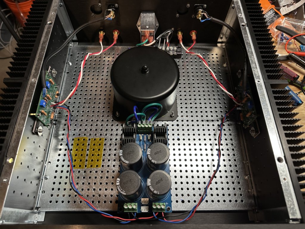

Here is my rebuilt Folsom EC7293. This is probably similar to what Danny’s monoblocks are.

Very nice, Mkrawcz.

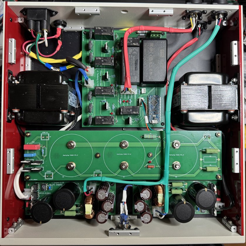

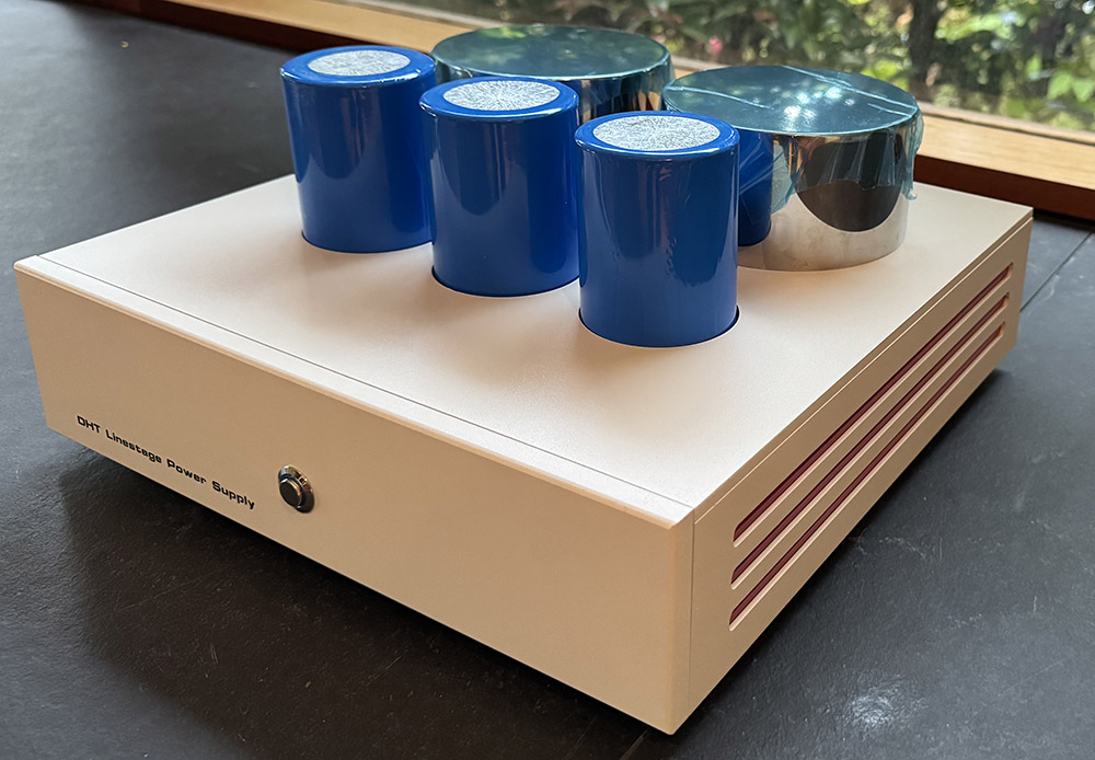

I'll add another little bit of eye candy - work in progress.
I'm working on a new DHT line stage. This will be a two chassis build with the power supply in one chassis and the input selection, attenuator and amplifier circuitry in the other. I've still got a ways to go, but I hope to finish in the next couple of months. I've got the power supply chassis mostly done - photos below. I still need to add a couple of connectors, and I think I am going to paint the main power supply caps the same color as the red inner side panels (after removing the blue plastic) and put a nice topper piece on each. I may also lower them a bit further into the chassis.
The main B+ supply is a choke input supply with four stages of filtering LCLCRCRC with the last RC split between the channels in the second chassis. All using ClarityCap polypropylene film caps.
I'm working on an Arduino controlled relay input selector and stepped attenuator. The line stage circuit will use a Emission Labs 20A DHT with a Lundahl choke anode load, filament bias using a Rod Coleman regulator, and parafeed Lundahl step-down output transformer.
DHTs are the most linear amplifying devices available with almost exclusively even harmonic distortion, but they are also fairly susceptible to microphonics. The EML tubes are much better than most, but a lot of care must be taken to reduce vibration. So the tubes will be mounted on their own little subchassis with sorbothane dampeners.

Wow! I bet that will be magic with the 300b amps. A good tube preamp build is probably next for me after I finish building my Honey Badger amp.

Jay, your custom work is absolutely stunning. Very well thought out and incredibly meticulous in the details. Drool worthy for sure. You definitely set a high bar for others to measure against, and that's the diy crowd and manufacturers included.  :lol:

Thank you. Yeah, I'm looking forward to hearing how it sounds. I've read a lot about other builder's (both commercial and DIY) DHT line stages which sound very intriguing.
Thank you. That's very kind of you to say.

Hey Jaytor I am asking a question from someone who doesn't have much knowledge at all about electronics.  Can you take this choke power supply and connect it to anything that needs an external power supply to make it better such as a DAC or streamer etc.  I am having a preamp built with an external power supply.  The builder said it would cost thousands more to add chokes to the power supply.  Is this because of the chokes or does something have to change inside the preamp.

The power supply should be designed with the specific application in mind. It's possible that a given power supply would work with a different circuit, but it really depends.
The specific chokes used need to be determined based on the current requirements. The chokes I used in the power supply are not terribly expensive. They are Hammond 193C which cost about $65 each. They are 20H chokes rated at a maximum of 100mA.
These are decent quality chokes, but you can certainly spend more money. For a power supply choke, I'm not sure there is much benefit though. For the anode chokes in the audio circuit, I am using Lundahl chokes which are considerably more expensive at around $260 each.
A choke input supply means that the rectifier feeds directly into a choke without a filter cap before it. This requires a higher voltage transformer to deliver the same DC output voltage. The DC output after the first cap (following the choke) is approximately 0.9 times the RMS voltage of the transformer. A capacitor input supply (where a cap is used right after the rectifier) has an output voltage of approximately 1.4x the transformer RMS voltage. So a different and potentially more expensive transformer must be used for the same output voltage. Also. the rectifiers will need to handle the higher AC voltage.
The advantage of a choke input supply is that the current spikes are significantly reduced so there is less EMI and less noise to filter out, but it is a bit more complicated to design. Fortunately, there are good simulation tools that can help get you most of the way there.
Chokes can also be used in a capacitor input supply after the first cap. This will still provide improved filtering compared to a resistor, but not quite as good as a choke input supply.
Chokes will take up a lot more physical space than a resistor though, so this may require a different enclosure to fit everything.
