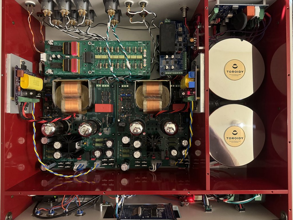

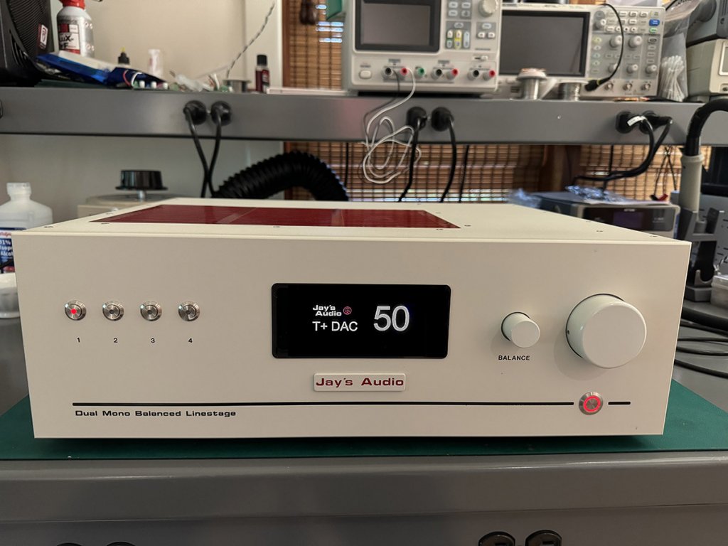

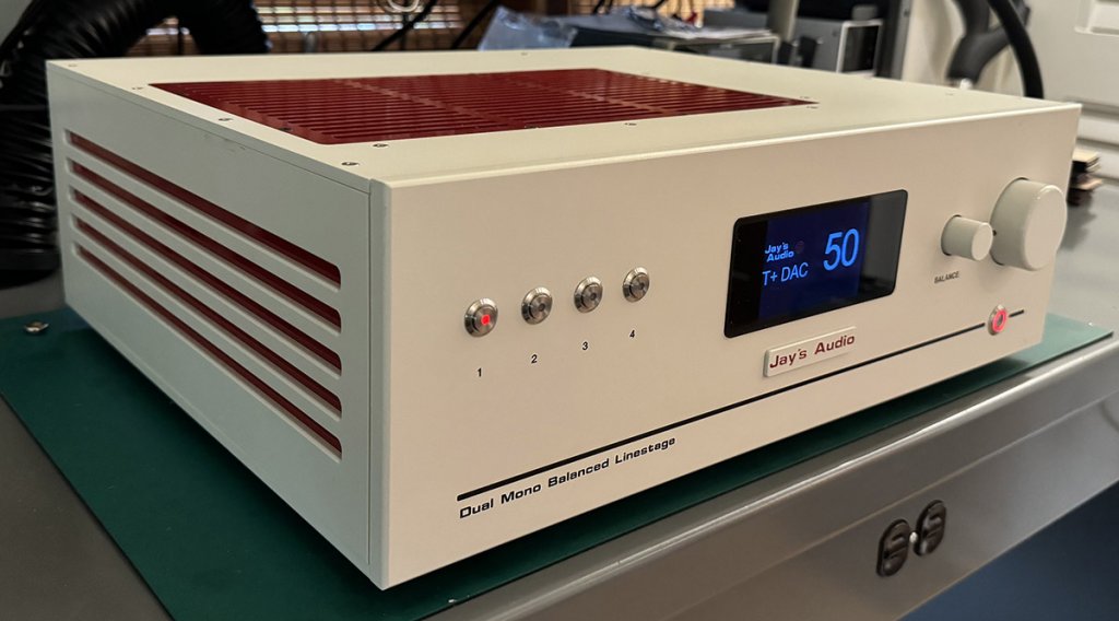

I am finally finished (at least for now) with my new preamp build. I started this project almost three years ago, and have built five different circuits for the tube line stage - the first two being John Broskie's Aikido designs, and the last three being my own designs.
This build is a fully balanced (differential) design. I'm using relay-based input selection and a balanced relay-switched stepped-attenuator. These are implemented using AMB.org delta 1 and 2 boards, but the control is done with an Arduino processor with my own software so I could use a TFT display and custom IR remote control. The code also controls power sequencing and an output trigger for my power amps.
The stepped attenuator is implemented with Vishay Z-foil series resistors and Audio Note silver tantalum shunt resistors.
There are actually two separate line stages - one is opamp based using AMB.org alpha 24 (A24) boards to drive my woofer towers, and the other is my own differential tube design. The A24 boards are powered by a Neurochrome Preamp power supply which provides a very low noise +/- supply.
The tube circuit is powered by independent custom Toroidy transformers for each channel, fed with a Neurochrome Smart Soft Start. The transformer outputs are filtered with a CRCRC circuit which then feeds a shunt regulator based on DIYAudio contributor Salas's SSHV2 circuit and implemented with my own custom PCBs. The shunt regulator voltage is 200V and is set up to supply ~28mA for the tube circuit.
The tube line stage that I finally settled on uses a pair of 6SN7 tubes, each with their sections paralleled, in a differential circuit. The cathodes are loaded with independent cascoded BJT current sources, with a resistor tying the cathodes together. This allows me to optimize the DC balance and reduce the gain a bit (to 13db) to better match the rest of my system. The anodes are loaded with a Lundahl LL1660 push-pull output transformer with a Nanocrystalline core in a 2.25+2.25:1 configuration. This circuit uses no global feedback.
Is that Attenuator in the second picture a really high end attenuator?  It is the same that is used in a preamp I'm looking at purchasing.

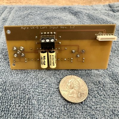

"How is this amp different than some other solid state amp, besides the marketing materials?"
Notwithstanding any of that, if you want something turn key, that will sound incredible... pickup a QX-5 Twenty and VX-5 Twenty.  I think both can be had for ~$10k (used / finding deals) and it can be end game stuff - I think the VX-5 Twenty is that good.  The VX-8 may also be a great fit, but if you have interest in QX-5 Twenty, I'd get it.  Also, and mentioned before, the VX-5 Twenty (and VX-8) has modules available you can insert for High Pass.  It's a very small cap value.  Vandersteen does this with their speakers and likes Ayre equipment.  They use 100Hz, but I'm sure Ayre will put whatever you want on there. In fact, might not be a bad idea to contact Danny about those small Sonicaps he has.  I have 2 different pairs of them from Danny to target 100Hz and 160Hz - in case I wanted to use an outboard box.  I think Danny likes the high pass under 100Hz, so I'll probably pick up a batch to try that as well.
This is the high pass module. You'll see the value is .0015uF, which yields 100Hz. That's because the input impedance of several Ayre amps is 2Mohm (balanced) - 1Mohm per leg.  So, the cap can be very small and a high quality cap is very affordable.

wow.  Stunning quality and build!  I sure wish I had those skills.  Beautiful work.

Jay, that is phenomenal work. Did you DIY your own case as well or was the main enclosure something purchased? That almost looks like a PC case but not quite.

Jaytor
Re: Solid State or Tubes with your NX-series speakers?
« Reply #174 on: 27 Sep 2024, 03:18 pm »
Thanks guys. This project took a lot longer than expected but I learned a ton and had a lot of fun. It's given me a lot more confidence to do my own circuit designs.
I designed the case, but had the panels fabricated by Front Panel Express. I don't have the fabrication and finishing skills that you and others on this forum have, but I can use a CAD program and pay someone else to do it  :D.
