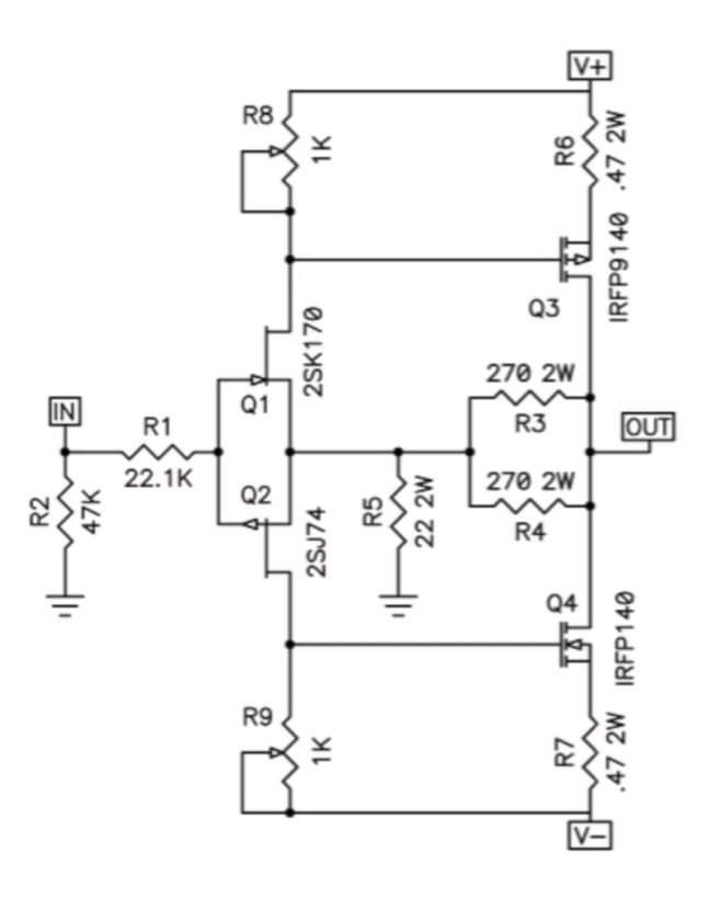

Nelson Pass introduced a new design variant of the F5 at Burning Amp last year. He calls it the F5m, I think the m standing for "minimum cost" or something like that. It is a very simple circuit that is more second harmonic prominent, and has no capacitors in the circuit. Here's the schematic of the basic circuit.
There will be a kit available on diyaudiostore.com, expected in the next week. This would be a great design to start with.
I am working on a build based on this design, using my own custom PCBs. My design adds some additional features including a DC Servo circuit, an optically coupled speaker protection circuit, and a balanced input. I'm building two stereo amps to try biamping my Line Forces.

I don't think I want to sell PCBs, but I'd be happy to provide the gerber files so you can order your own. My boards are four layer with a full ground plane, so they are a bit more expensive. With the options I used - 2oz copper for all layers, 1.6mm PCB thickness, HASL surface finish, they cost about $100 for five boards from JLCPCB.
With the additional features I added, this design will be a bit more expensive than the base design that will be offered by the diyaudiostore, particularly if you populate the Jensen transformer for balanced operation.

I am not a fan of the original F5.  It was the worst sounding of all the First Watt amps I'd heard.  It was as close to a Bryston type sound that Nelson ever got.
Yeah, I wasn't that happy with the original F5 sound. This design seems to have a different distortion spectrum so I'm hoping it sounds more to my liking.
