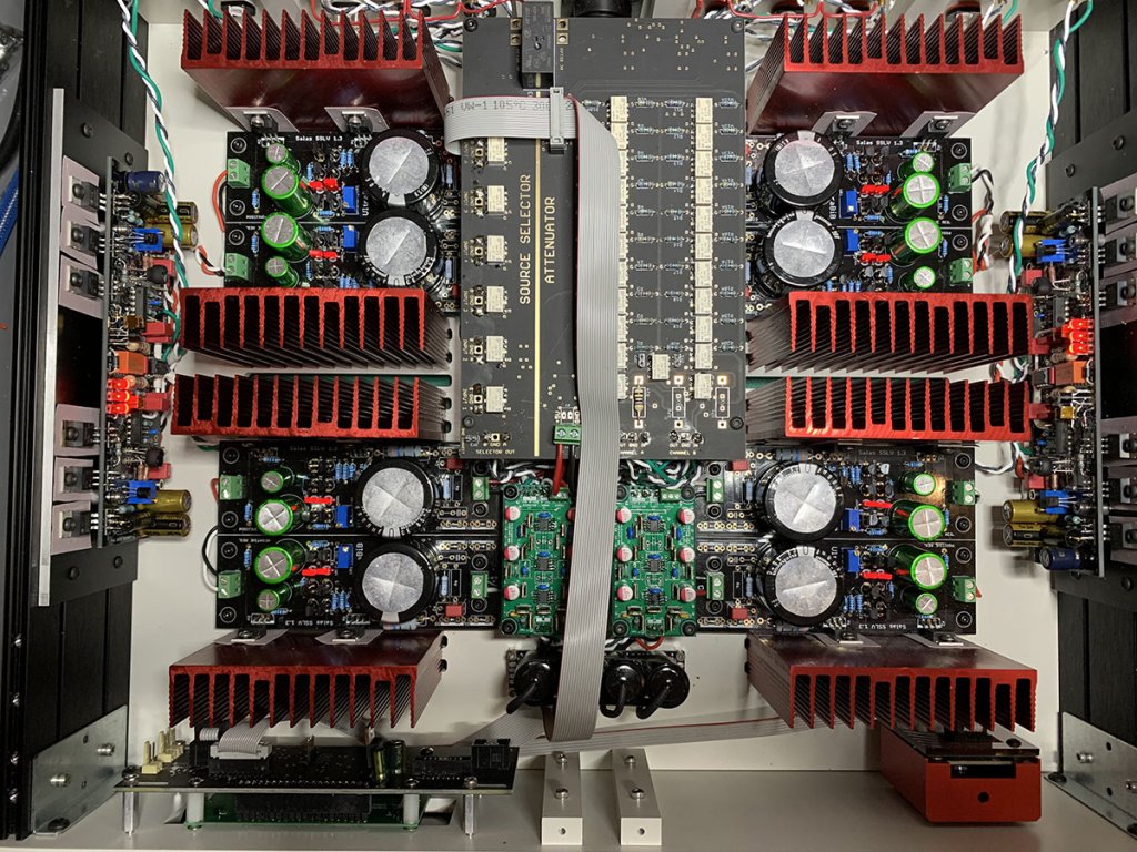

Jaytor
Re: Solid State or Tubes with your NX-series speakers?
« Reply #145 on: 10 Apr 2024, 12:59 am »
Yea, it got better. :D This is the perfect amp to get into diy due to its simplicity and price. It also happens to be a true giant killer.
I'm looking forward to getting mine finished. I had knee replacement surgery last month which unfortunately got in the way of my electronics projects. I did a second rev of my PCBs to fix a problem with a relay footprint and improve the DC servo design, and finished assembling one channel this past weekend. It seems to work well (checking on the scope), but the proof will be getting two channels hooked up to some speakers.
I'm building two stereo amps to be able to use them to try bi-amping my Line Forces with active crossovers.

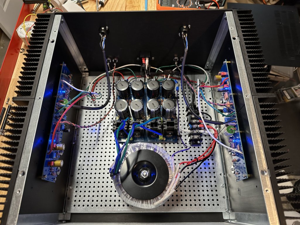

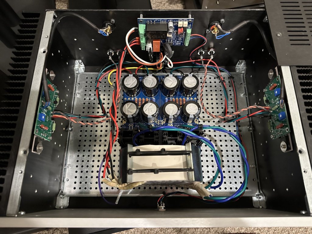

Here is my reworked F5M in a smaller chassis with a Diyaudio universal power supply. I have the amp bias all the way up and it sounds great.

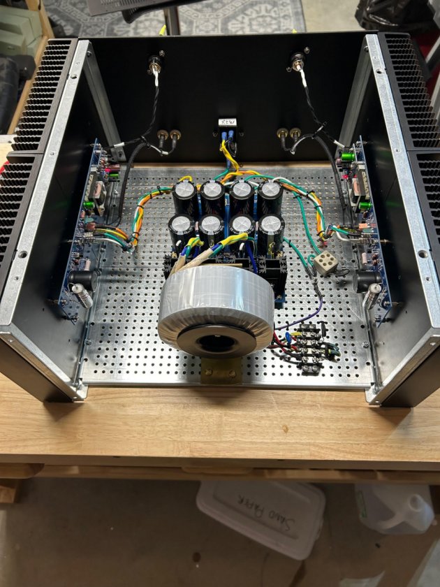

And here is the AlephJ which will become an M2X this weekend if all my parts get delivered. For SS DIY, I can’t imagine anyone not loving them on something like NX-Oticas.

Really nice build!!
I just finished the M2X Sunday and it sounds really good with the Mt View daughter card on the NX Studios, super fun build!

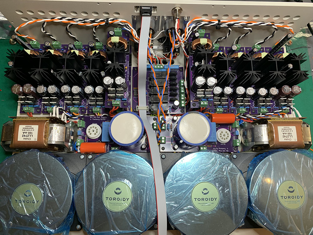

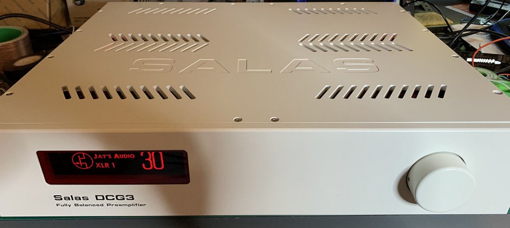

I'm currently using a DIY solid state preamp that uses a pair of AMB.org A20 line amplifiers in a balanced configured, powered by Salas UBIB shunt regulators. A balanced Khozmo stepped attenuator is used for volume control.
I am working on two new preamps. The first has gone through several iterations, and I'm almost done wrapping it up. It uses a balanced stepped attenuator using the AMB.org relay boards with my own Ardunio processor and code for control. The line stage uses a shunt regulated power supply (my own PCBs with a circuit based on the Salas SSHV2) and two 6SN7s in a parallel long tail pair (for each channel) with a cathode current source and a Lundahl balanced line output transformer.  I originally started out using an Aikido design but decided I liked my design better.

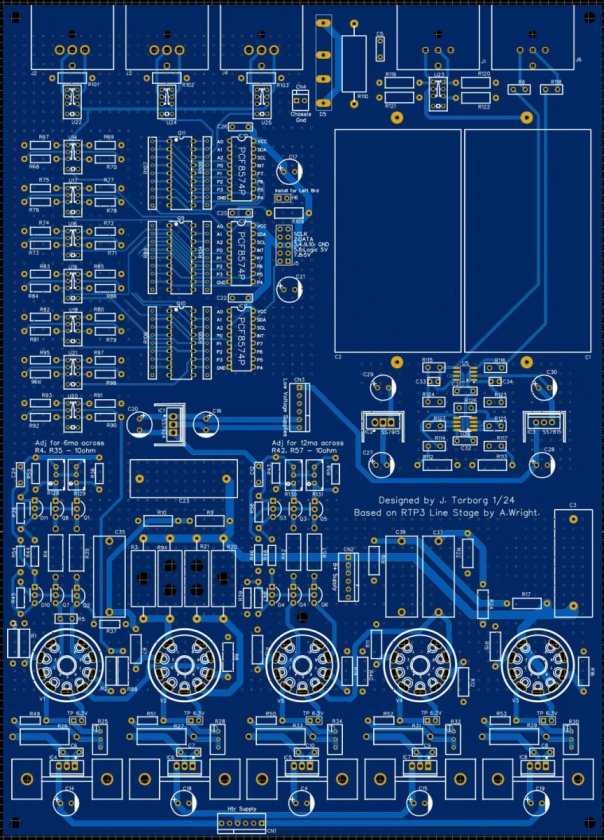

The second is a two chassis design loosely based on the Vacuum State RTP3D. I've finished the power supply (which also has the Arduino control). I've fabricated the line stage PCBs (which include the input selection, stepped attenuator, and line stage circuitry) but haven't started the build yet.
The second chassis will use two of these boards with a pair of shunt regulator boards in between.

WOW.  You lost me at this is what I'm building....lol. The first looks nice but the second looks very stout.  WOW.  You lost me at this is what I'm building....lol. The first looks nice but the second looks very stout.  Is that Attenuator in the second picture a really high end attenuator?  It is the same that is used in a preamp I'm looking at purchasing.
