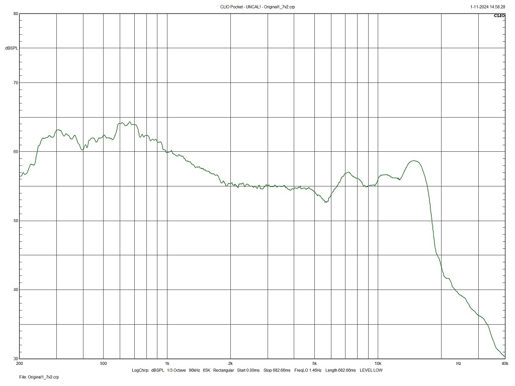

Measured the correctly working speaker setup for measurement with the original passive crossover and here is the frequency response plot on center of the vertical tweeter axis.
Once I have the second speaker repaired, will do a comparison frequency response plot.

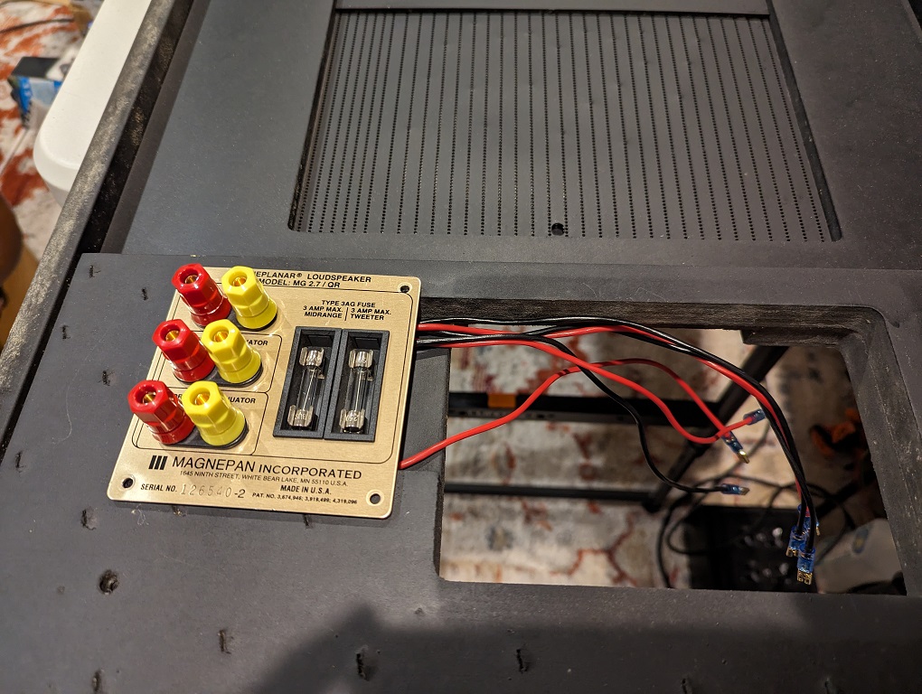

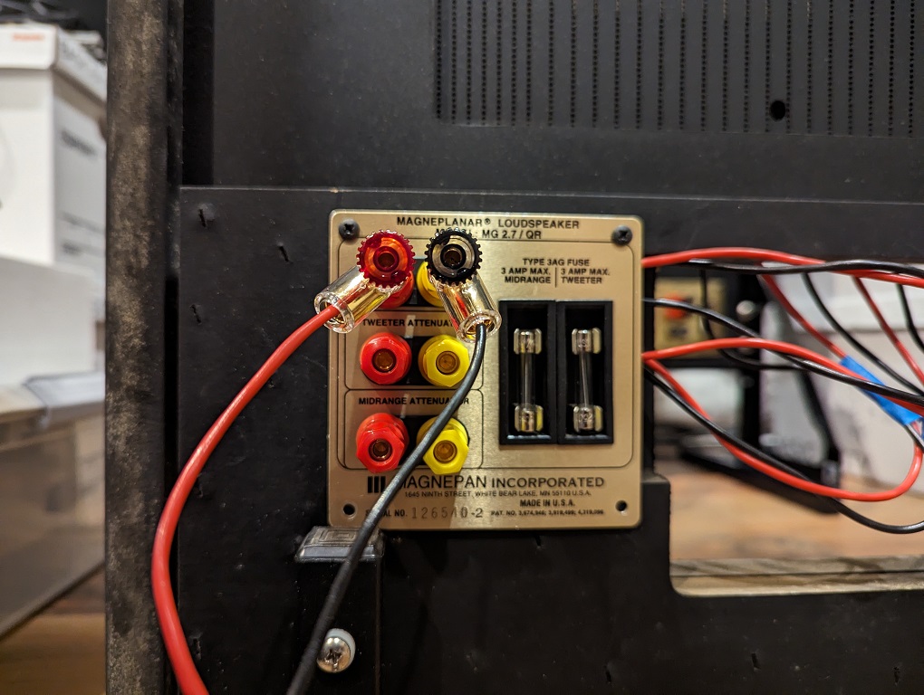

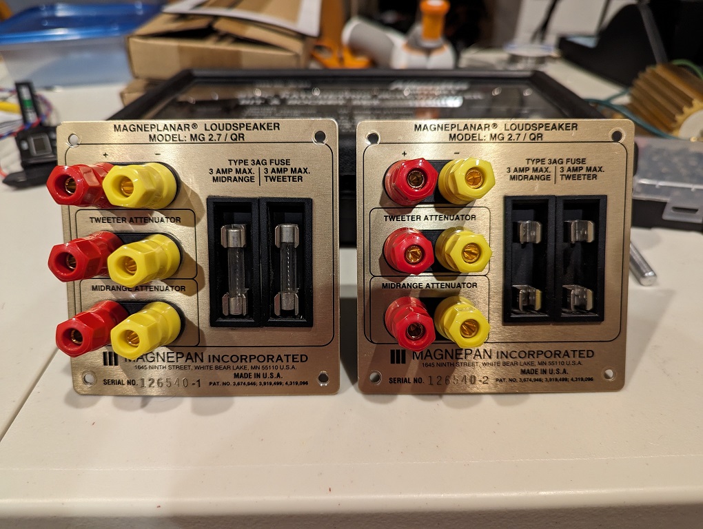

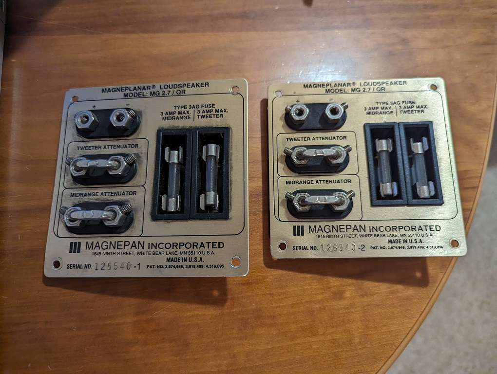

Talked to Magnepan and was able to get a pair of used 2.7/QR speaker connector plates to rewire the 3-way 1.7 planar speakers for direct amp drive.  I can also rewire the fuses to the tweeter and super tweeter for protection.
These connector plates will have the 6 new Superior Electric BP30-10 5-way binding posts for speaker wire connections.  :)

The plot shown is with a super tweeter operating???

If the speaker is working correctly, then yes.

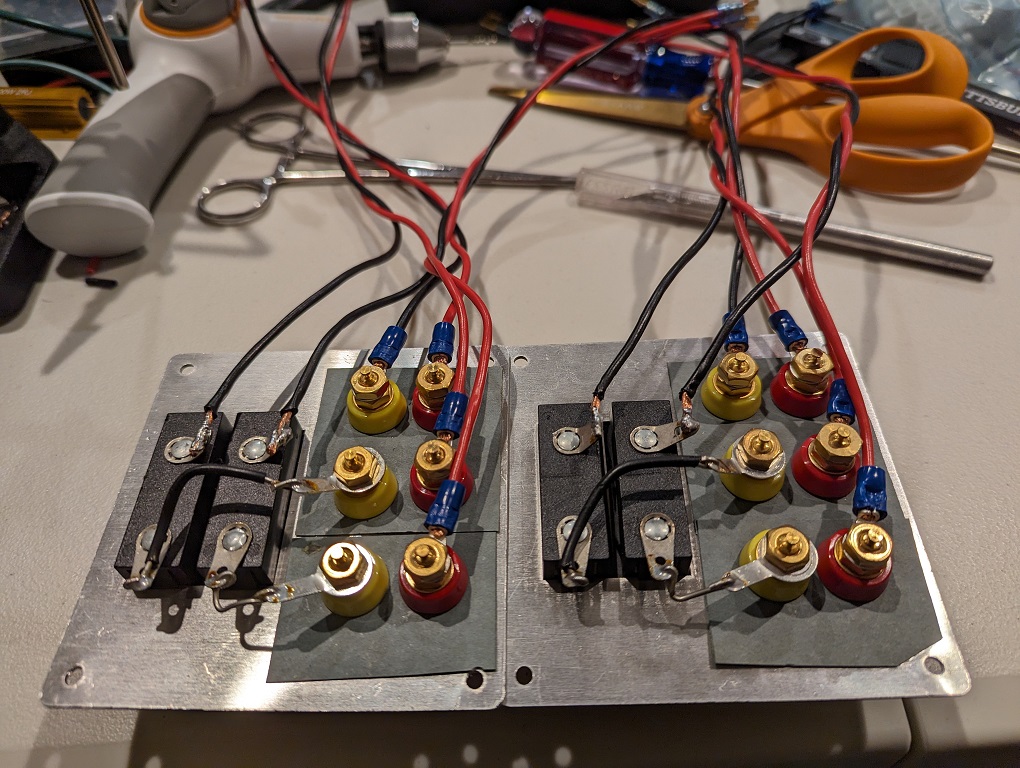

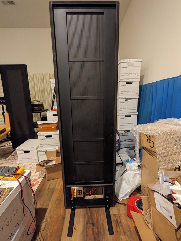

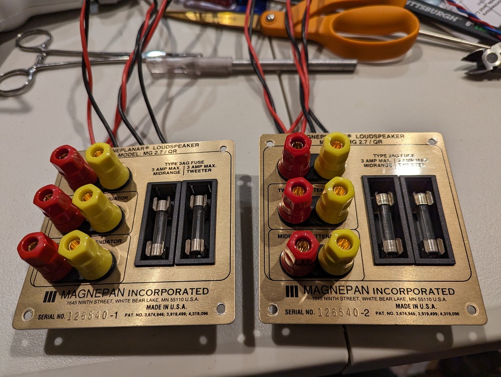

Modified the new connector plates with the Superior Electric BP30-10 5-way binding posts.
Next is to rewire the fuses to the tweeter and supertweeter planars for protection.
Hard to find the black 5-way connectors, so went with yellow for the negative terminals.

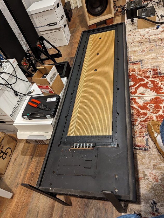

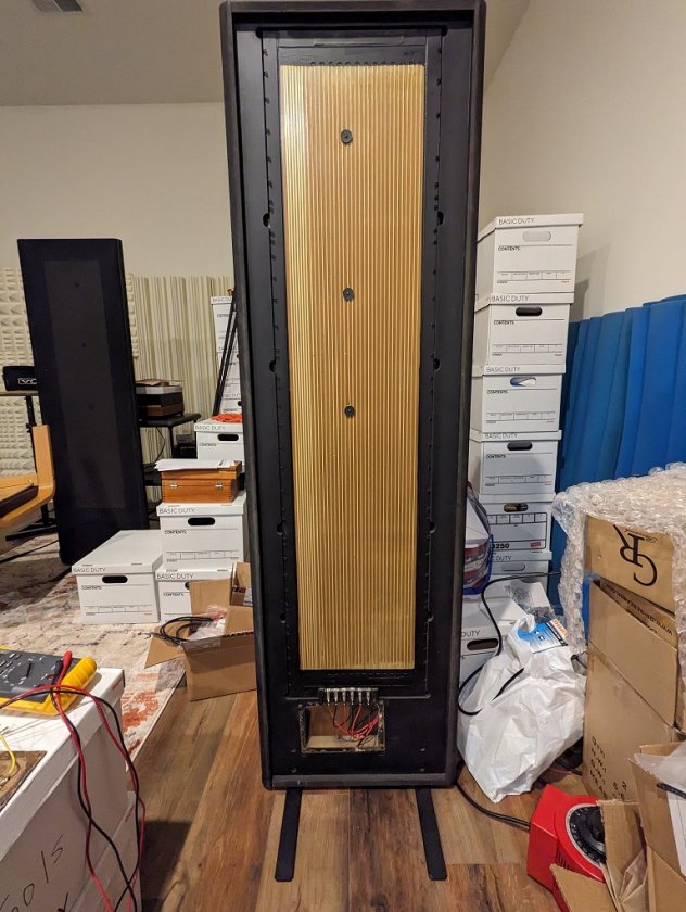

The quasi-ribbon foil repair kit has arrived and have the side stiles and sock removed to work on the 1.7.  No obvious burns or breaks in the foil, so have to remove the adhesive to investigate the open foil of the supertweeter.

Have the side stiles off and the sock removed from the 1.7 with the open super tweeter foil.
No obvious breaks in the foil, so have the foil repair kit for the 1.7's with the other pieces needed for replacement of that winding with instructions.

New connector plates wired for 3-way use for the Magnepan 1.7 speakers.
Disconnected the original passive crossover in the 1.7's and will install the new connector plate in the speaker with the open super tweeter for testing.

Have rewired the 1.7 with the open supertweeter to 3-way direct drive.
The original passive crossover is removed.  Will replace it with a cut piece of board screwed into the baffle to cover the opening.

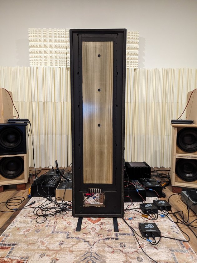

Back from the Florida Audio Expo and to work on the Magnepan 1.7's.

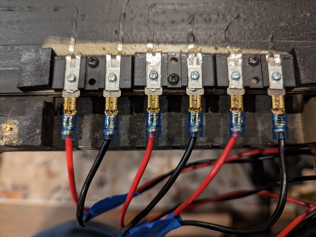

Took the second panel apart to rewire the planar drivers for 3-Way direct to the connector plate.  Removed the original passive crossover and getting the wiring to the planars connected.

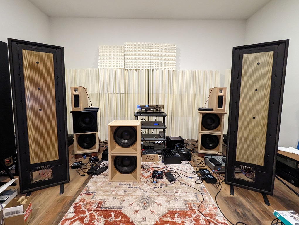

The second 1.7 is now wired for triamping.
The dspNexus 2x8 will be driving 3 channels of Parasound A23 stereo amps for testing with Audiomatica's CLIO Pocket.
Checked the planar resistances and they are as expected for values.  Just the first 1.7 has the open circuit super tweeter, but the tweeter and woofer are working.  With the original series style passive crossover, with the super tweeter open circuit, the tweeter did not function as well as the super tweeter.

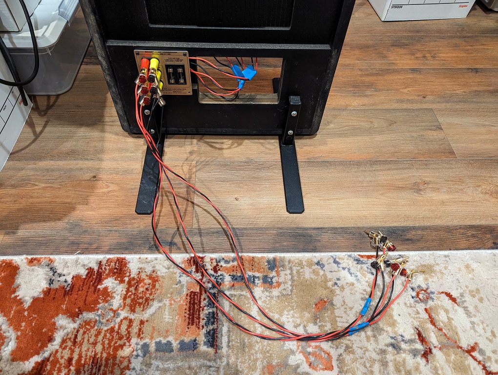

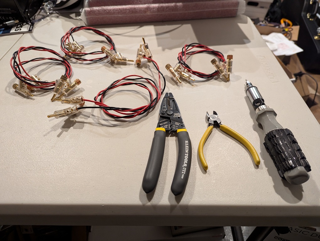

The 1.7's are wired with locking banana plugs for testing the individual planar drivers.
Will be using the Parasound A23 to drive the planars for frequency response measurements to design the DSP crossover.

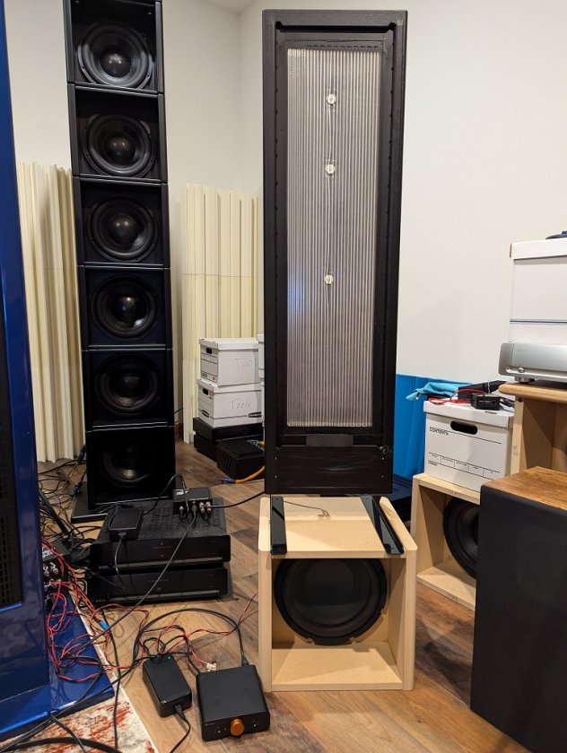

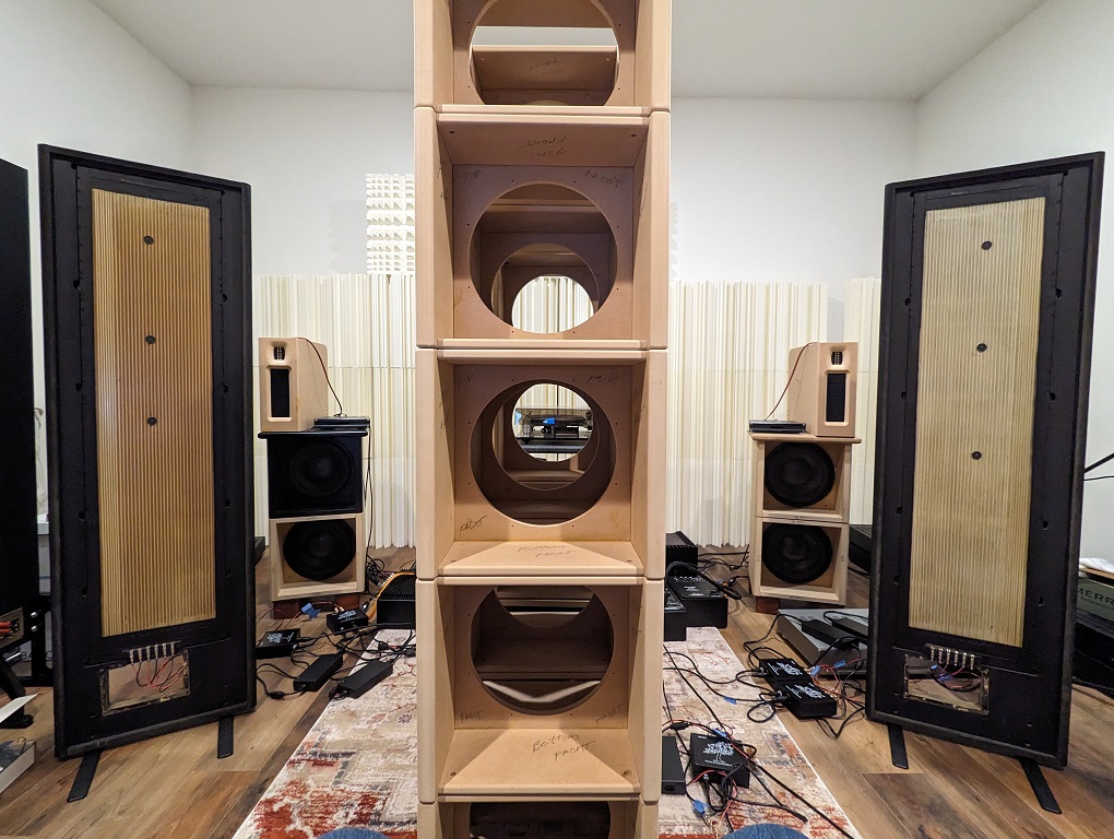

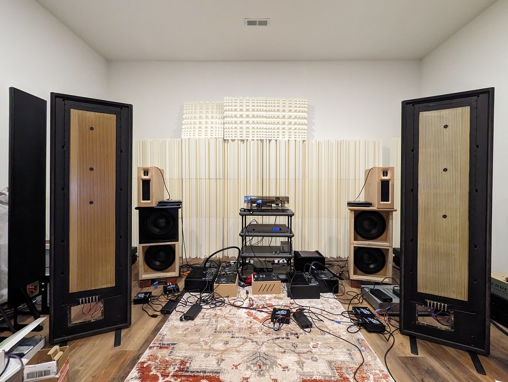

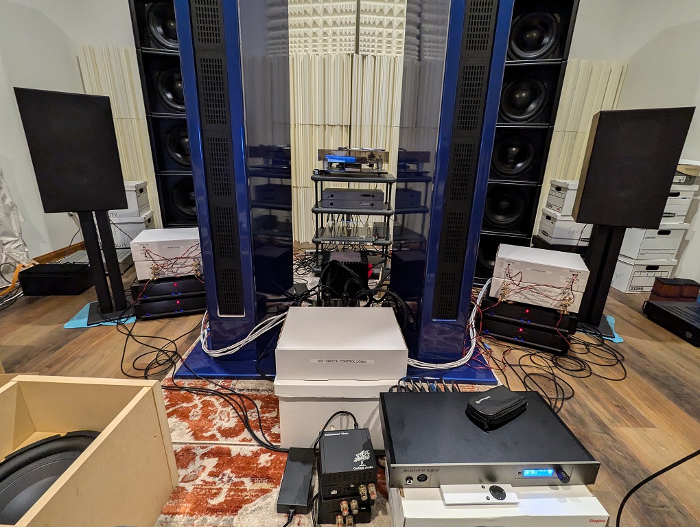

The Magnepan 1.7 with the dspNexus 2x8 DSP crossover is now running.  This is the speaker with all three planars working for measurements.
From the passive crossover design and first measurements, the DSP crossover is working.  Now to make individual driver measurements to fine tune the crossover.   This is nothing like the original passive crossover in design.
The three Orchard Audio Starkrimson Monoblocks with the upgrade 300W GaN SMPS are triamping the planars with the 2x12 in servo sub on the left.
The super tweeter is padded with a resistor since its resistance is 1.4 Ohms.  This makes it an easier load to drive for any amp.

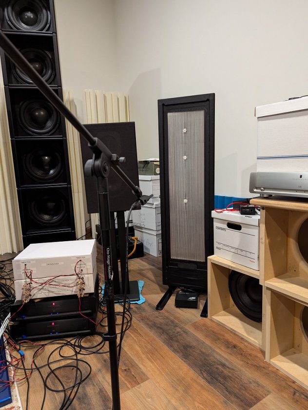

« Reply #17 on: 26 Mar 2024, 03:17 am »

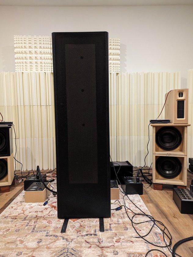

The Magnepan 1.7's are playing music.
The super tweeter ribbons are disconnected since the one in the left panel is open circuit.  Running the tweeter panel 400Hz and up.  Sounds pretty good to me even without it for testing.
The speaker is EQ'd for flat response.  That can be varied to taste.
The planar woofer to tweeter time offset is corrected as is the servo subs to the planars time delay.
The dspNexus with the AKM AK4493 DAC's are running now.  Just updated the firmware in the EA dspNexus 2x8 with the AKM AK4499EX DAC's and will be swapped in tomorrow for listening trials.
This is the fun part!  🙂

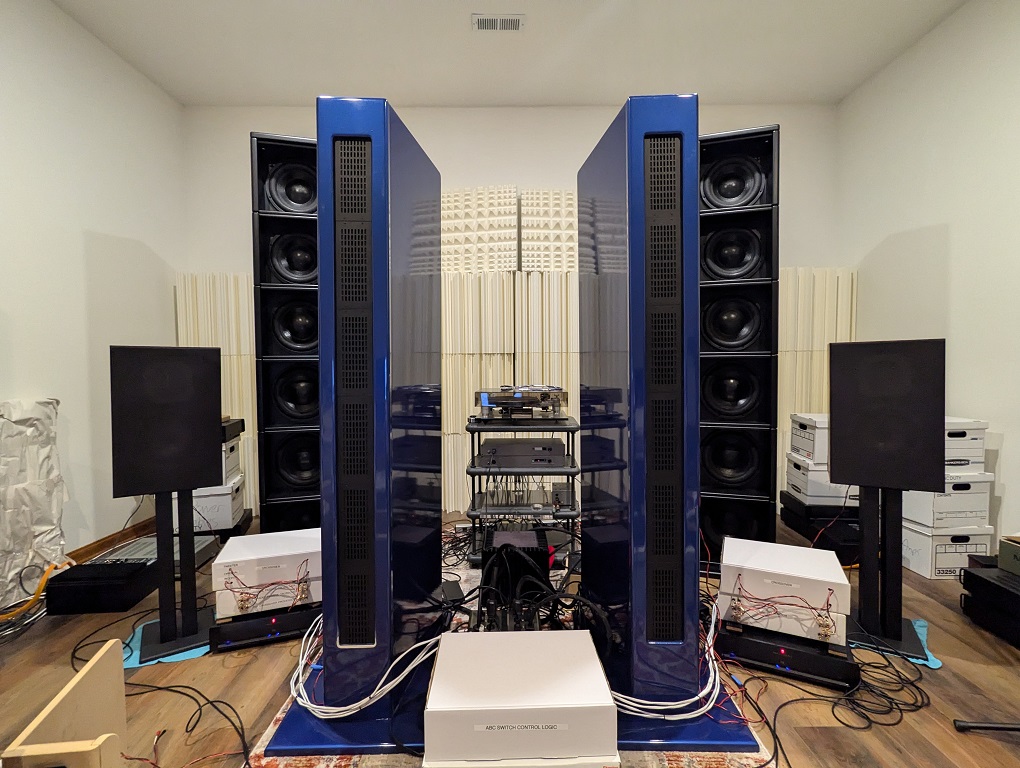

Have the Flagship EA dspNexus 2x8 with the AK4499EX DAC's setup in the Magnepan 1.7 system with the Orchard Audio Starkrimson Monoblocks and 2x12 OB servo subs.
This is an improvement over the standard AK4493 DAC's.  This is the final version of the AK4499EX DAC board since the first version used the single chip AK4499 DAC that is no longer made.  These are the two IC version with the digital processing and analog processing on different IC's.
The new modular OB servo sub cabinets for the two 6x12 stacks in the picture are going to painting this week.  Then install the 12 GR-Research SW-12-16FR servo drivers and wire them up into the system.  Will be using Rythmik Audio 4-HX300-12OB servo amps for the system all controlled by the dspNexus 2x8.
