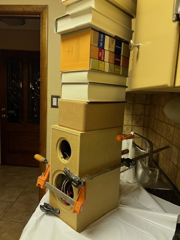

Time to assemble.  Having a lot of clamps helps.  I only have this many, so I could only assemble one speaker at a time:
All clamped up:
All dry.  But if you notice the top (and side) edges stick out:

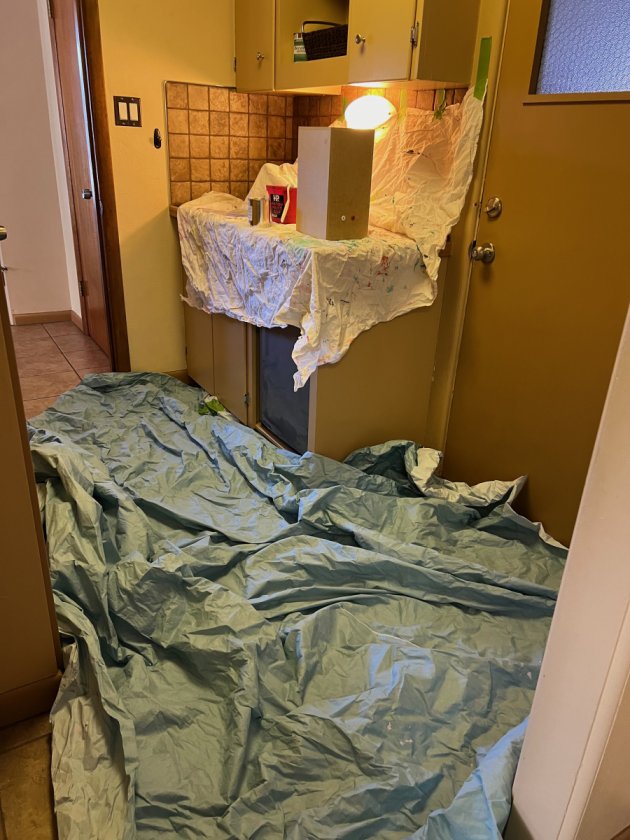

We had some throw cloth from the last time we painted some rooms in the house and we just re-purposed them here:
Painted all around the top of the speaker.  Can't paint the bottom yet because it would smear everywhere:
