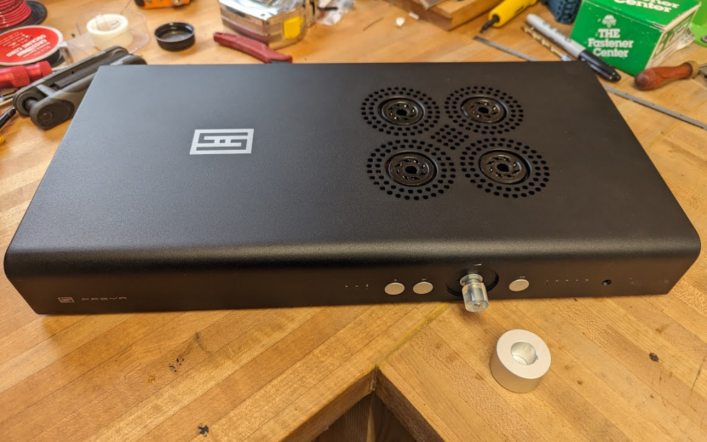

OK, time to crack this puppy open.
Step 1 = Pull the volume knob, it just pulls off. Then remove the plastic knob gromet. Then remove the volume pot nut and washer.
Presb4
  • Posts: 159
Re: Schiit Freya+ Cap and Resistor Mod
« Reply #21 on: 14 Jan 2024, 02:45 am »
Now, if you use tube socket savers like I do, you will need to remove them. I use socket savers to save my sockets from wearing out and to lift the tubes out of the casing to lower the internal pre-amp temps.
You need to remove them so you can slide the cover off. This can be a real pain and after messing around I found that this "L" pick worked great. Just angle it a bit and slide it down inside the tube socket key way and hook the underside of the socket saver and pull up. They pop right out.

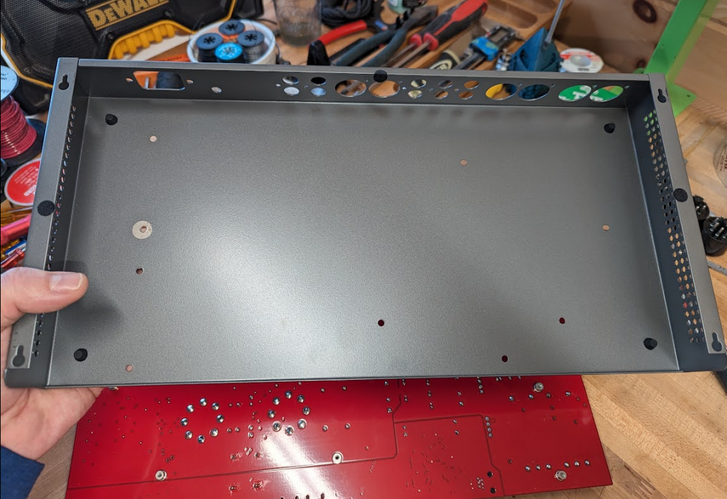

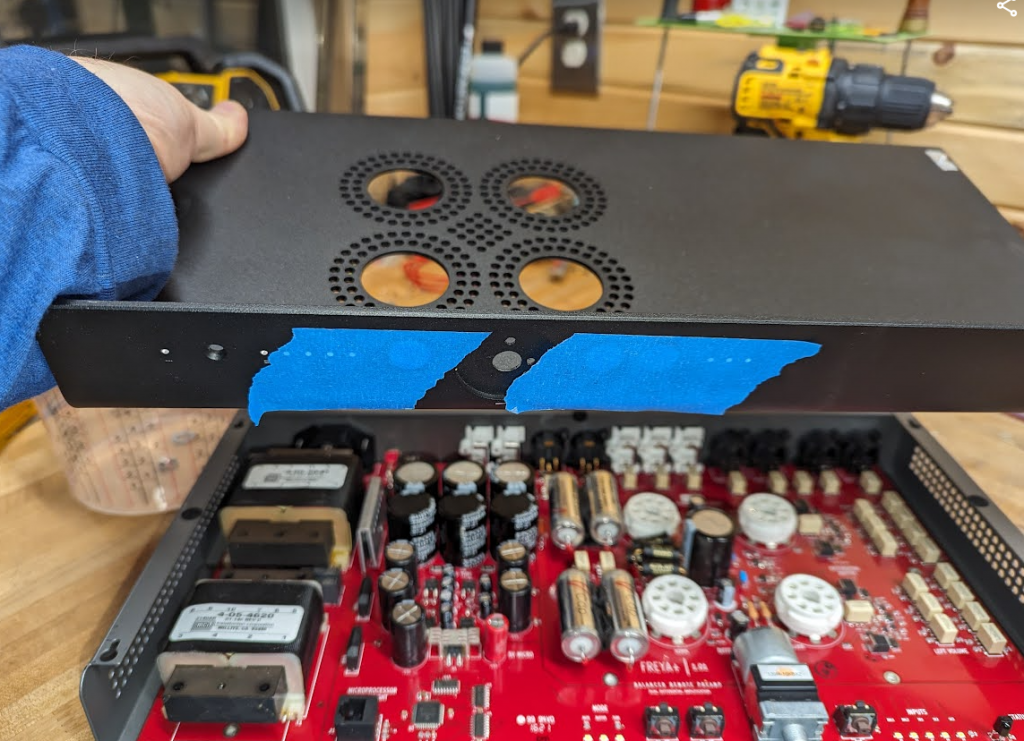

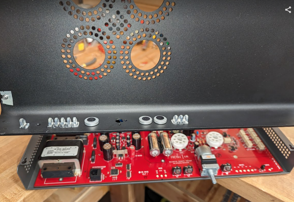

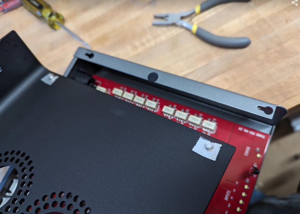

Step 2 = Remove the top of the case.
To do this flip the pre-amp upside down so you are looking at the bottom and gently pry the front lip of the top/front cover forward. The top cover will slide forward about 1/4 inch. At this point the front push buttons will fall out, don't let them hit the floor and roll away. Now wiggle the top case a bit and it will lift in the back and slide the rest of the way forward over the volume pot stem.
Presb4
  • Posts: 159
« Reply #23 on: 14 Jan 2024, 03:00 am »

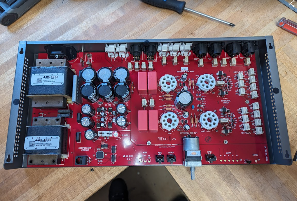

And here we are, looking at  the internals of a bone stock Freya +.

Step 3 = Remove the PCB from the bottom case.
But before you do this a word of warning....
Caps can have very high amounts of DC voltage still stored in them. Take care to no touch them until you have verified they are discharged with a DVOM. Your Pre-amp will bleed off this voltage over time, so its best to totally unplug your pre-amp and have it sit for a few hours before you go messing with it or be ready to safely discharge the caps with a resistor across the caps. If you are not experienced in doing this, just don't do it. The caps in the Freya + can hold up to 300VDC.
I had unplugged mine the night before and the caps still had 5 VDC on them when I checked them with a DVOM.
Ok, warning out of the way.

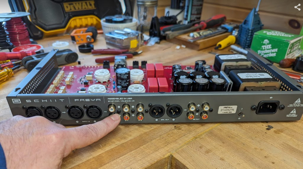

Now you need to remove all of the black screws from the back of the Inputs / Outputs and power socket.

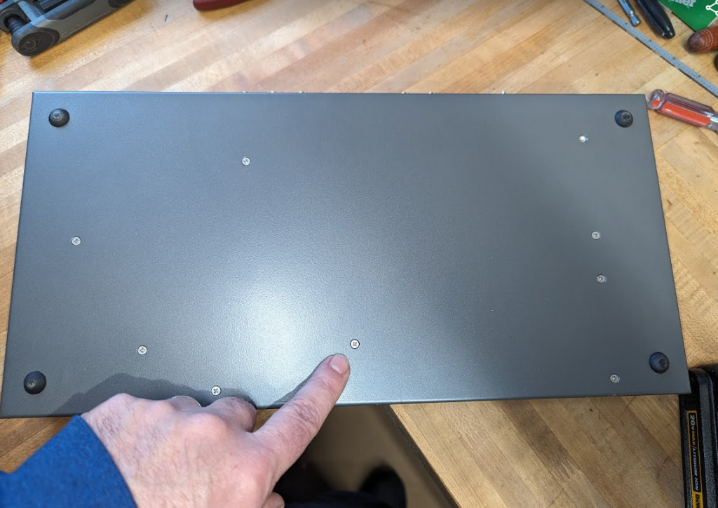

Then flip the pre-amp over and remove all the silver screws from the bottom. Support the PCB a bit with your hand on the last few screws as it will want to fall out of the casing after you remove the last screw.
« Last Edit: 14 Jan 2024, 05:40 am by Presb4 »

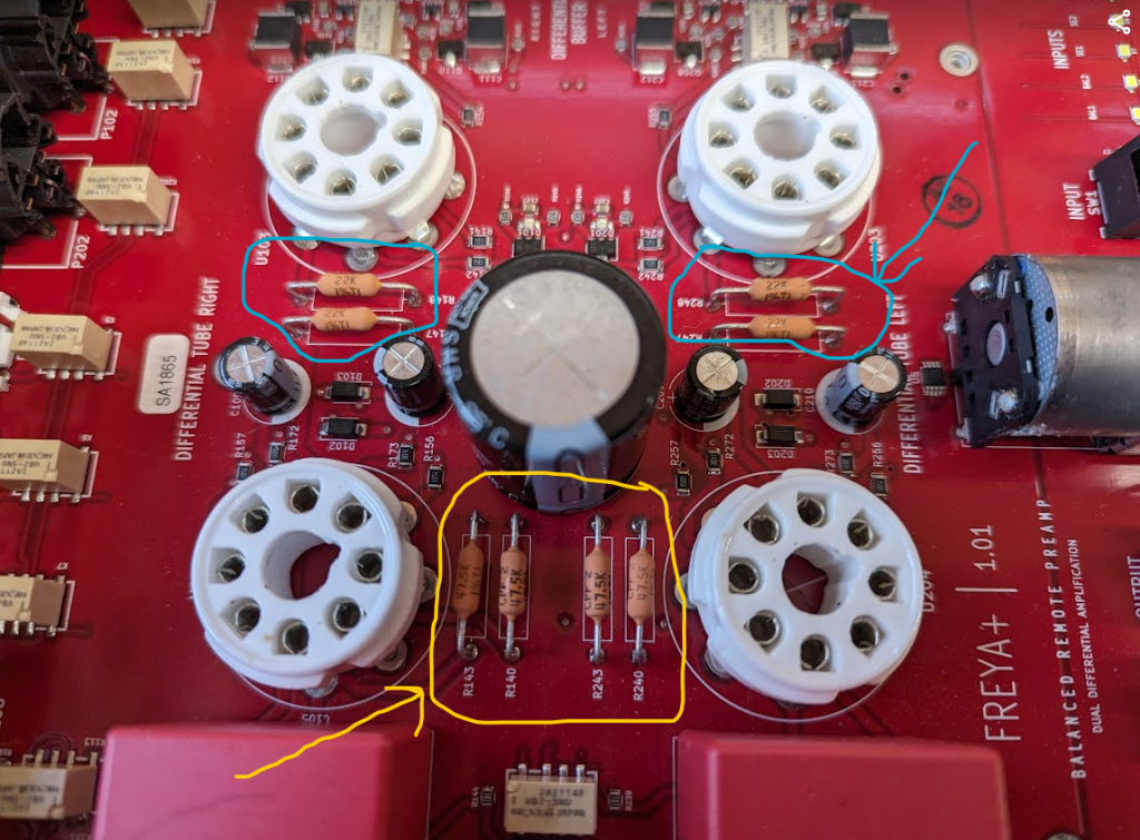

Ok, lets get this Mod going....

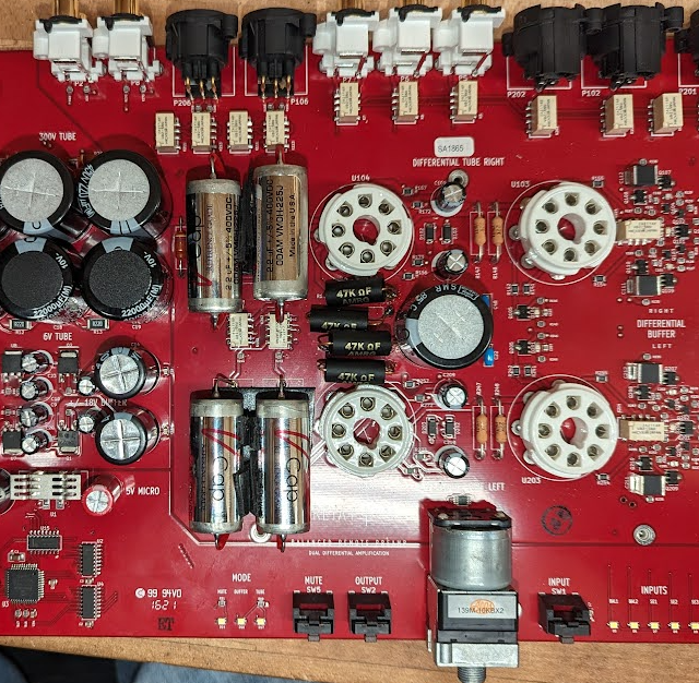

Here are the tube circuit resistors you can swap out. The ones marked in Yellow are the resistors between the voltage gain tube cathode pins and the coupling caps going to the cathode follower tube stage. They are 47K ohm 1 watt 1% resistors. The resistors marked in blue are the tube plate B+ dropping resistors. They are 22K ohm 1 watt resistors.
Until I had the PCB pulled I was not able to figure out the audio path, so I had both resistors on hand. In the end I only swapped out the 47K ohm resistors marked in yellow as they are part of the audio path. No audio signal flows through the 22K ohm resistors, so no need in upgrading them in my opinion.
I replaced the resistors in yellow with Amtrans AMRG 47k ohm 2 watt 1% resistors.
I did not replace the 22K ohm tube B+ plate resistors.
Unless you have a lot of experience working soldered PCB's, I would not recommend replacing the tube circuit resistors, they were an absolute pain in the back side to get to.
« Last Edit: 14 Jan 2024, 05:36 am by Presb4 »
Presb4
  • Posts: 159
« Reply #26 on: 14 Jan 2024, 03:59 am »

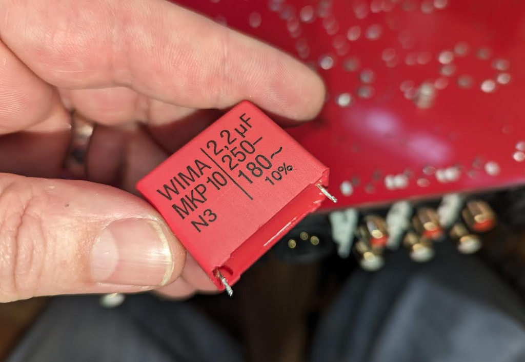

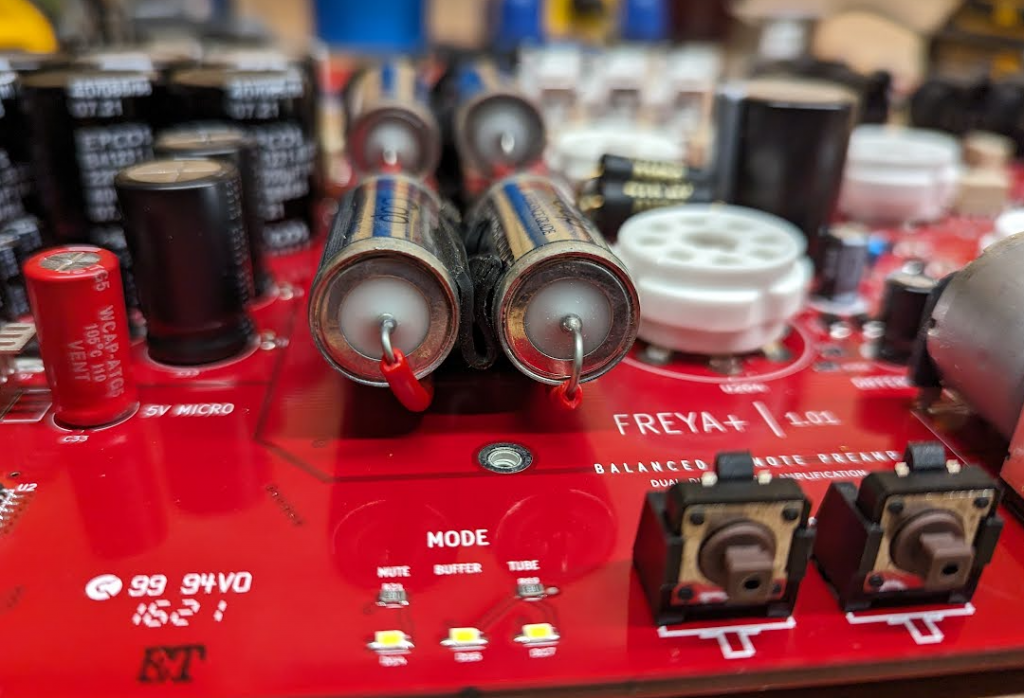

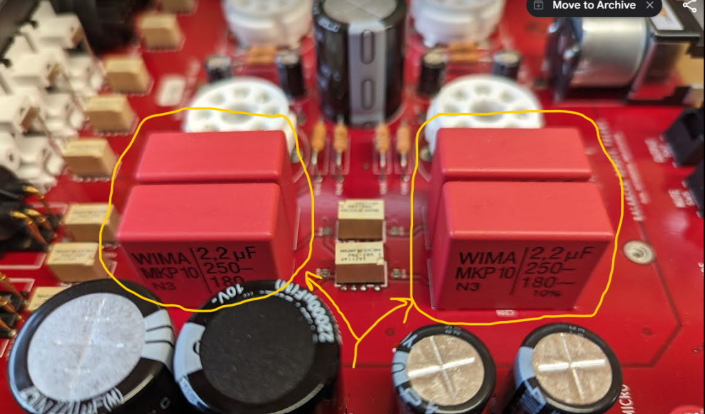

Here are the factory 2.2 uF coupling caps in the Freya+.
I replaced these with the V-cap ODAM 2.2 uF 400V caps.
Replacing the caps was fairly easy. There is plenty of room to work the old ones out and the new ones in.
Out with the old.
In with the new.
Yes, those resistors were a very tight fit, like I said painful to get them in, but I got them in but it does not look pretty.
« Last Edit: 14 Jan 2024, 05:35 am by Presb4 »
Presb4
  • Posts: 159
« Reply #27 on: 14 Jan 2024, 04:02 am »
Note... The V-Cap's have a metal housing that are part of the cap circuit. So you need to make sure the leads and any other components on the PCB or the case cannot come in contact with the Capacitors or they will short.  :nono:

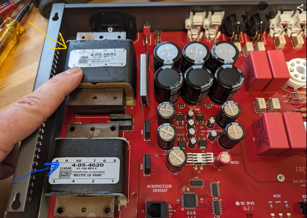

So that's the end of the Mod. I will save the drilling of the new vent holes over the transformers for another day. I am ready to get this guy connected back up to my system and see how it sounds. But before that, lets take a look around the stock Freya +.
The Freya + has 2 transformers. The one with the yellow arrow is the tube stage transformer, it supplies the 300VDC and the 6.3VDC to the tube stage. She runs hot!
The one marked with the blue arrow is the discrete power supply transformer for the all the other circuits in the Freya +. It runs warmish...
« Last Edit: 14 Jan 2024, 05:32 am by Presb4 »

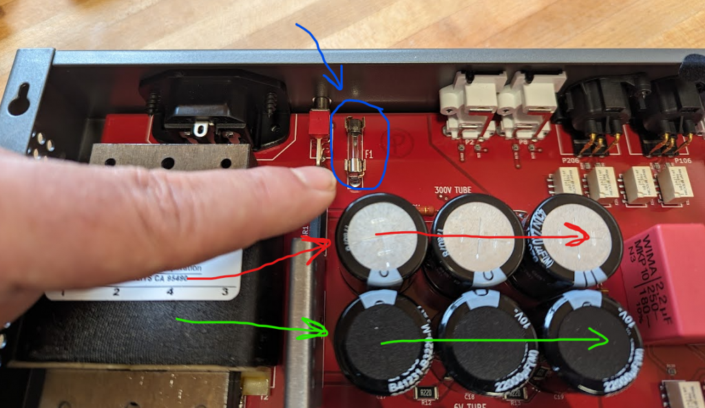

The mains fuse is located with the blue arrow. If your Freya + will not turn on, it might be because this fuse blew. Just pop it out and replace it.
The tube stage B+ 300VDC power stage smoothing caps are marked with the red arrow. They are all 450V rated.
The tube stage 6.3VDC power stage smoothing caps for the tube heater filaments are marked with the green arrow. This was one of the significant changes from the OG Freya to the Freya+. The OG Freya used 6.3VAC for the heaters, whereas the Freya+ uses 6.3VDC. The use of DC for the heaters reduces the noise floor significantly in a pre-amp.
