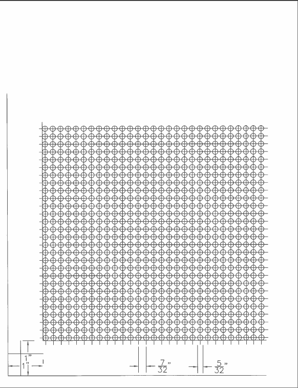

So in prep for the venting modification, I CAD'd up a simple template that mimics the hole pattern that Schiit uses on their products. I will add it below as an image that if printed on an 8.5"x11" sheet full size, it should scale correctly. I plan on using this and a center punch to locate the holes over the transformers before drilling.
