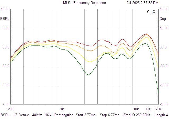

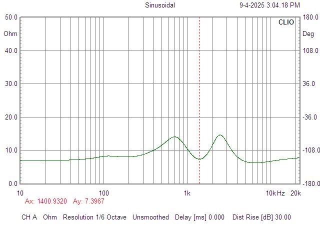

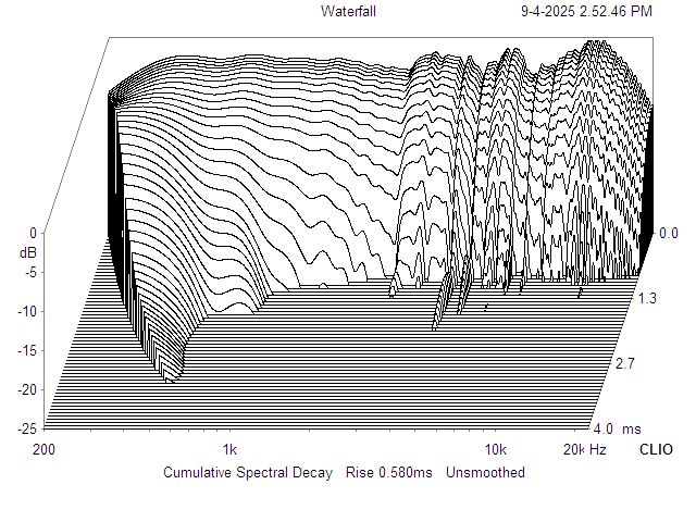

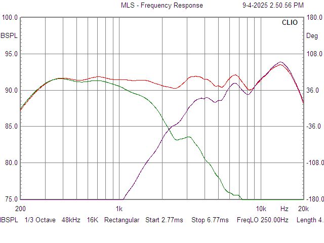

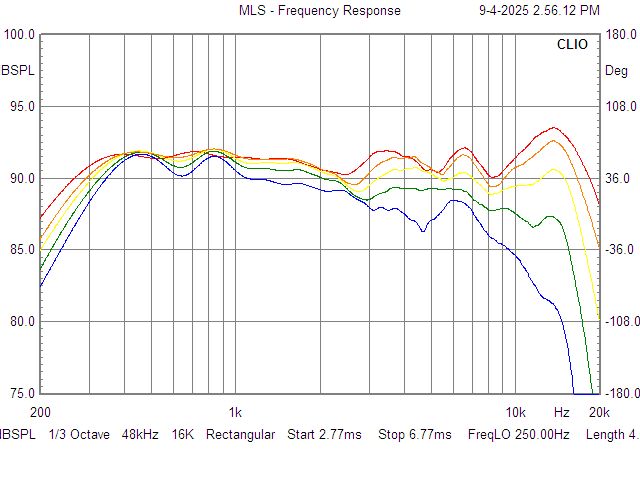

Here are Danny's measurements. Worked out really well with just a low order filter. Working on getting a prototype wedge stand that will have 4 M165 drivers. It's going to be tough to beat.

You can see in the frequency response and the waterfall how ridiculously good the LM10N is.

Having heard many BG/Radian 10 drivers, I think it’s important to give my 2 cents, and that is that as these drivers start playing lower, distortion goes up, particularly if only one is used. I would contend that, as Radian says a 500-5k range would provide max output, lowest distortion but ultimately that lower region needs to be augmented with an 8-10 inch driver before hitting the subs. This optimization can clearly be seen in Igor’s ( the gentleman who designed both BG/Radian 10’s) speaker as he uses a Radian3/10 to a 10 inch OB, followed by a 12 inch sealed where each driver is working its correct space. Even if you look at Danny’s charts above you can clearly see the 10 starts to fall off the table ~350, and I would also contend that there is a lot of mid-bass slam between 150-350, and I personally think that although the OB subs can play up too 200, that’s probably not optimal for a 12 inch driver. To go one step further, I completely understand that a lot of folks here like to use passive X-overs, and that adding another driver into the mix can get quite expensive so I completely get why folks like the simplicity of a small, 2 driver solution.

Yes, these drop off fast at 200hz and just having 12in OB servo subs doesn’t really cut it. Adding 4 passive M165 woofers is the way to go. I doubt even the 8in servos will be able to match the speed and clarity of the passive woofers. I will say without a doubt these surpass the NX-Oticas midrange and up by a good margin having both of them. It sounds so realistic it’s hard to distinguish the recording from someone actually singing in front of me and that’s just based on having them on top of the Double Troubles. I already have a good idea of what it’s going to be like configured like the NX-Oticas with the 4 woofers and I can’t wait to experience it.
