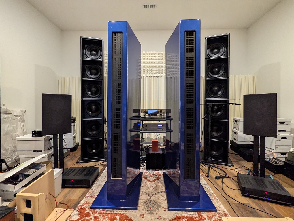

For the Line Force, the Radian LM10n would be a better replacement than the GRS NEO10.  I did not have good luck in testing the GRS NEO10 driver in the Super Mini style open baffle.
On the other hand, the 6xLM10n's in an open baffle line array using a dspNexus 2/8 as the DSP crossover and speaker voicing worked extremely well!
The two 6x12's are the modular 1x12's from captainhemo with SW-12-16FR drivers and 4xHX300OB12 servo amps.
