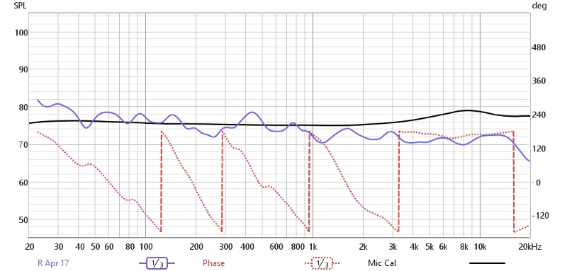

I’ve spent some time measuring and tuning the active crossover of the Nexus 2/8. I settled on setting a low pass of 100hz for the OB subs to meet with the M165 woofers. This makes for a nice in room response. Had to PEQ the subs at about 30hz to lower a big room peak. This system sounds unbelievable right now. Here is the in room response of the right channel at 1/3 smoothing from the listening position.

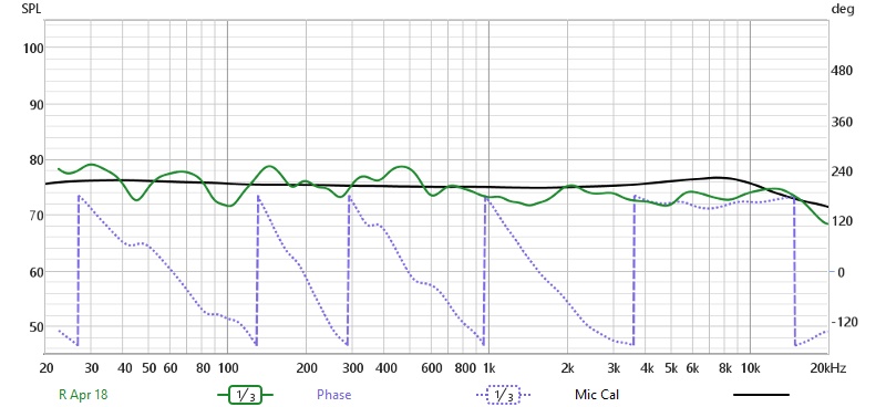

Flattened the slope a bit.

That’s actually a really good room response.

Thanks, I have a lot of stuff in the room so reflections are greatly reduced. PS, this system is insane.
