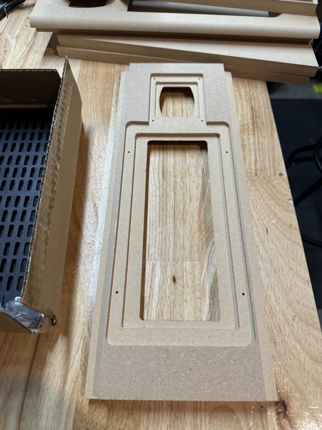

I managed to get some front baffles of the original Super Mini to put together using the new Radian LM10N midrange driver plus the GR Neo3. My plan is to send a built speaker to Danny with the drivers so he can measure and come up with a crossover. Below is a test fit of the Radian driver. The driver fits perfectly into the outer recess, however, because the frame of LM10 is flush compared to the old NEO10, the LM10 is set back 1/4 in from the tweeter. They will likely require a bit of crossover tweaking.

I'd guess that gap between the front of the driver and the back of the waveguide will cause more problems than can be fixed with a little tweaking. It looks like that would create a lot of reflections and turbulent air flow. You could use a pattern bit with a trim router to cut the recess deep enough that the face of the driver is flush to the back of the waveguide. The tricky part would be the section between the midrange and tweeter where there isn't anything for the guide bearing to follow. You need to fill in the gap with a straight piece that is the same thickness as the depth of the current recess. Double stick tape this piece into place.
I may try and use some weather stripping to fill in the gap.

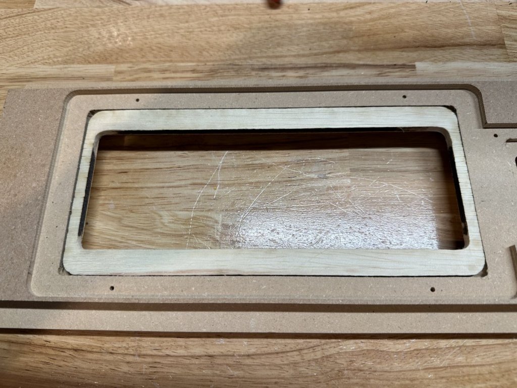

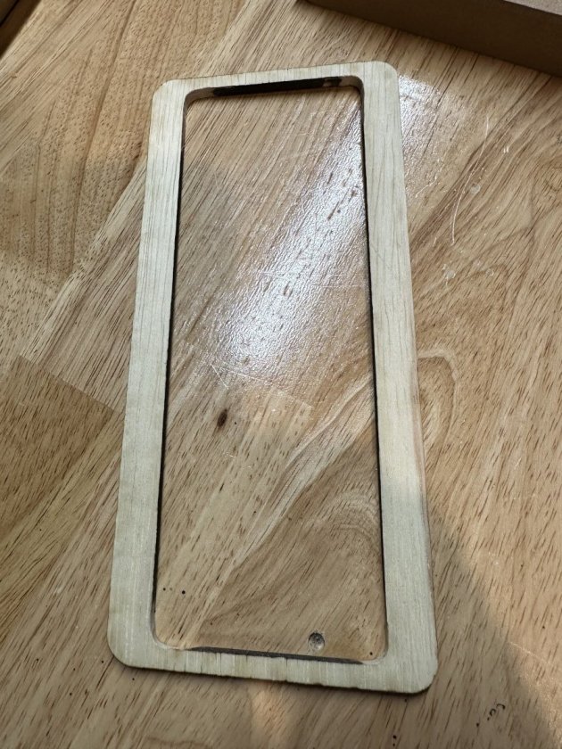

I had a revelation the other day that my coworker is into laser cutting. I asked if he could make a couple fill in pieces for me out of Baltic Birch ply and he said no problem. I sent him the measurements and had them the next day.

Very clever!  :thumb:

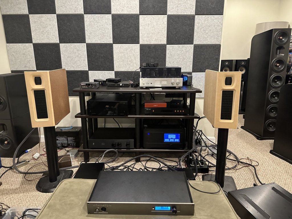

So after a year, I finally got these things going for initial testing. Currently running them full active using the DSPNexus 2/8. Man these speakers are unbelievably transparent. Now I need to get them on top of the OB subs and dialed in. I plan to send one to Danny once I get the cabinets painted.
Glad you have them up and running and the dspNexus is working well for you!
