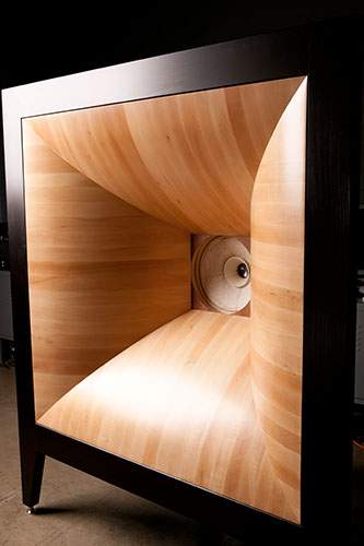

The Rullit field coil in solid wood horns can be heard at the upcoming Southwest Audio Fest in Dallas in March. Judge for yourself!
I haven't heard those particular field coil drivers yet but will look for them in the future. I'm just getting exposed to some lately but haven't had an ah-ha moment yet. Several people told me the Songer room at CAF was great but I didn't see it in a short day there. They are pricey though.
I haven't been a fan of full range drivers though I appreciate why some folks like them. I did hear some at CAF that caught my attention. The VK Music room was using AER full range drivers, horn loaded. Combined with their new 45 amplifier, there was some magic in the room. Great top end extension and of course great midrange. Requires subwoofer use in the arrangement they showed.
