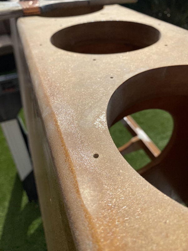

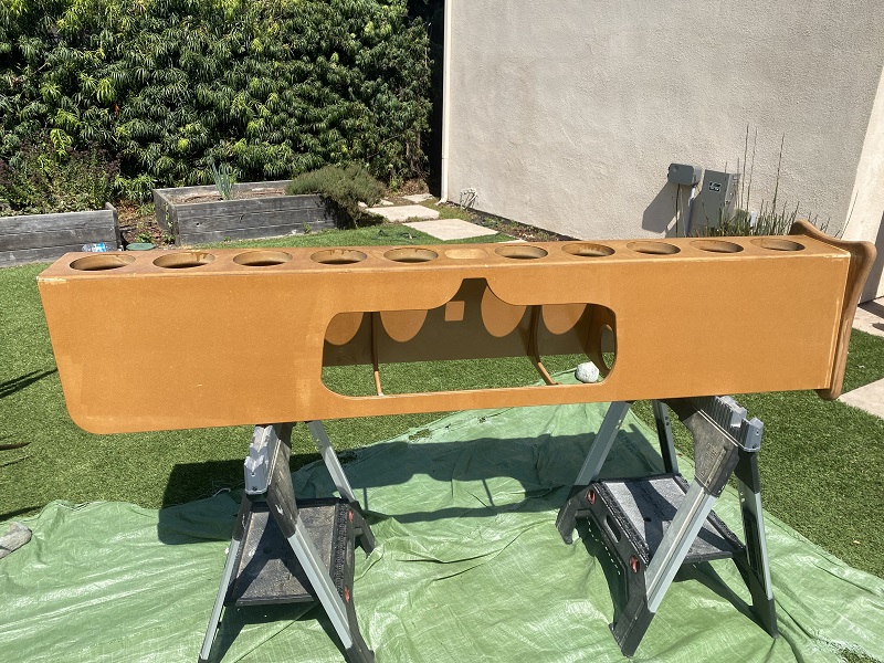

Epoxy sealer applied to NX-Treme.  Sanding the interiors of these with all the bracing is going to be time consuming to say the least.

I got a little swelling along the edges where I applied the System Three penetrating epoxy.  No problem on the first speaker, however, on the second one I applied another coat while is was still wet.  The edges really soak it up fast.  I had no idea that swelling was a possibility.  In any case I have started block sanding to level things out and will need to pay special attention to regain the radius of the bull nose.
