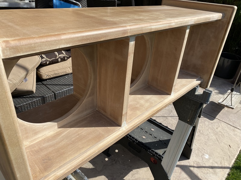

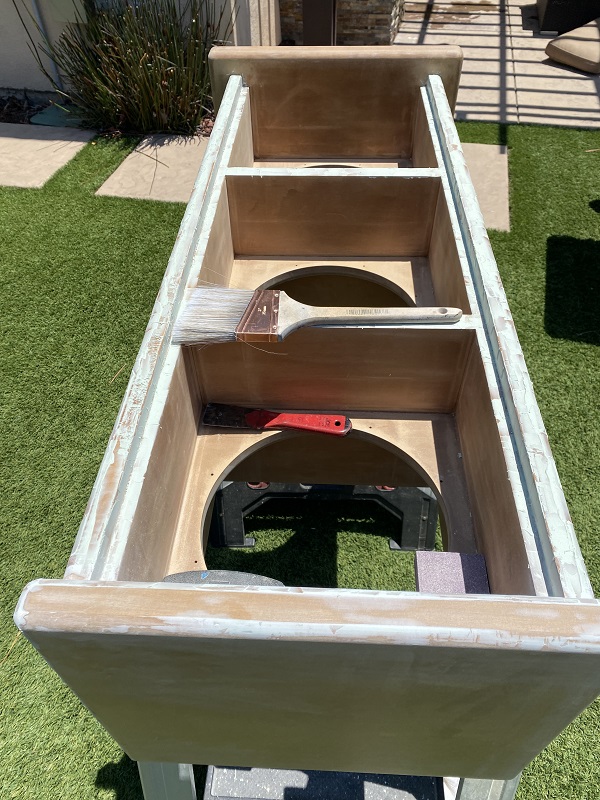

Progress has been slow.  I started out going through the complete surface prep process on the amp boxes to get a handle on things.  Now I am working on the Triple Threats.
Penetrating epoxy applied:
Sanding, sanding and more sanding:
Big shout out to Lloyd for his invaluable insights!!!

Another progress photo.  Glazing putty applied on MDF edges.
