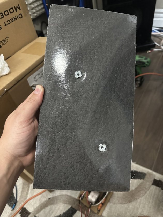

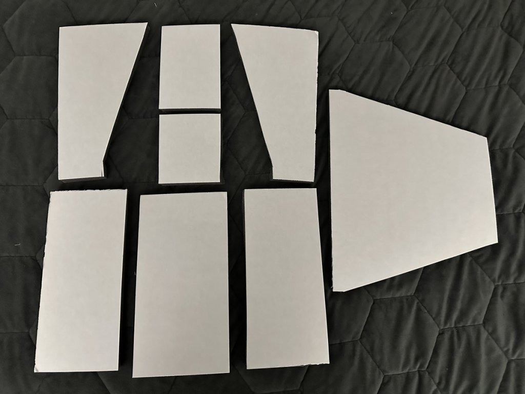

The No Res that comes with the NX-Studios is the perfect amount to do all of it and the top slope (inside and out) - I haven't cut the top slope yet because waiting to set up my table saw for clean cuts.  The cuts here were done with a razor blade and scissors where possible, since its not going to be seen I wasn't too worried about clean foam cuts.

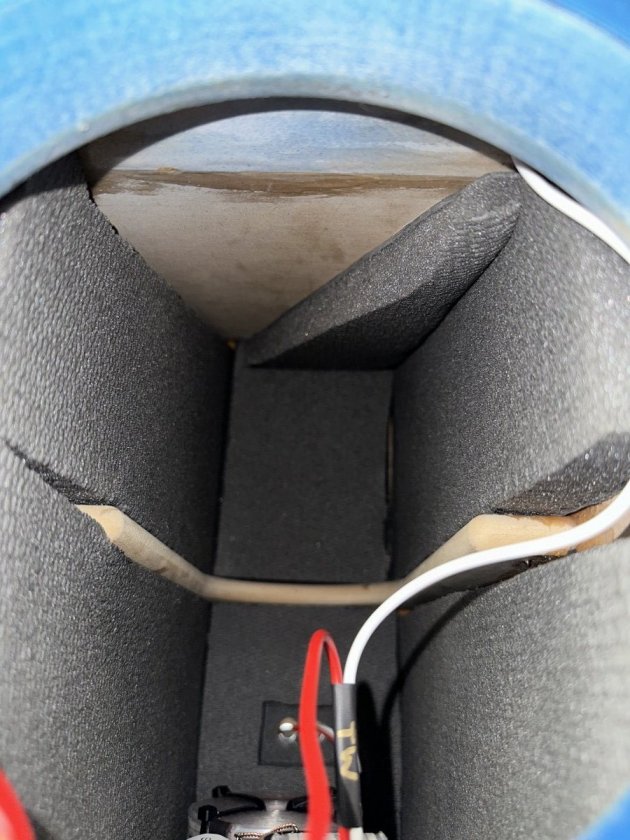

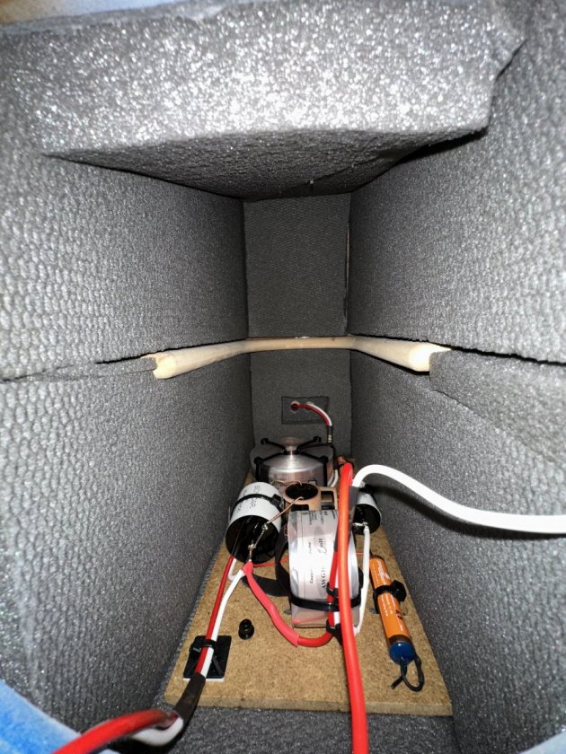

Something I had been thinking about for a while was a good solution for mounting the crossovers to the base of the Studios - I used inserts in the bottom of the no-res and m4 bolts
No-Res installed (this stuff is extremely sticky - need to really plan positioning before committing otherwise you'll be using elbow grease to unstick it and reposition (as I did more than once)

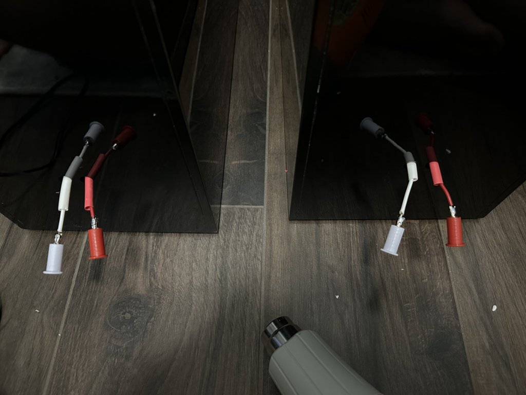

Crimp and solder - I ended up having to heat up the tube connector plug a little bit because the paint had filled in the holes alittle and having a tiny bit of flex in the plastic did the trick.
Used a right angle screw driver from harbor freight to get the bottom screws - this was probably one of the hardest things in the entire project lol.
Adding fiberglass insulation and drivers to Studios
Ultimately, I'm very pleased with how they came out.

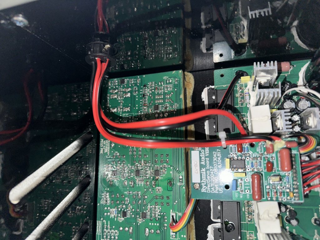

Update on the subs:
The GR-Research Open Baffle Rythmiks are wired and singing. Took me a few minutes to dial them in for my LP. Ended up with 80/24, 14hz high damped, phase at 160, 80hz crossover and they are blending well.  First time hearing open baffle subs and for only 370 watt amps I’m astounded. The speed of the bass is addicting, just want to keep hearing more of what they can do. Took this quick clip which recorded pretty well. Now I realize I’ve been using 1/18th of the power of the G25HP’s. Dialing them all in is going to be fun. Still need to solder them up but for now running 2 strands of GR solid core between woofers and original amp lead wire for power, and single GR solid core for servo. I was able to keep the length of the power lead stock from the amp but the servo lead wasn’t long enough and had to add about 12 inches or so which is why I ended up using solid core for servo. I’m not in love with how the cable comes off the back of the sub due to my configuration but it won’t be seen and eventually I may decide to mount a female Speakon somewhere and use a bridge cable which was my original plan, then decided I wanted to keep length a short as possible.
