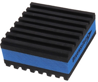

WGH
Re: Adding REL subwoofer to 2B—LP
« Reply #6 on: 13 Dec 2023, 02:22 am »
Curve overall looked great which is not surprising since really near field. The only real problem was a 60hz bump.
Adjusted REL in all parameters and then realized bump coming from somewhere else.
Turned  sequentially sub/stereo/video-shut down room. 60 hz still present.. Go to garage gone.
Located source as audible hum coming from refrigerator which is adjacent to family room and stereo.
Room treatment will not fly with wife.
Any further thoughts?
Try the DiversiTech E.V.A. Anti-Vibration Pad before buying a new refridgerator
Around $1.00 each, available everywhere
https://www.audiocircle.com/index.php?topic=140958.msg1502596#msg1502596

« Reply #7 on: 13 Dec 2023, 04:27 am »
Very interesting response.
Not sure if hum is vibration or motor.
Will pull out refrig to clean and assess origin.
Will turn off to finalize origin.
The refrigerator should be on rollers (very small area) so will probably not be able to use these without metal plate.
Thanks for the information. Will buy them for stereo anyway!
