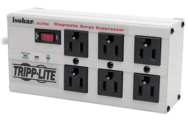

The noise becomes much stronger when I start using my projector.
This is an important clue.
I use a Tripp-Lite Isobar Ultra Surge Protector, the isolated filter banks really work.
https://tripplite.eaton.com/isobar-6-outlet-surge-protector-6-ft-cord-3300-joules-diagnostic-leds~ISOBAR6ULTRA
Isolated Filter Banks Provide Extra Protection
    Outlets arranged in 3 exclusive isolated filter banks to limit noise interaction among connected equipment
    Blocks disruptive EMI/RFI line noise up to 80 dB that can cause equipment damage or data loss
    Combine large toroidal chokes, ferrite rod-core inductors, HF/VHF capacitors and metal oxide varistors to block interference
