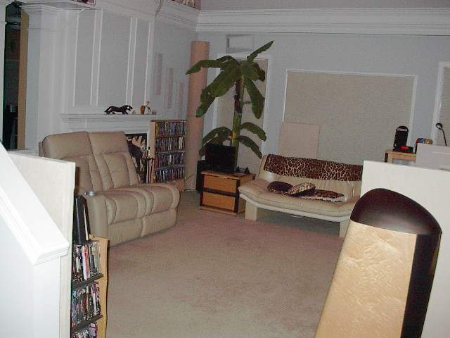

I don't have a fireplace in the current house.  In an old house (where I lived until late 1996), I had my speakers in front and on the sides of a fireplace and the entire wall was brick with a small mantle/shelf in the middle which was a little bit above the height of the speakers.  I used to take a comforter and put heavy objects on it so that the space behind the speakers (both the brick and the glass doors of the fireplace with built in heatilator were covered (and several inches of space were between the comforter and the wall).
In another old house (where I lived from mid 1997 to the end of 2013), I had a two sided (which went from the grand room to the morning room in the kitchen - pics below) gas fireplace on the opposite wall from the speakers and just left of my position.  The fireplace didn't see tons of use so I kept a canvas painting in from of the glass doors and the few times it saw use I just moved the painting.
